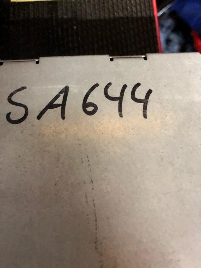

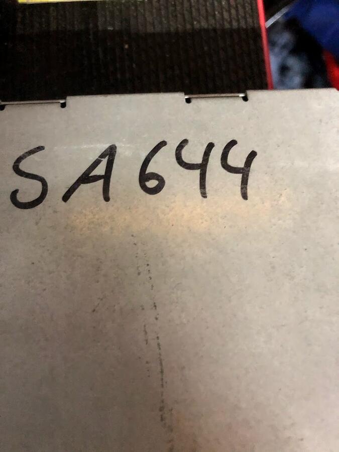

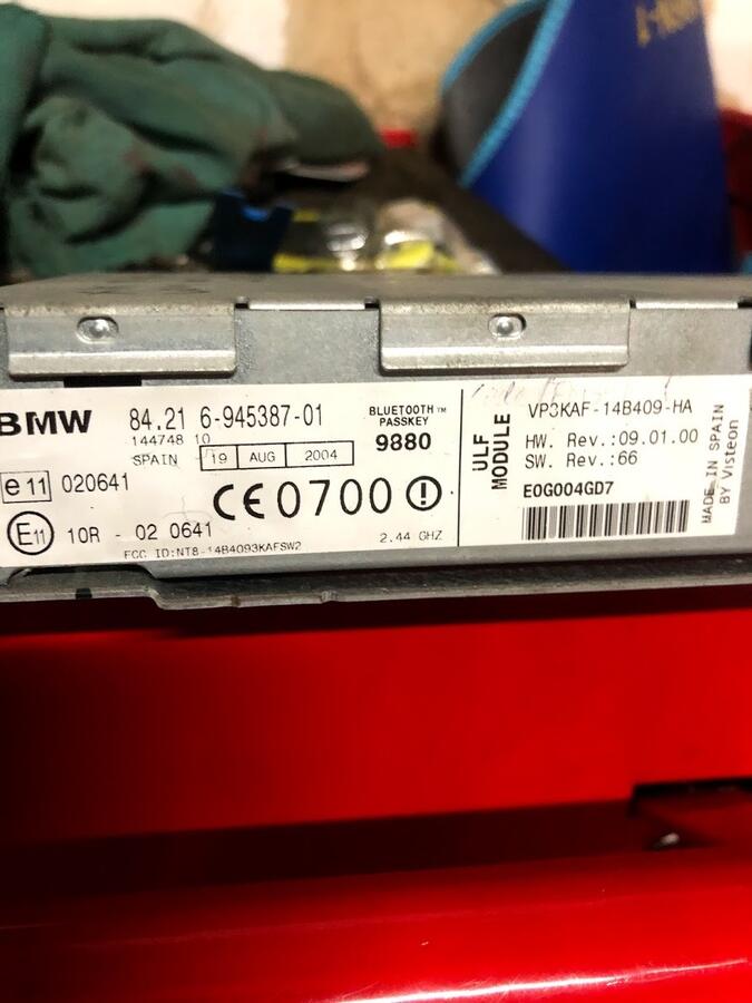

                  It's an M3 convertible. With Radio BMW Business (C43) (0661) • CD-Wechsler I-Bus Vorbereitung (0692) I retrofitted a CD54 Prof
                  I still have a ULF from another vehicle.
                  What is not quite clear to me, you need a ULF

                    You do not need the ULF.
                    What you need is to run 6 wires from the dashboard to the boot where your BlueBus will be placed. We will be populating the 6 pin socket on the BlueBus for the telephone functions:
                    • Pin 1 on BB --> Pin 4 on round pin radio connector X18126 (Tel. radio mute)
                    • Pin 2 on BB --> Black wire on microphone (Microphone negative)
                    • Pin 3 on BB --> Pin 3 on 10-pin CD changer connector at the back of the radio X13321 (Tel. audio negative)
                    • Pin 4 on BB --> Pin 10 on X18126 (Tel. ON)
                    • Pin 5 on BB --> White wire on mic (Microphone positive)
                    • Pin 6 on BB --> Pin 8 on X13321 (Tel. audio positive)
                    Now, if the car does not have a microphone (I assume it doesn't), get the steering column-mounted one, it's the one that makes for the easiest installation and gives you best sound reception on the convertible (84 31 6 937 391) along with the steering column upper trim piece with the hole to place the mic in (32 31 6 765 803).
                    You'll want to get this plug housing as a connector to plug into the microphone: 61 13 6 931 929.
                    If you don't have the special tool to crimp the wires into the pins, I recommend you get the pins that come with 10 cm of wire:
                    • 1x 61 13 5 A07 B73: Round pins for X18126 (you only need one since it comes with one pin at each end of the wire)
                    • 8x 61 13 0 005 197: Flat pins
                    • 2x 61 13 0 005 198: pin contacts
                    Plus you'll need to buy a few meters of 0.35 mm² wire. I got it from here: https://auprotec.com/fahrzeugleitung...abel-meterware
                    I think that's all. It's difficult to wrap your head around it on paper, so do not hesitate to ask questions!
                    P.S.: Nice headunit, that CD54... If only used prices hadn't gone completely mad...
