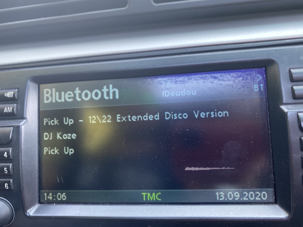

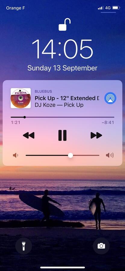

Hello Ted !
Since the new firmware 1.1.15, names of the songs which have some special caracters appears badly.
Here is an example, " is replaced by \22
I use an iPhone 11 Pro
Not an issue for me but just to let you know
Also, I've had the case of my right blinker didn't stop blinking, I had to manually go left and right with the blinkers command to stop it.
This, I don't know if it is specific with firmware 1.1.15.
Doudou
I have also had that issue, I found it happen if I suddenly changed indicator (eg from right to left) but couldn't accurately reproduce it or get logs thoughOriginally posted by Doudou View PostHello Ted !
The character issue has been resolved in the newest build and the blinker issue is being worked on for release 1.1.16Originally posted by Doudou View PostHello Ted !
