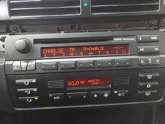

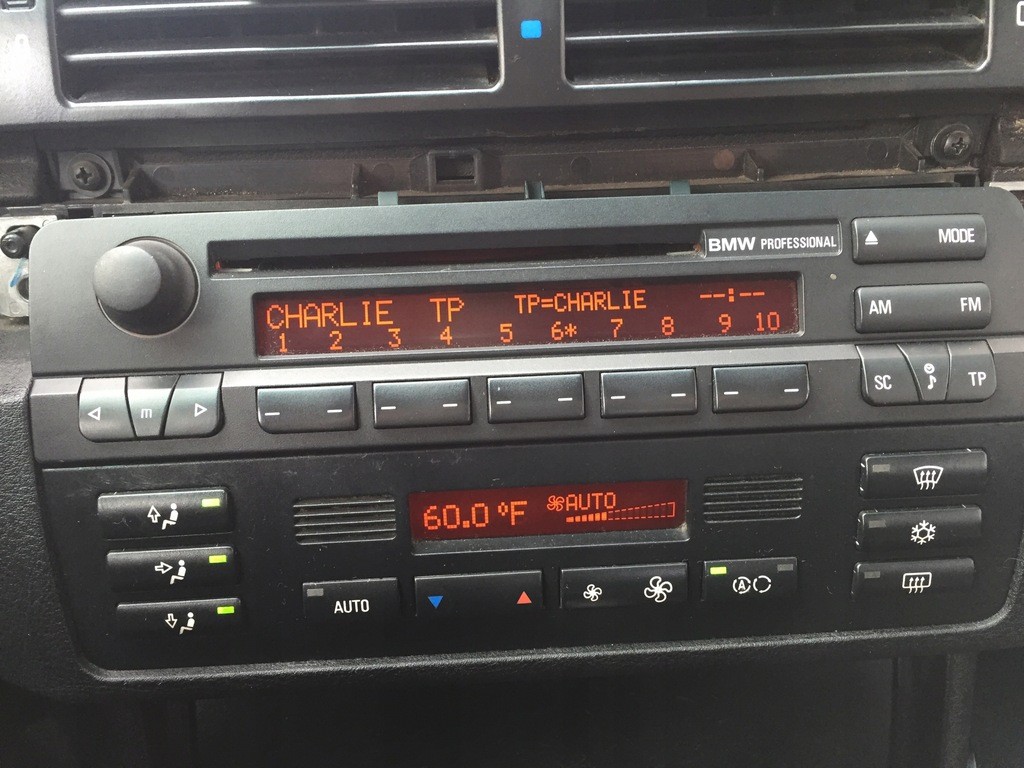

      Been searching first but no dice. Is anyone running BlueBus with an E46 Professional CD54 (BMW Pn: 65 12 6 924 732​) headunit? Was thinking of sourcing one for the better MID but they are pretty rare, especially in the US.

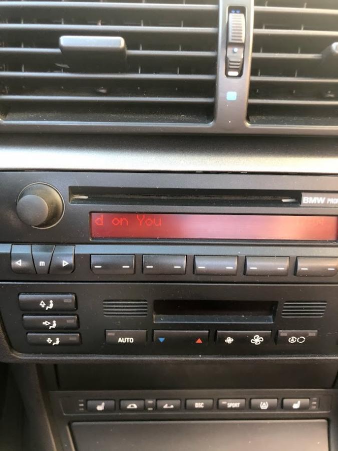

                  Hi, I have a CD54 on the Bluebus, but it doesn't work well. The controls are not stable and you have to press the buttons twice. I haven't gotten the phone right in 2 years. I would not do it. A simple dongle is better on the CD54...

                      Don't do it -- it's a downgrade. Even though there is more screen real estate, there are no additional """APIs""" for writing to the other portions of the screen. Instead, for consistency, they only allow 11 characters to be written to the screen at a time, just like the CD53.
                      Have you tried toggling R/T on the steering wheel to see if things improve? I think you'll find that they will.

                          Besides the screen not being an upgrade, I am curious, what else makes the CD54 a downgrade?

                              It's less straight forward to use because it adheres more closely to the "R/T" (Radio / Telephone) principle. It makes the UI more difficult to use sometimes.
