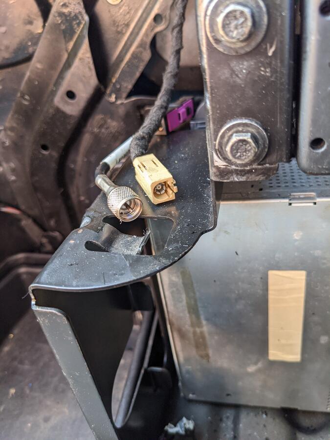

                        And just to be sure, those 2 cables are not the digital audio cable right?
                          Originally posted by maartenv View Post
                          Ok cool, I will try that, thanks!
                          Nope. The E46 never got the DSP Amplifier, so there will never be a digital audio input on an E46.
