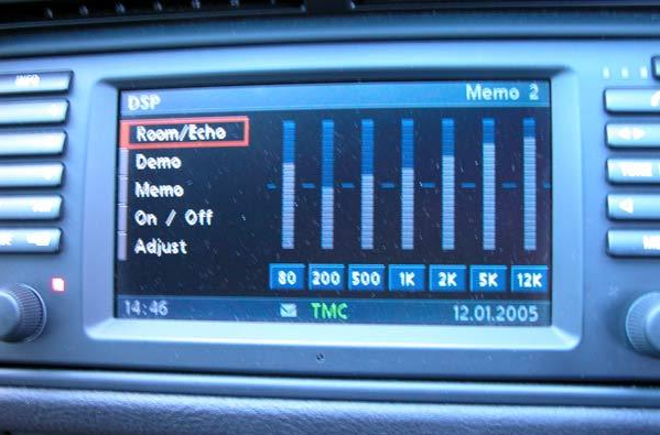

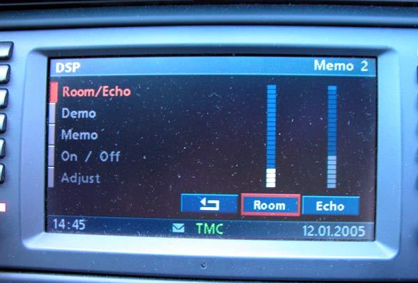

                    Hey Ted, while waiting for your module to arrive, overhauling the E46's audio system has become my latest passion project. Objective is to minimize the use of aftermarket components to allow maximum factory functionality. I've read through all of your github repository and posts across 8 different forums, to get myself up to speed with your project journey. I recently retrofitted the latest factory navigation equipment to match the setup in your M3 what's forthcoming in your Touring.
                    Based on your praise for the DSP system, I'm actively experimenting with retrofitting the "Top-HiFi" DSP Amp w/Coax from the E39/E38 to replace my U.S. spec (standard faire) Hifi 10-ch unit. Hours of Google queries demonstrates that this has been done by at least 3 others over time using a varied range of OEM and aftermarket components. Each solution enables the DSP option on the nav screen including the coveted DSP presets and custom multi-band EQ menus!

                    These are the menus I'm looking to activate:

                      Brian,
                      Your research skills are impeccable! My Touring received the gift of Navigation (along with H/K with BavSound speakers) recently, but I haven't buttoned it all back up to post about it
                      Anyways, I toyed with this idea and I think I have a better solution for you -- the E8x "DSP Amplifier" (Top HiFi) is a similar form factor to the E46s and it uses exactly the same harness connector, which should eliminate the need to re-wire the system, you just have to re-wire the connector.
