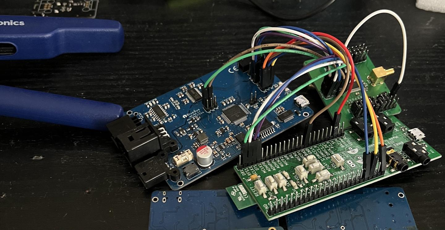

                        Uhhhhhhh, not so much! June is the target — towards the end of this month I’ll have prototypes of the newest hardware revision, in case you’re that itchy for one. As it stands, it works really well on my janky wired up version:
