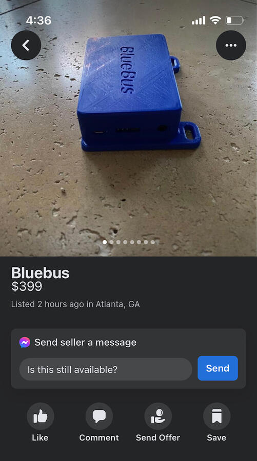

            FYI to everyone, but apparently some folks are trying to make a buck on the supply / demand issue with the BlueBus -- I am actively working on the hardware and software modifications required to spin up a new revision of the board -- Don't pay $400 for a BlueBus, especially as I am looking to lower the price to $199:
              Click image for larger version  Name:	image0 (3).jpeg Views:	15 Size:	57.1 KB ID:	139685
              -Ted
              Jeeez $400 is steep! Says a lot about you that you're warning us about this. Someone else would've hopped on the wagon and simply raised their price altogether...
                I think gouging that much is outrageous. There's another BlueBus on Facebook marketplace for $300, which is still very expensive but certainly outside the range of being a ripoff.
