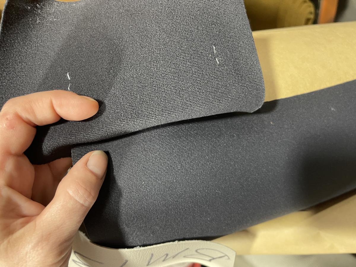

        Huge bummer the unbacked fabric, BM3109, is discontinued by VeteranCo. I called them to ask if they had any alternatives, or if peeling the backing off of BM314 was at all viable. They said peeling the backing off would ruin the fabric, but that they had an alternative that's pretty close: EOR911. I don't have their catalog, so I don't have a visual, but they're going to send me samples of BM314 and EOR911 so I can see how close they are.

          Please put up some photos of the two together at a couple of angles to see how well they compare. That's as much the problem as anything, getting the headliner and pillars matching (even when buying new A/B/C pillars).

            Cartopplus shared the below photo with me comparing BM134 and POR911 a few months ago, I haven't made a purchase on the material as I'm debating recovering them or purchasing new pillars to match the headliner I did with BM134
            Bottom is BM134, top is POR911

              That would be close enough for me from that photo.
                #67
                More than good enough for government work, would be nice to avoid the added difficulty of alcantara without the bm fabric available.

                  wow that is a lot closer than I was imagining it was going to be. I was going to go the BM134 route but on closer inspection the plastic mounting points are damaged on my current pieces so will be having to get new items anyway... If I didn't have to do that I'd certainly be giving the POR911 a go based on that photo!
                    #69
                    I just got done doing my headliner and pillars in POR911. Sorry for not getting back here earlier, but like the pic above shows, they're nearly indistinguishable. You could convince yourself they're different shades, but it's a stretch, and probably has more to do with holding the weaves at different angles. That combined with the fact that the headliner and pillars are on slightly different planes, I'd be surprised if anyone could tell they different in-car. The POR911 was also really nice to work with, very forgiving considering its thinness. It still has a light backing, but no foam.
