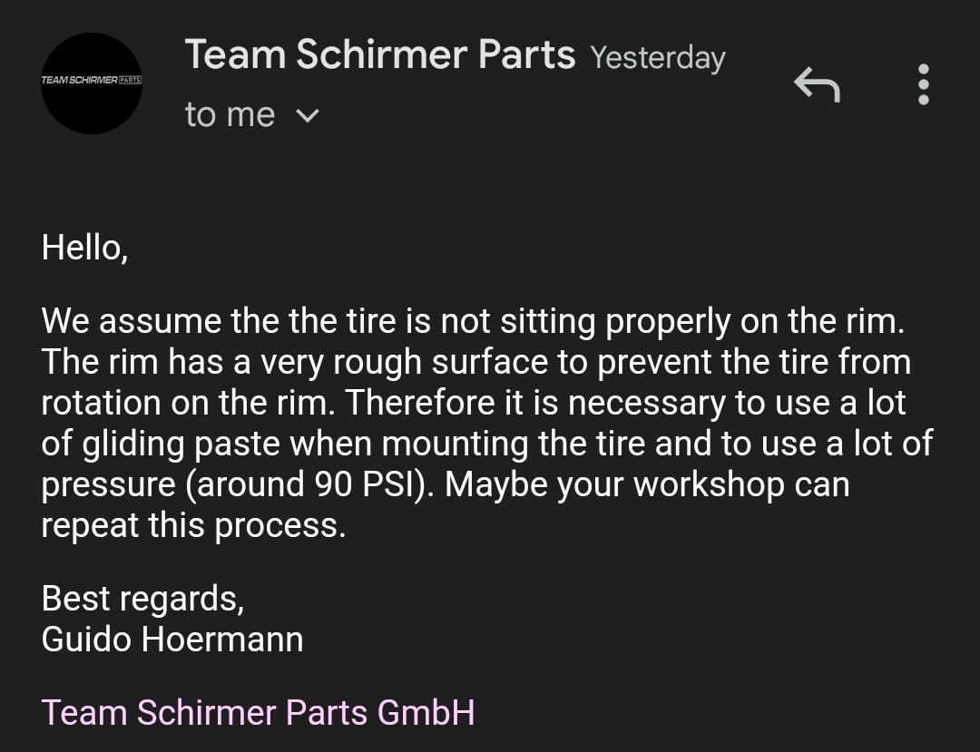

          I asked Shirmer what they would do in this situation and they said that the "anti-slip" texture on the lips of the E88s makes it difficult for the tire to seat completely sometimes. They said to fill the tire to 90psi to let it seat then bring it down to the desired PSI.

                        Yeah, 90 PSI definitely sounds scary but I would like to hope that Schirmer knows what they are talking about.
                          Click image for larger version  Name:	Screenshot_20211101-222836.jpg Views:	0 Size:	140.2 KB ID:	134931
                          Wasn't casting doubt - they definitely know their stuff and those E88s are likely STOUT wheels. But if I were to attempt that, I'd 1) reconfirm 9-0 isn't a typo and 2) use the longest [edit] air chuck [/edit] extension I could find 3) put something meaningful between me and it.
