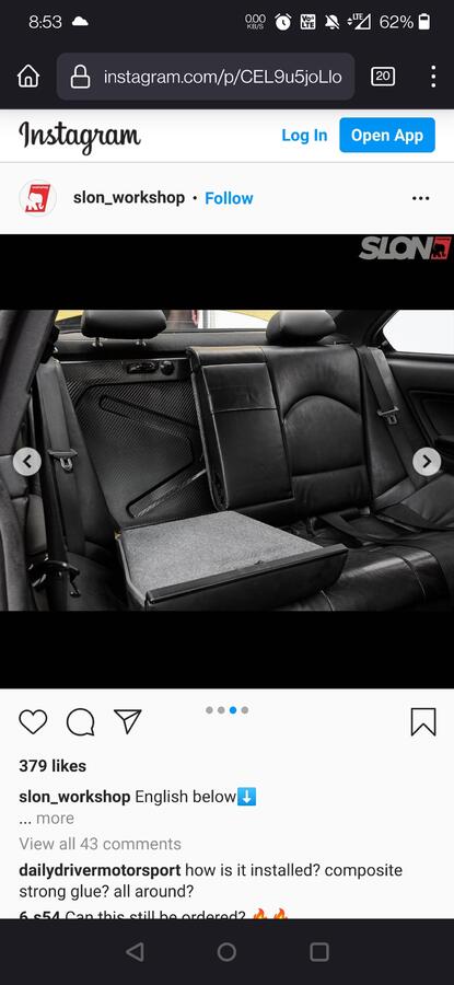

              Does i'm understand correct, that i need to write again, that wall compatible with oem rear seats?
                #37
                No need to write it again

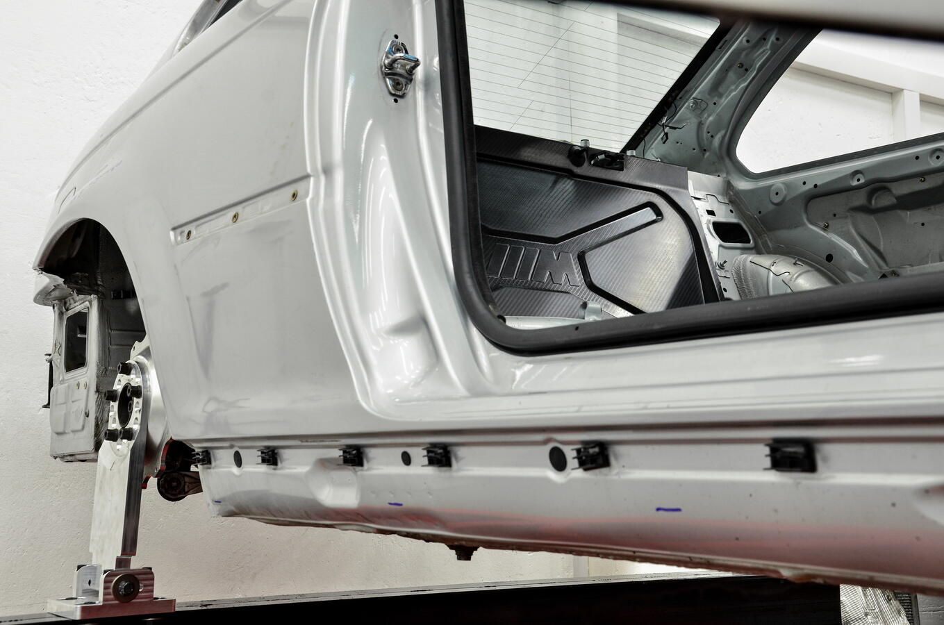

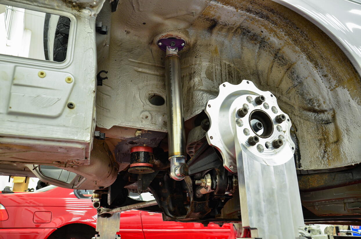

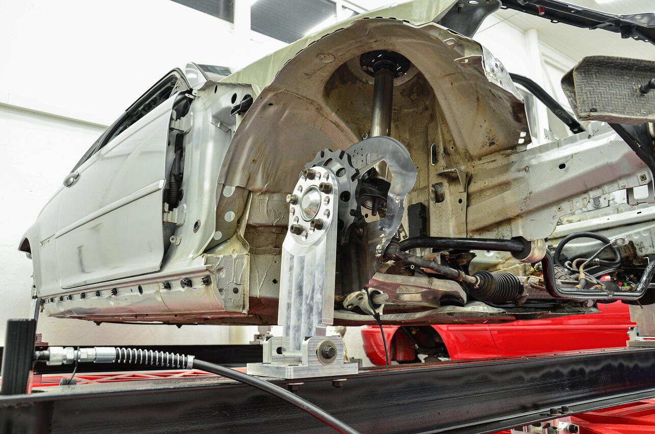

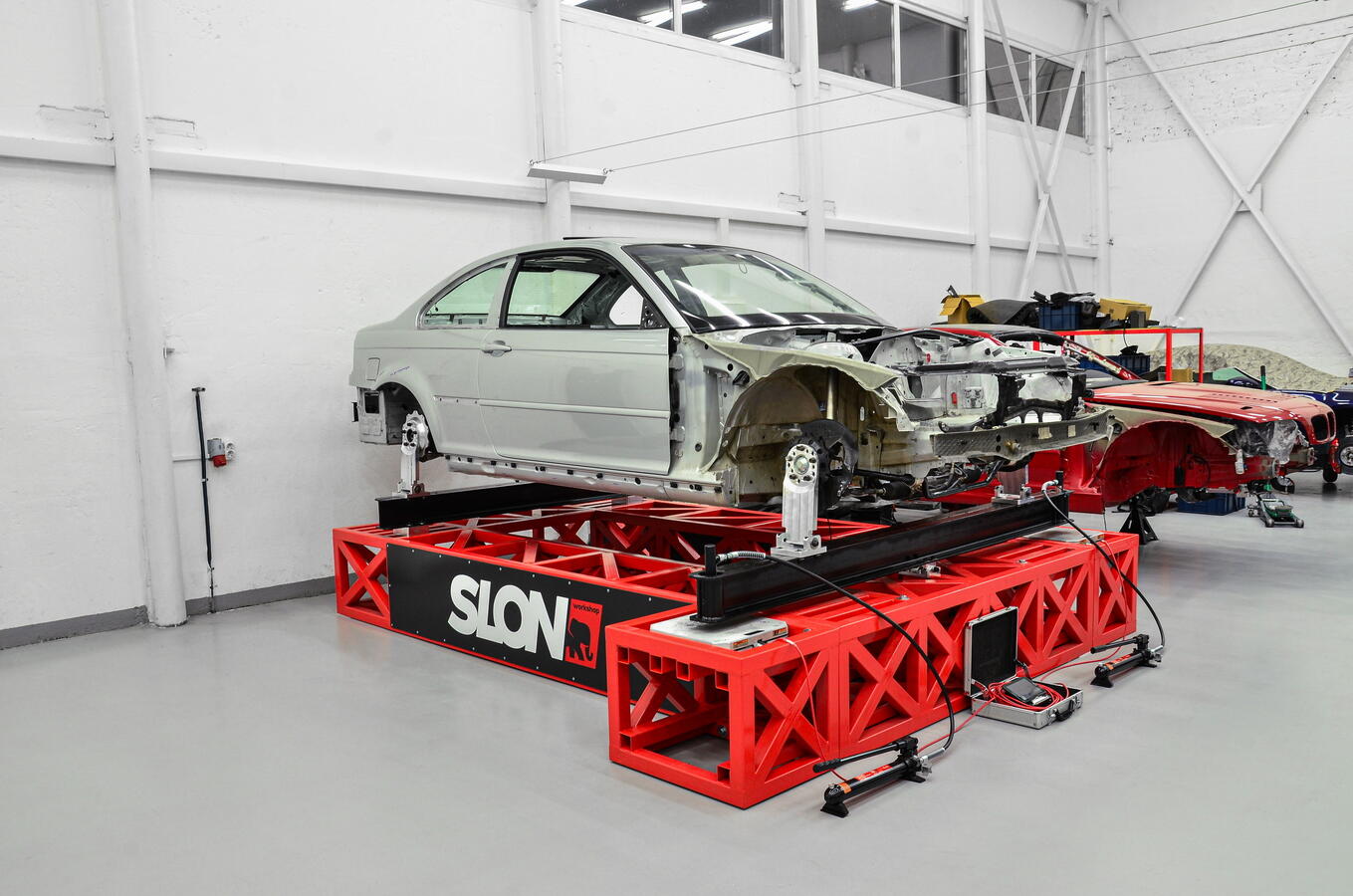

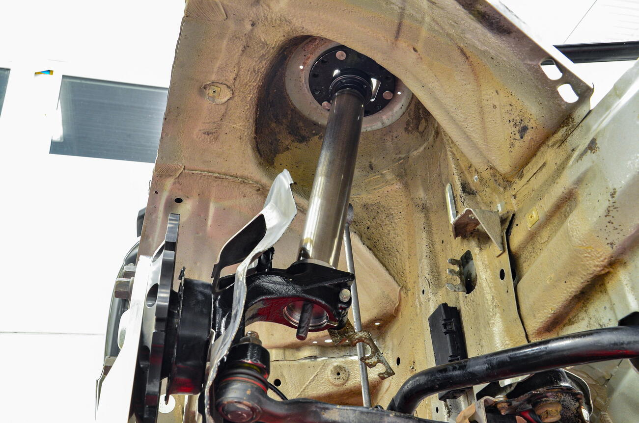

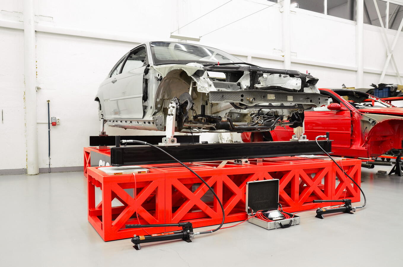

                              more pics:
ID:	136958 Click image for larger version
ID:	136951 Click image for larger version

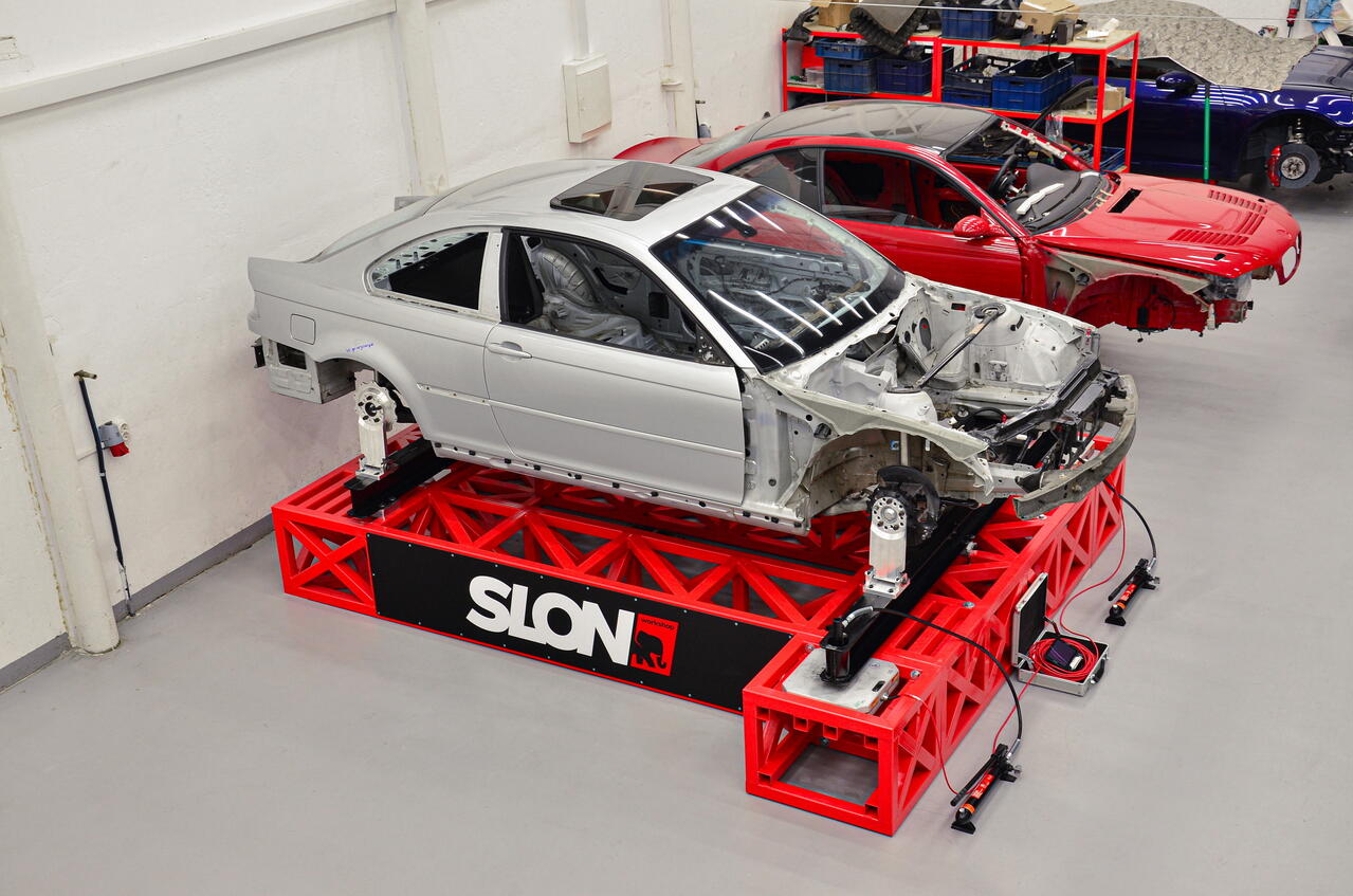

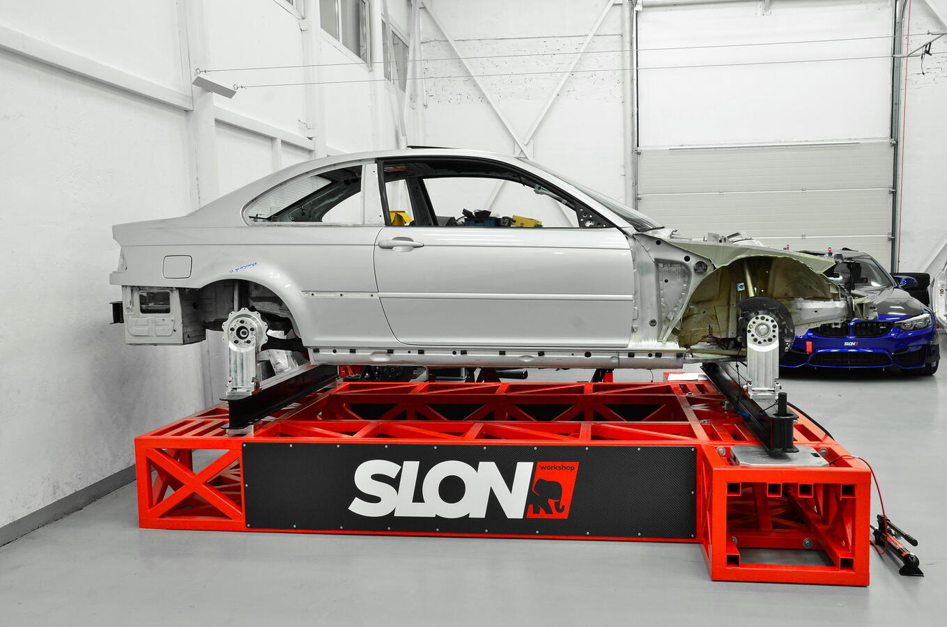

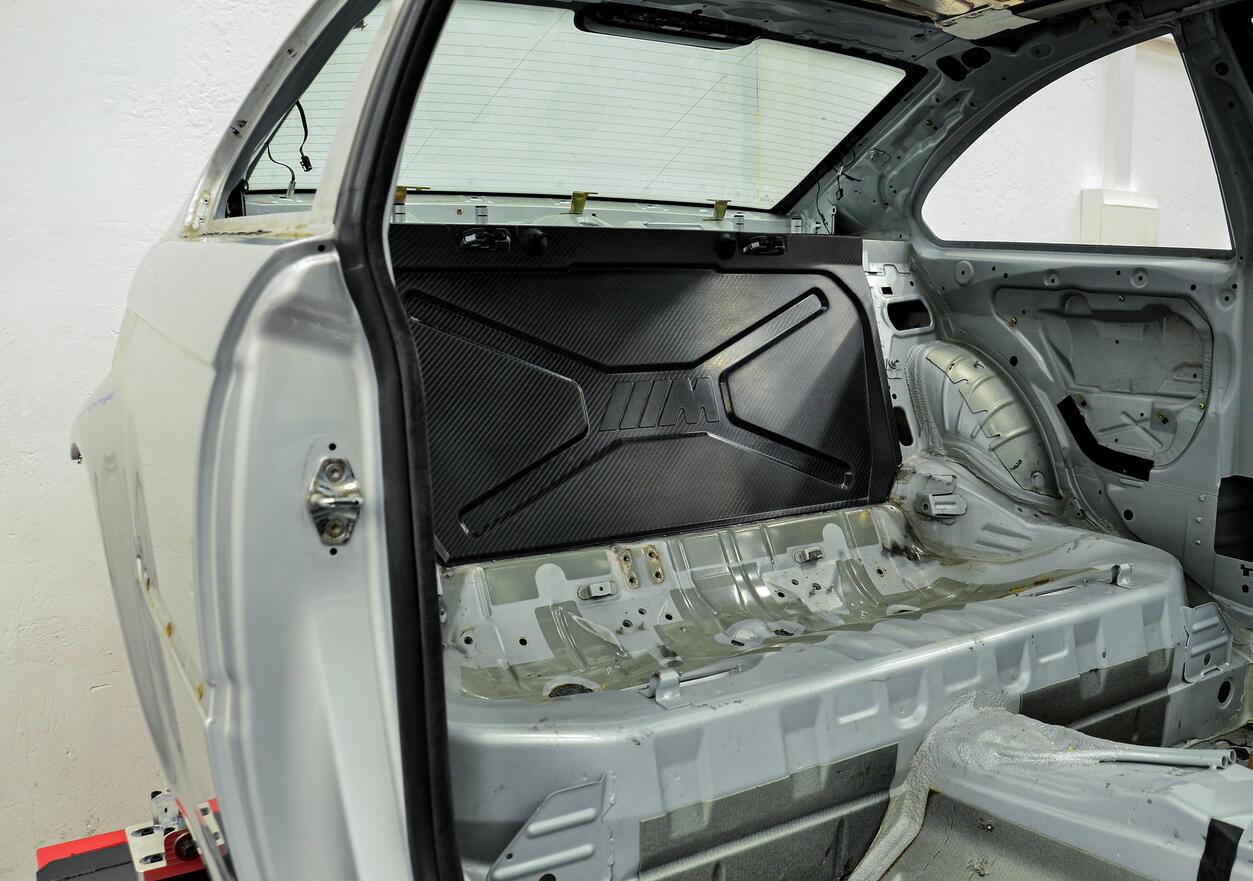

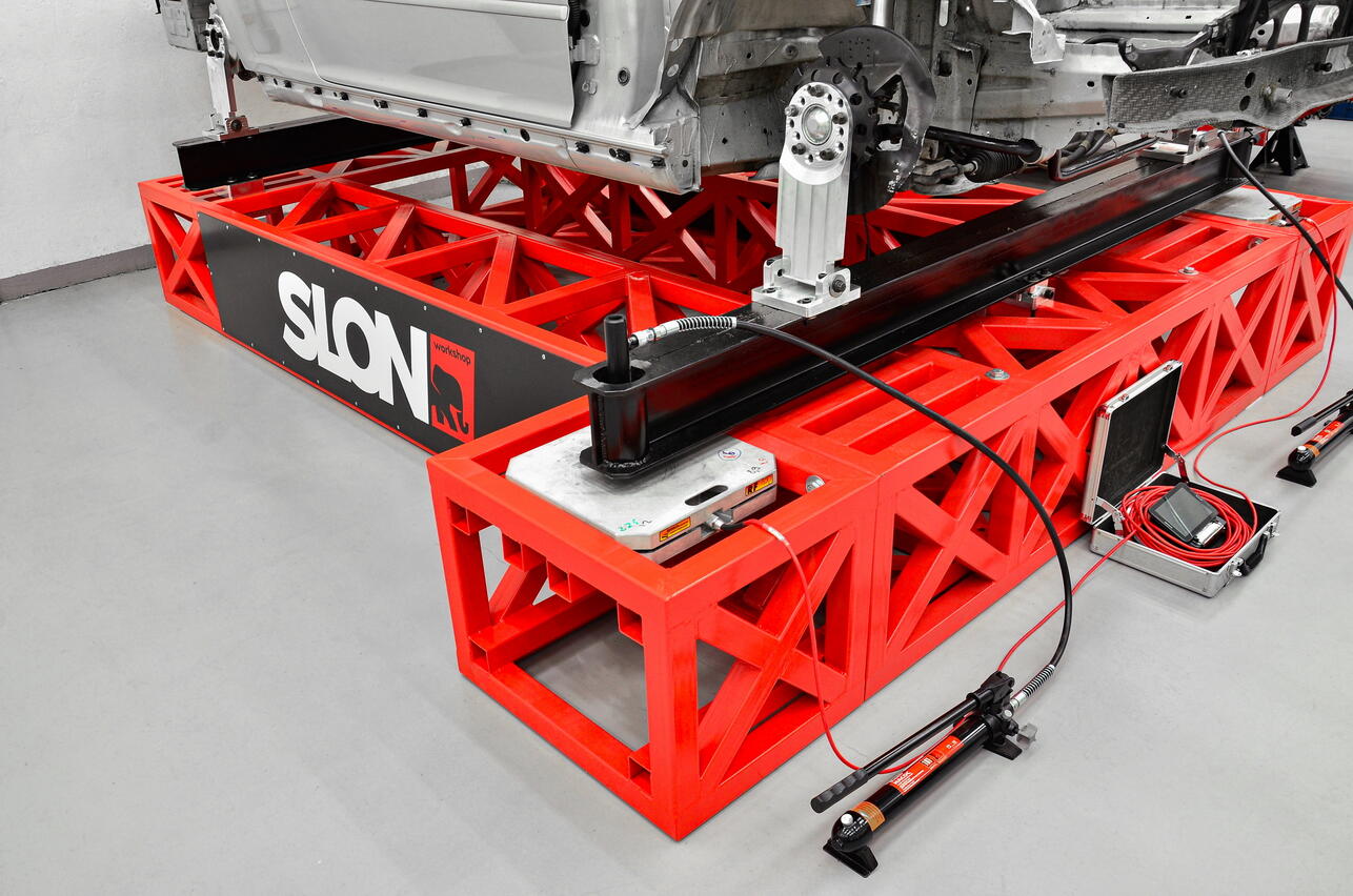

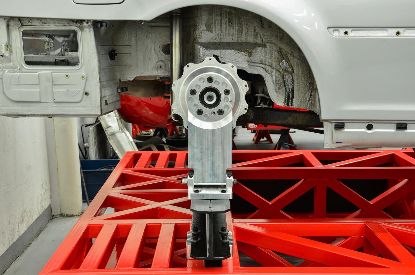

                              Carbon fiber wall on this silver chassis installed for the tests as raw, without any matte lacquer, right we get it from the mold.
                              So, retail walls finishing differs from the wall on this pics.
