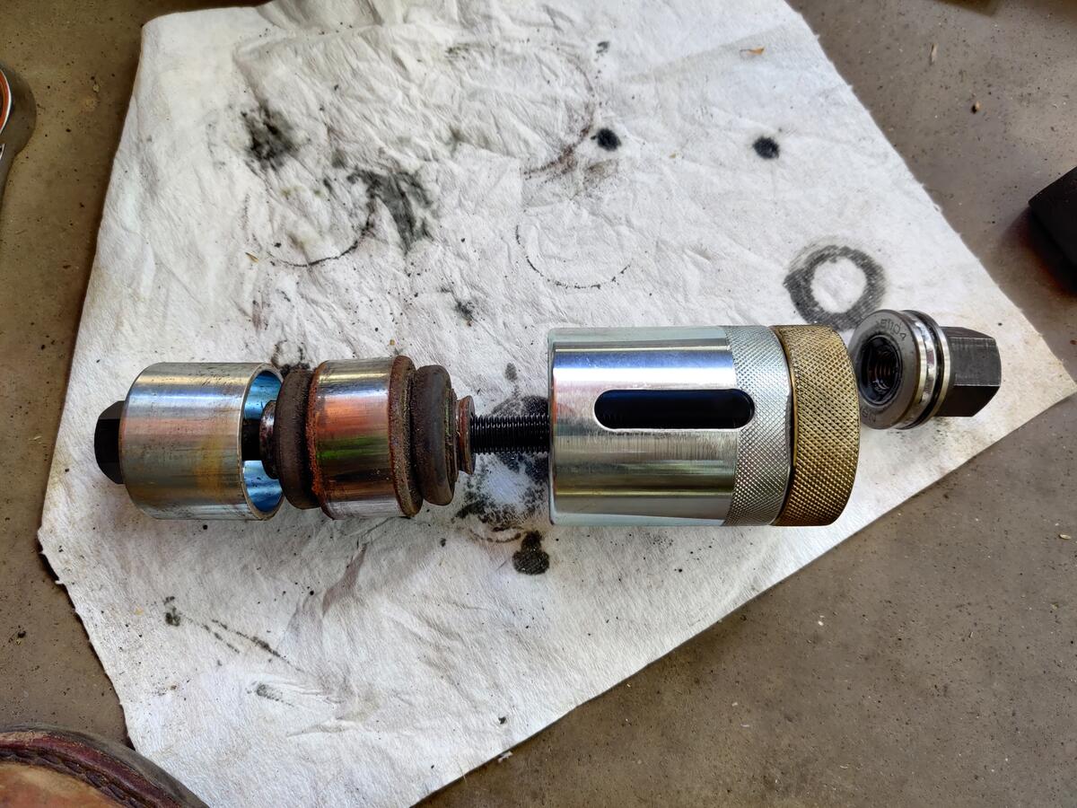

      +1 I used the same exact tool on mine, except it was branded as the Bavarian Autosports "Trailing Arm Bushing Tool - Master Set #B8800100". Worked like a champ. Bav Auto's "special" tools are often just white labeled, as far as I can tell.
      Also for those interested, here is the orientation I used to pull the ball joints.

        It is a decent kit.
        I used it for the same job, plus I used other cups in it to R nR the rtabs on my E30 M3.
