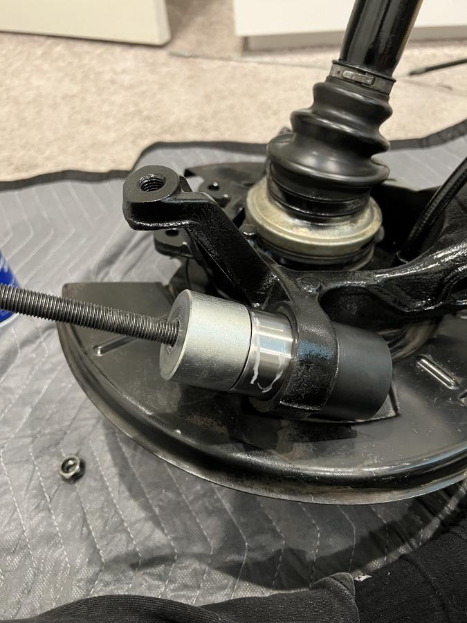

                        Hopefully can fold in the labor as a while you're in there job. They're quite easy to do with the right tools. Can see references to this bushing and more in my journal : Click image for larger version
