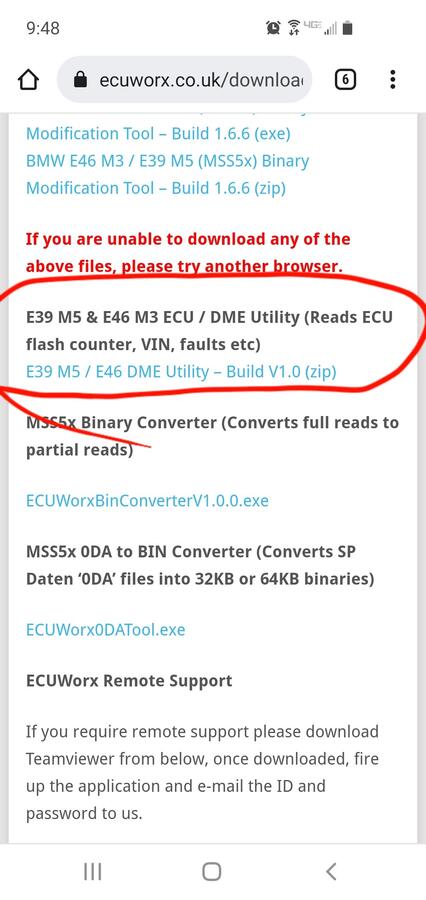

    Download this (free) tool and with a KDCAN cable you can see your cam adaptations among other items if that would be of any help.
    That could help shed some light on timing.
    //www.ecuworx.co.uk/downloads/
          Click image for larger version Name:	Screenshot_20211221-094857_Chrome.jpg Views:	0 Size:	52.4 KB ID:	144939
          I started the car and connected the ecuworx dme utility. not exactly sure what values I am looking for so I read adaptations, read and cleared faults and posted screens of what I saw. When I cleared the codes, 10 comes instantly, followed by 15 within 10 or so seconds, and then code 185 will come after a few minutes of idling.

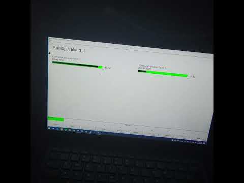

                        so i've just had something change. I warmed the car up for about 10-15 minutes in the garage to get to temp. over the warm up time I was inside the house, but heard it drop revs/misifire to the point of almost stalling twice, but it recovered. I got in the car, hooked up my computer and was gonna get read to vary revs up to about 6k, but the car stalled out without me even touching anything.I started it back up and revd out a few times. I checked the signal in inpa on cam sensor1 again (which was staying at 0, with no change with my old sensor, and with the new sensor installed) and I saw it fluctuating like crazy, in a way that I suspect is not normal, and I'm not quite sure what to make of this. i also noted that in the warmup time and rev range variation my adaptations were all still at 0 after, it must need to be actually driven or idled much longer to set them I guess?

                          I have made another observation. After the car cooled off a bit I decided to try the old sensor this this new one looked so wonky. installed the old sensor and it was still flatline zero. okay cool, reinstalled the new sensor again to observe the wonky readings...and it showed 0. I have no idea what is going on here.
                          Now, I think the sensor goes from flatline to all over the place after the 185 code gets triggered, and after revving it. Before I rev'd I cleared codes and saw 10 and 15 come back instantly, and the sensor was still showing 0 in INPA. I waited in the car for a little bit and felt a slight misfire but and it was at that time 185 came up and the sensor came to life with readings all over the place., and after revving the cars feels like it wants to stall out when it returns to idle. rev'd it about 3 or 4 times and it actually stalled out once when returning to idle. i will today or tomorrow put the old sensor BACK in and run the car for some time again and see if a misfire triggers code 185 and brings the sensor back to life.
