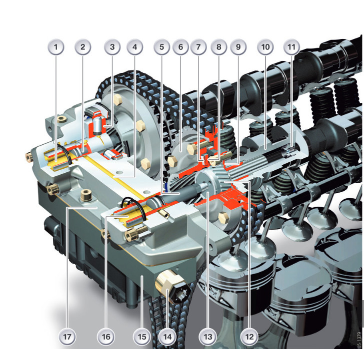

I was a bit confused with a similar problem I had. This wasn't the sensor. New camshafts were installed and they forgot to swap the valve inside the camshaft causing low pressure build up in low engine speeds. Part #11 in the attached picture.
The camshaft position was behaving exactly like yours. With TestO from Pheno you could log this position from DS2/Serial with a high logging frequency. At the car I had it would jump around only below <2000rpm.
Besides this the VANOS unit would likely need new seals as these could be worn and leak.
