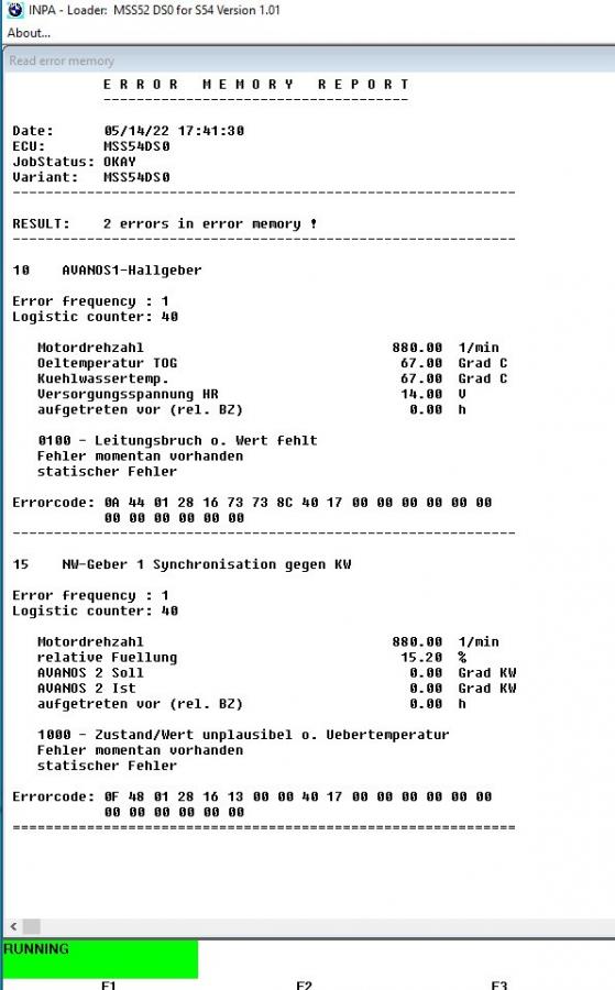

                okay so I have performed the test you suggested. I plugged inpa in, cleared my codes and then started the car. rechecked to confirm codes did not appear and there were still 0 codes. I then left he car running, got out and unplugged the exhaust cam sensor. I did not notice any audible change in the idle. I went to look at the cam signal in INPA and it appears the sensor signal just froze at the last known position. I scanned codes and code A and F both came up instantly with no CEL. Cleared them and they were instantly there again.
                So i suspect you are on to something. my exhaust cam sensor wiring may be the culprit?
                What I'm assuming has been happening is maybe there is a break somewhere in the wiring causing an intermittent connection, and when it triggers the codes A and F instantly from the cam sensor being disconnected, code B9 is soon to follow. But if the intermittent connection reconnects before the code B9 triggers, I can clear the codes and no codes reappear( as happened on my way home today after ~300km).
                Click image for larger version  Name:	Screenshot 2022-05-14 174206.jpg Views:	0 Size:	68.7 KB ID:	167804

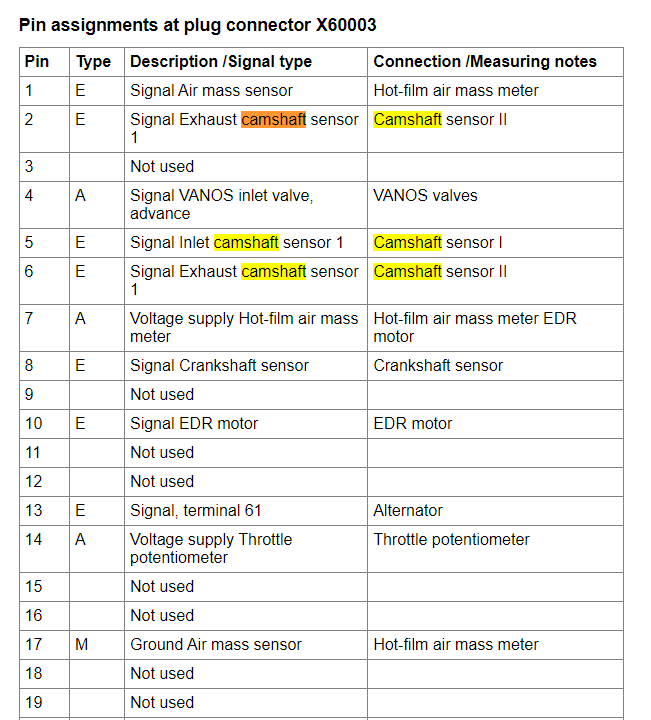

                          How would you reccomend I do this? I am looking at the 52 pin connector now but I'm not sure how I would bypass the existing wiring without cutting a length off the original wire and solder in a replacement length.
                          ​​​​​​Also I am looking in the bentley manual and I see it states the pin assignments for the 52 pin connector, but it only provides the assignments for ms42 and ms43. Is this where you got the idea to connect to pin 2?
                          The manual states pin 2 signal (I assume this remains the same for mss54) and pin 15 is ground, but this does not apply to my case apparently because pin 15 is empty on my harness. Is there anywhere online that lists the mss54/hp pin assignments?

                                "but this does not apply to my case apparently because pin 15 is empty "
                                You should also double check these empty pins: 3, 9, 11,12, 15,16, 18, 19 to be sure this pinout is for your DME.
                                pin2 and pin6 : to sensor signal (pin2). You could cut pin2 and pin6 wires off at 2" from the 52pin connector, then solder or twist the new wire to them, then connect the other end of the new wire to the sensor pin2 (do the same of cutting off the old wire about 1 - 2" from sensor and solder the new wire to the sensor connector). This isolates the old wire.
                                For the 12v and GND wires, leave them alone and add 2 new wires to the sensor GND (using chassis ground) and 12v (using fender jumper post 12v). Before doing all of these works, I suggest to check the sensor connector pin terminals and tighten the female pin gaps a little. Do the same at the DME connector.
                                Applies to: smg2 2001/09 - 2004/08
