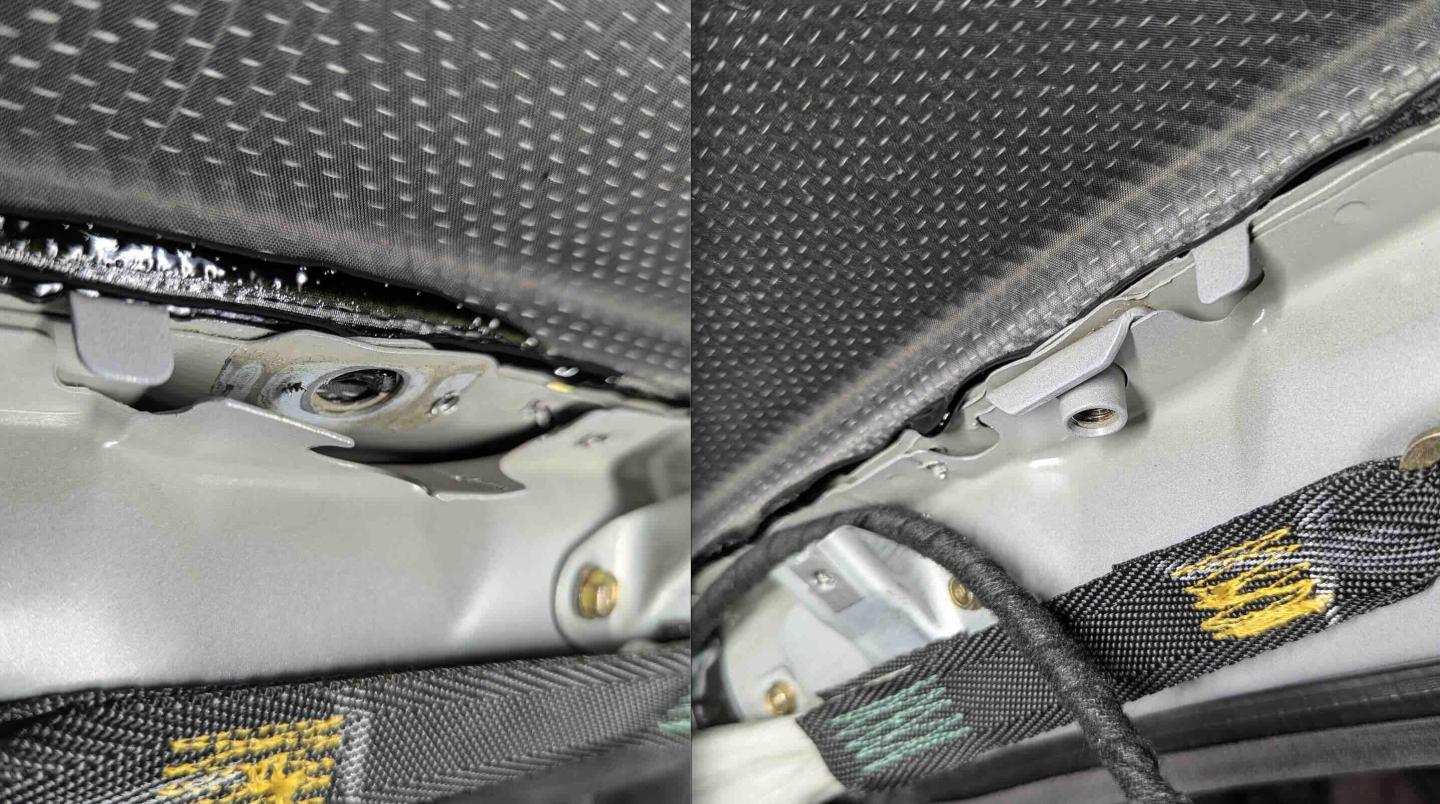

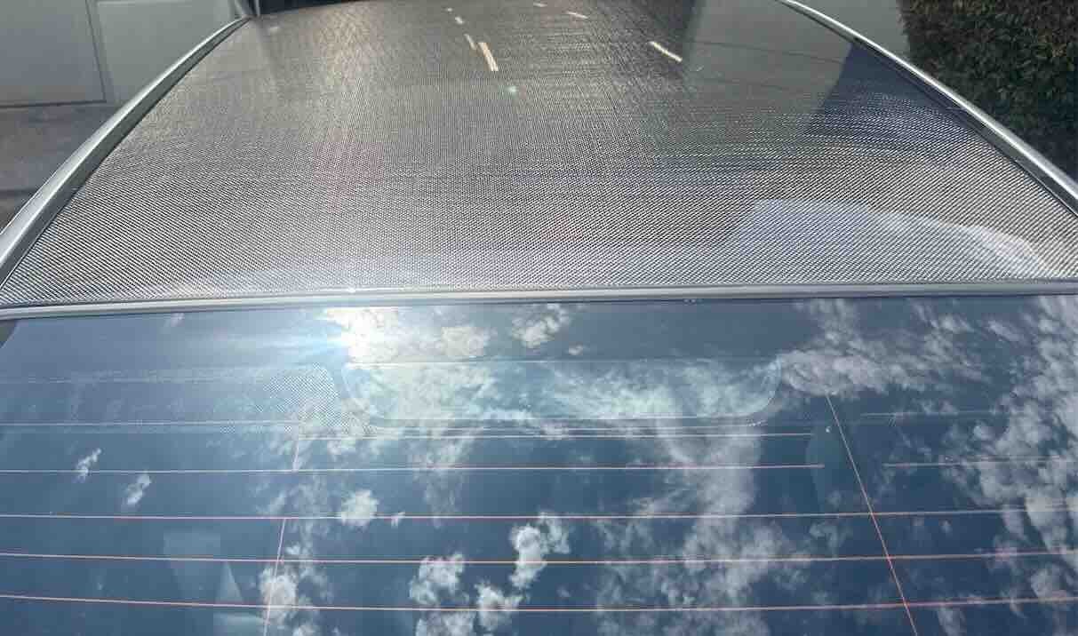

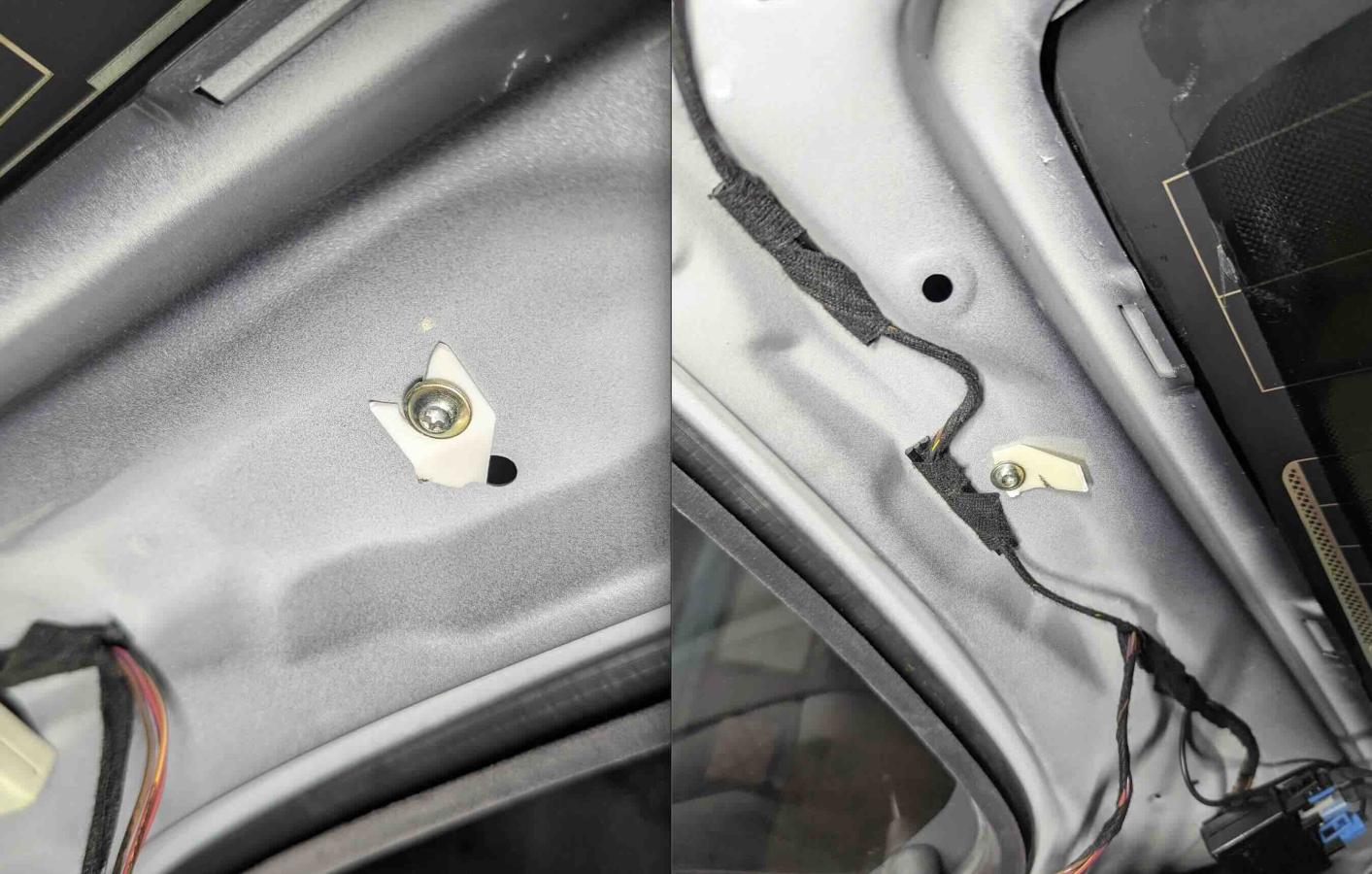

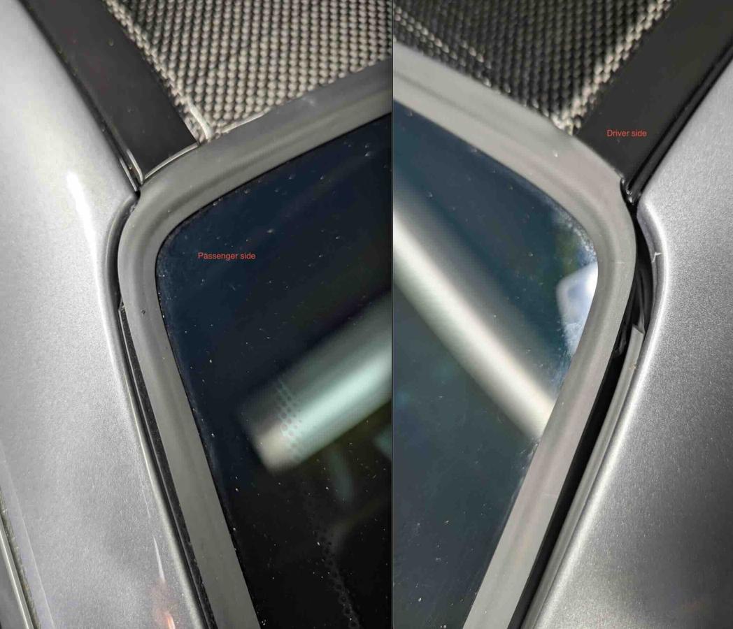

                                I recently had a carbon slicktop conversion at a popular Southern California shop, 2M. My car was transported over to the shop and I was unable to inspect the work in between or after until it was transported back. I also had my own carbon roof which was transported to the shop. I have my own headliner which I did not ask the shop to install. The shop owner was easy to reach and friendly at the time and I'll just leave it at that.
                                For anyone else looking into doing this, let this be a list of items to look out for.
                                Here are my observations after getting the car back:
                                *OEM Windshield is misaligned. This is visually obvious with how much gap there is on one side compared to the other (see photo).
                                *I see scratched paint in the side gutter of the windshield seal like a metal screw driver was used to pry it.
                                *New windshield seal has a 1-2mm rip
                                *Parts of the front and rear windshield seal edge were folded in. As simple as it sounds, I used a trim tool to lay the edges flat against the glass
                                *Glued on roof rail on one side is misaligned. Where the rear window seal and roof rail meet, the window seal protrudes up compared to the other side.
                                *Inside, there are drilled holes that are not sealed or rust protected
                                *I see a pried sheet metal roof panel flare out (see photo)
                                *I see multiple drilled through holes. Instead of drilling just enough to separate the roof panel, welds should not be drilled through.
                                *Although water tight from my own testing, there are internal areas where I am expecting to see glue but don't see any used.

                                In short, I love the way the carbon roof looks but wish the workmanship was better.
                                In terms of drive, I can feel the car having less lean around street corners, but my main goal was mainly aesthetics.
