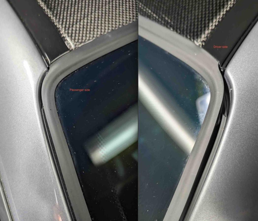

          Even my wife noticed this:
          Click image for larger version  Name:	MisalignedWindshield.jpg Views:	0 Size:	100.4 KB ID:	317626

                    Hey guys, the only thing that can "easily" be fixed is the windshield and I want to see if I can get that repositioned locally. I'm going to let thing setting first before giving out the shop. You can drop me a shop name I will let you know if I recommend them or not or don't know.

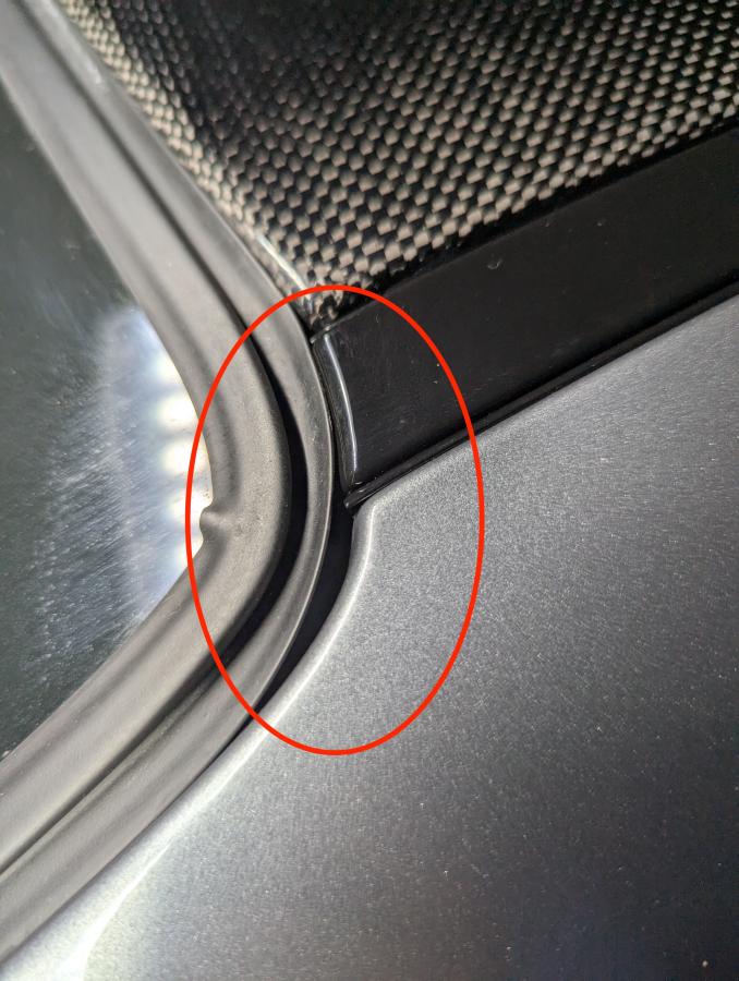

                    On a side note, does this rear window seal look right? Not the crease, but how the edges fold up and the gap?

                          Ignore the condition of my front windscreen moulding—my bad for not using a new seal when the glass was reinstalled. I watched my glass guy install the front and rear glass. All he did was push the glass up towards the roof until it wouldn’t slide up anymore. If that’s how your glass was installed, I think your roof was installed slightly crooked.
