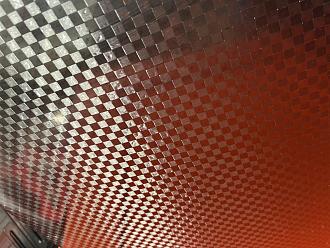

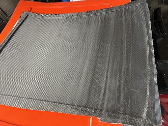

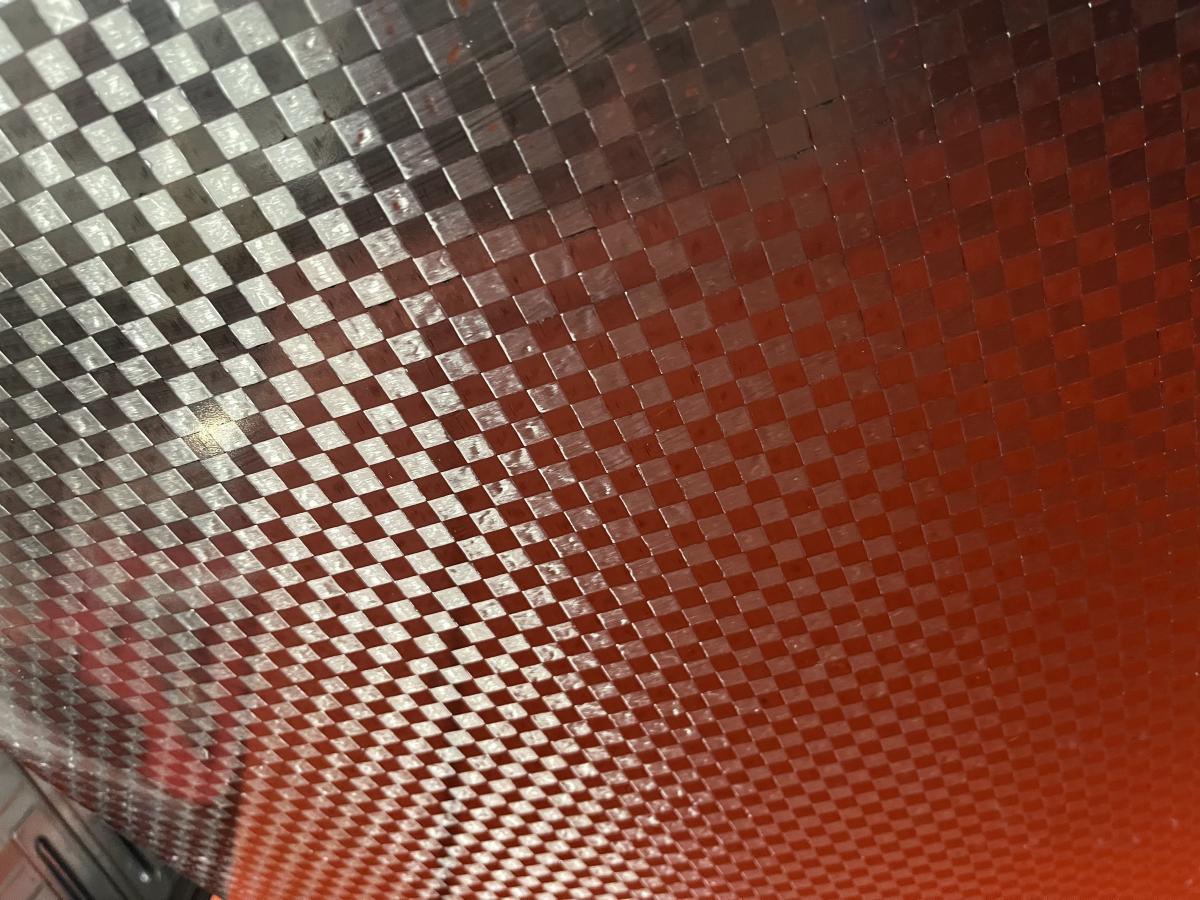

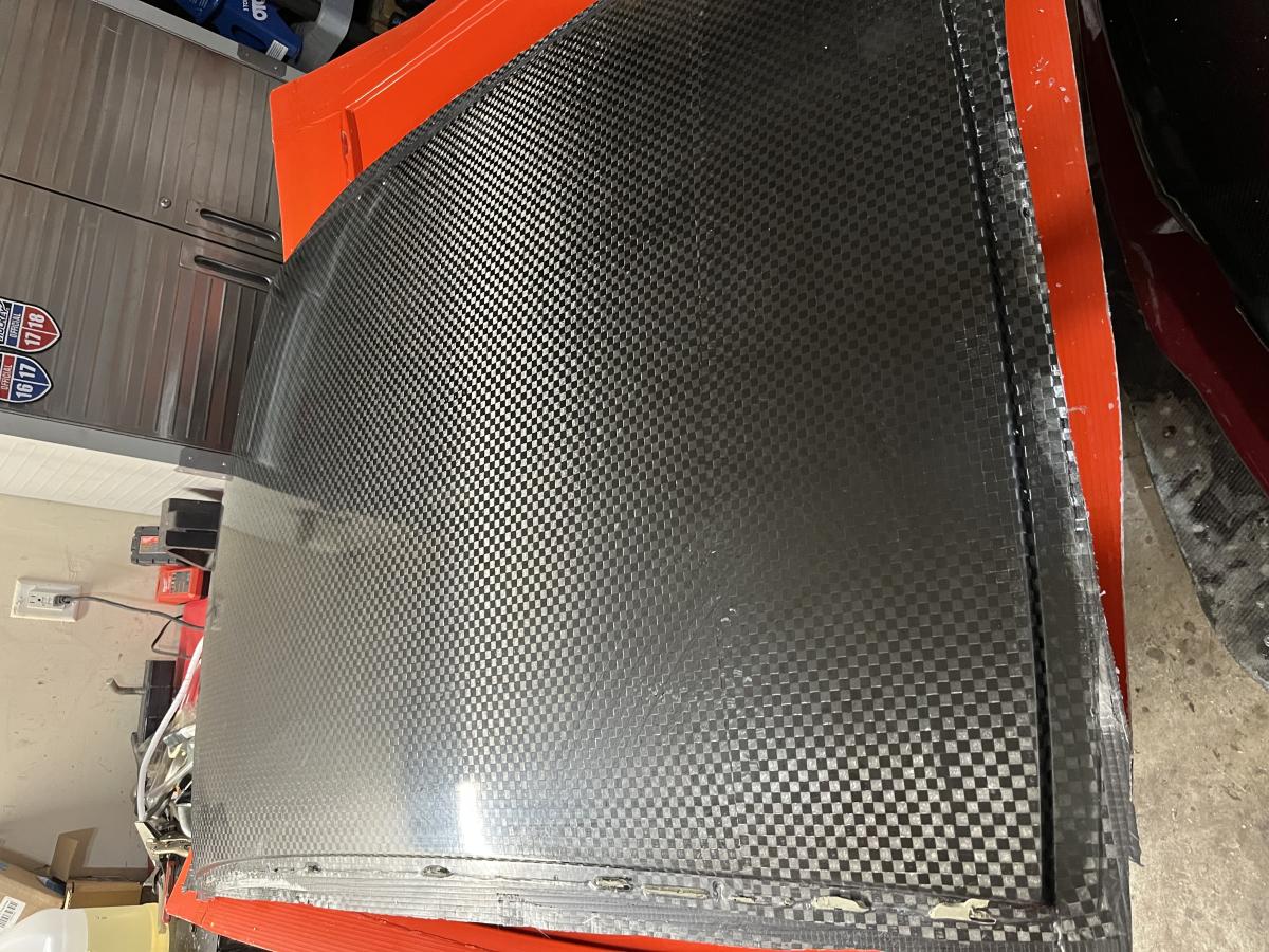

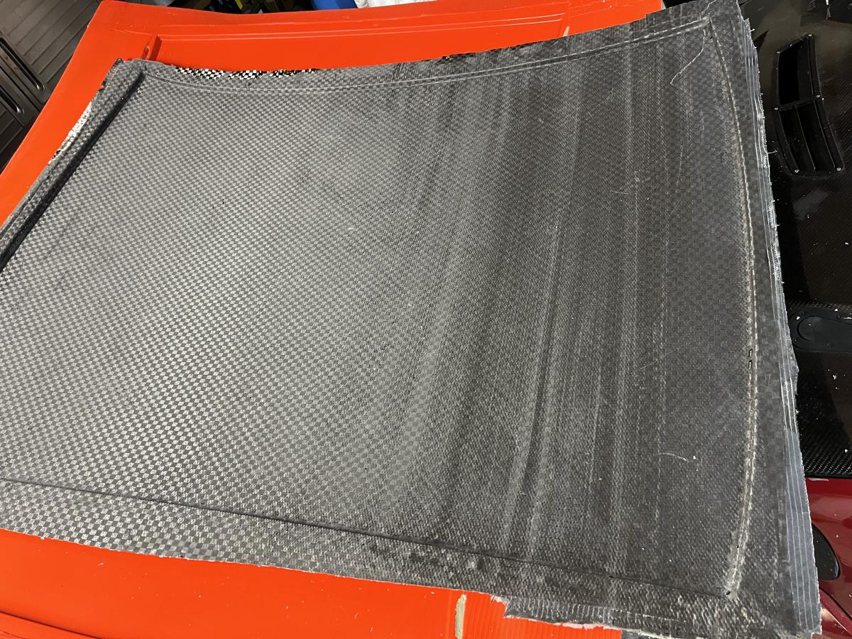

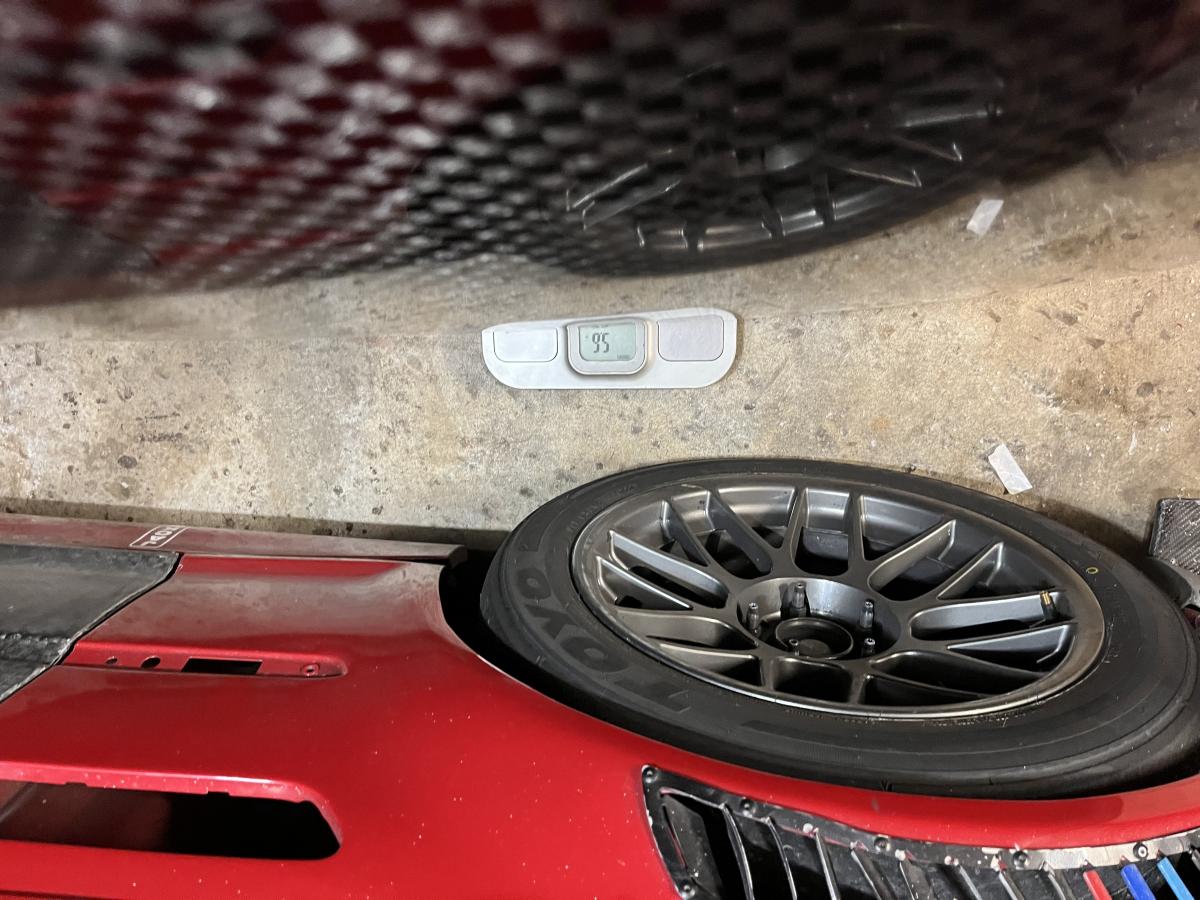

            1x1 spread tow roof completed! 5.6lbs. Straight out of the mold, no clear coat. Weighed a slick top roof panel - 18.4 lbs.
            It feels a little stiffer than the OE roof when trying to twist the roof diagonally.

                        bigjae46 can you show depiction of how similar your CF roof is to the OEM panel.
                          Not sure I understand?
                            If any of the details from the OEM panel are imprinted in the CF panel. It looks like it, but the limited quality on the forum doesn’t show it. Mostly looking at the edges that will be in contact with the frame when adhering it.
