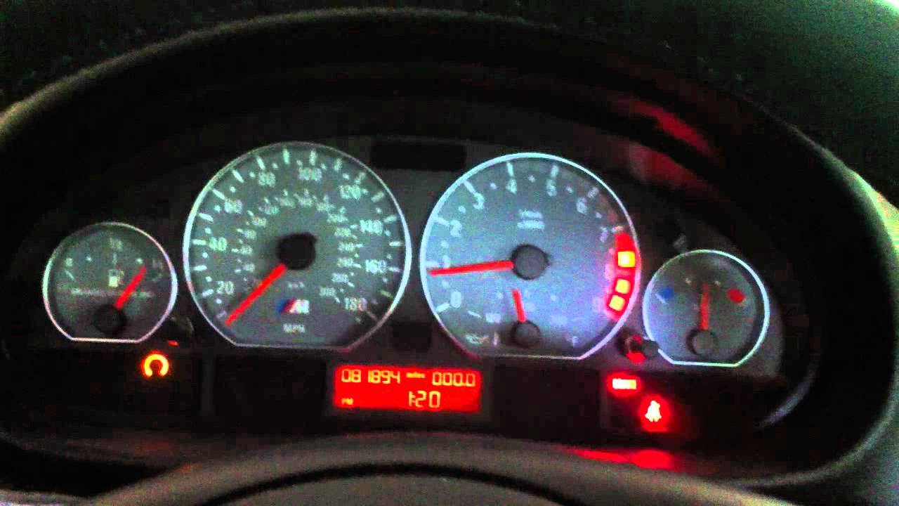

        It starts around model year 2003, and extends through the end. Someone correct me if I'm wrong but I believe there is no exact month, ie. some early 03's may have it and others not.
        There is a light in the cluster - in some cars its disabled and it can be enabled, in others it has to be retrofit. That arrow/cricle on the left. You can do the cluster test to see if you have it. And I believe if you do the cluster test and you do have the light that also means you have the MK60.
        Click image for larger version  Name:	maxresdefault.jpg Views:	42 Size:	74.8 KB ID:	3147
        To clarify, you don't need to retrofit the light. If you don't have it, you code it so that single press brings up the center yellow circle/triangle with exclamation point (M Track Mode) and long press adds the "BRAKE" light to indicate that DSC is fully off.
          Explanation from the last page of the DIY...
          d. If you don’t have a functional M-track symbol, and don’t want to solder the LED, set
          “DTC_LAMPE” to “nicht_aktiv”
          i. This will make the DSC system act like the non-M DSC where a single press
          makes the DSC symbol light up, and a long press makes the DSC and Brake lights
          turn on.
