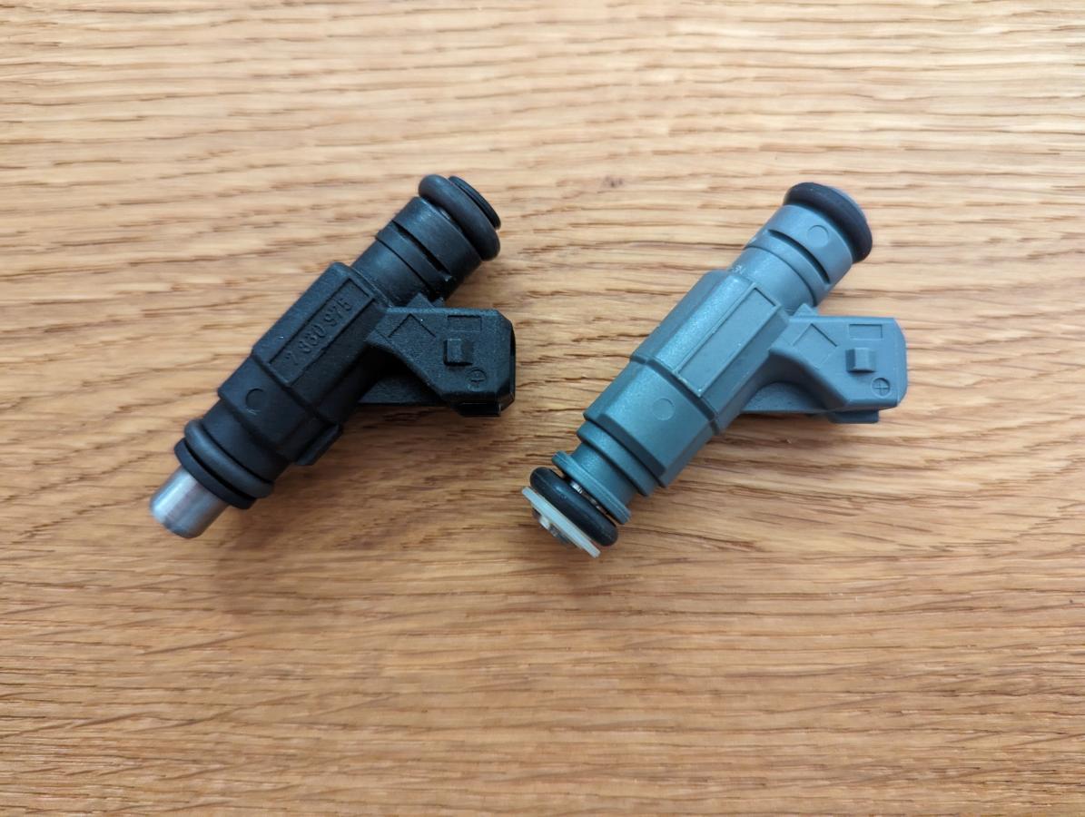

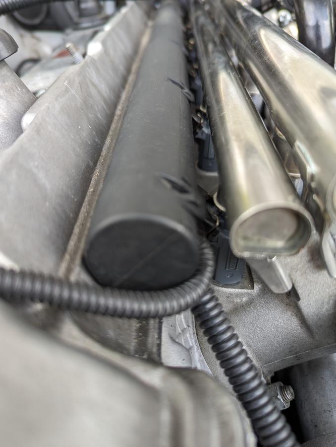

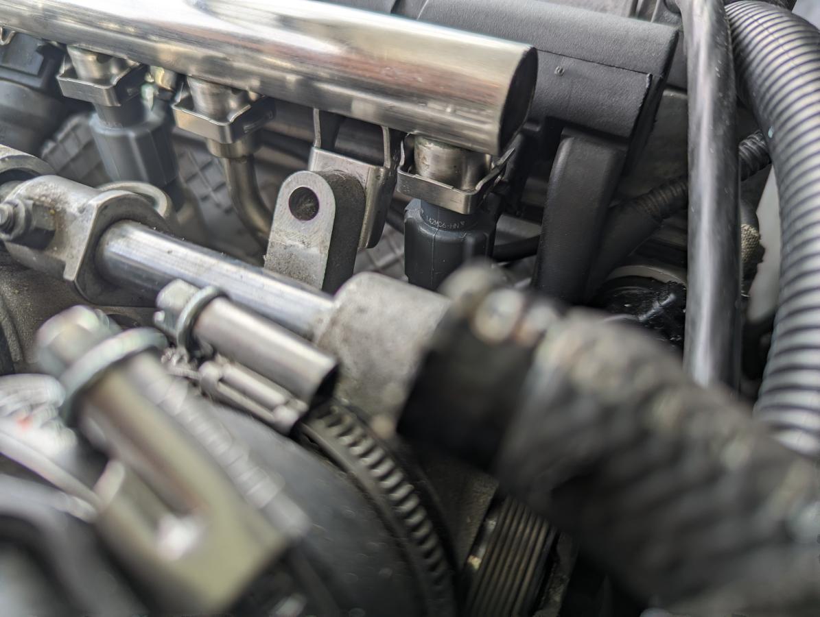

      I ended up going with Bosch 0280156063 injectors, those were used on early 2000s Audi TTs and S3 Models. They are EV6C and a plug & play fit. They sit 2 to 3 mm higher than the stock injectors but it's still within the tolerance range. Same connector, so no adaptations needed here.

      There's some Bosch EV14 injectors available different flow rates that should fit the fuel rail without issues, such as 0280158218. But EV12s have a difference connector, so either your plastic wiring rail for the electrics sits higher with connector adapters, or you swap the mating connectors as well. good thing about those is the little snorkel outlet is the most similar to factory.
      If for any reason, somebody wants to use injectors with a longer body, it's feasibly if you change your fuel rail to an aftermarket unit (e.g. the Radium Rail), which has the mounting tho the throttle bodies as a separate bolt on piece where spacers can be added. Or feel free to cut and reweld the mounting to your OEM rail if you feel comfortable doing it. With all the injectors available in different sizes as plug and play, this however should not be necessary.

      I have the same Bosch 62431 Audi TT injectors and I think you need to remove the white plastic washers from them and put the o-ring into the groove
        #48
        That's a good idea, looking at the itb bore it does seem like a better place to put it. although the groove diameter is a bit larger so the o ring they came with won't fit. I have a spare unit on which I will try an o ring from the old OEM injectors maybe that will work. If it does I'll just get new o rings for factory injectors 👍
          #49
          So some further info regarding the o-rings:
          The o-ring on the nozzle side of the factory injectors fits onto the new ones without issue.
          The o-ring supplied with the 063 injectors should not be used. It's possible to push it into the groove, but the OD will increase from 14,4 mm (on factory injectors o-ring) to 16,15. It may be possible to push it into the bore on the itb assembly, but it could be very annoying to remove again after some heat cycles.
          The extension of the nozzle into the itb assembly barely changes from stock injector (17,45 mm) to 063 (17,28 mm). Spray pattern is V-Shape on both. So after removing the plastic disk, it should be more or less the same.
          The nozzle side o-ring is BMW part 13647830611 spec'd at ID 9,3x2,62 mm.
          I wasn't able to find an o-ring for the application in this size, I may order Elring 135.500, it's 9,2x2,8mm so just slightly thicker. BMW branded o-ring is over $11, which is just ridiculous.
