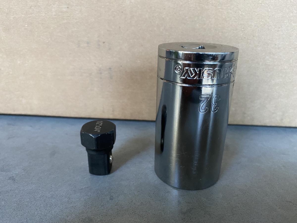

    Funny, I just changed my timing chain tensioner today.
    I used a 32mm Husky deep socket I picked up from Home Depot and a "Square Drive Socket Cap" I picked up from Harbor Freight.
    It's tight, but you can fit a wrench on the socket cap and get the tensioner in or out. Just note that you really can only use this for breaking the tensioner loose and tightening it. Once the tensioner is loose, you'll need to pull the socket off since there isn't enough room to back the tensioner all the way out with a wrench on the socket.

    P.S. The socket cap + deep well socket approach is mentioned in the S54 VANOS thread here: https://nam3forum.com/forums/forum/m...os-info-thread
