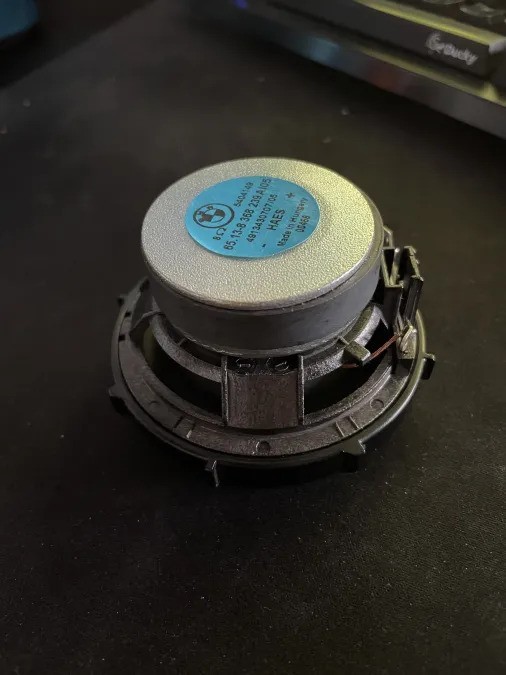

                            ​Hey guys, I am currently stuck with my Bavsound speaker install. Never thought I'd say that as my E36 was 100% drop in and go. But I can't find any info on this.
                            I have a 2005 HK m3, The housing on my rear tweeters are different than everyone on YouTube who has installed them.
                            I can't figure out how to separate the tweeter from the plastic screw thing that screws into the speaker grill. Without ruining one of the two.
                            First pic is my tweeter, and 2nd is the tweeter that everyone else has.
                            Anyone run into the same issue?

                              Figured it out, They are the same as the sedans, Take a ton of force but after a while they release.
