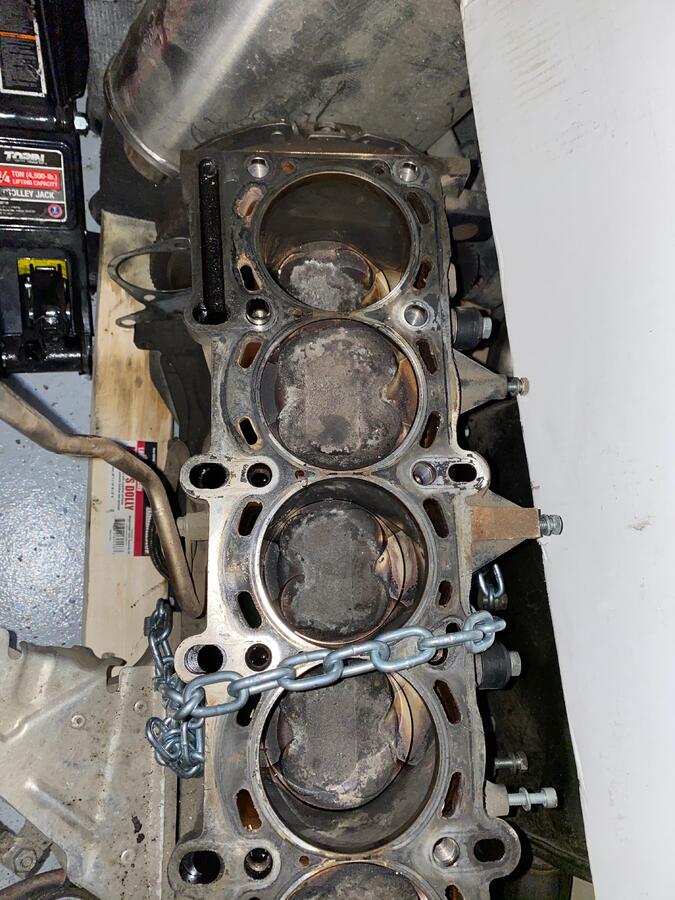

      This is the best quote to describe this build. Ok this post will be a bit lengthy and I apologize for that in advance. But first, I would like to say thank you to everybody who has responded and contributed to this thread, I appreciate your help, it has helped me beyond thinkable with this build. If it is not much to ask I will ask to keep this thread alive and well, because due to my craziness and being as Ethan puts it, s54 owner, I want this thread to be a pile of information and new tried things since I never saw it before. Meaning I will ask dumb questions, sorry I can't help it still semi-noob engine building haha; but I want it for everyone else to see and maybe some who builds an S54 is inspires to build his car NA. While Im j speaking rhetorically there, I believe having a lot of engine information and engine talk will be beneficial to the community.
      So going forward, I will have to replace my internals since my pistons are In the best of shape, and theres no point to going big and forgetting abut engine components. Addiotnally the reason behind newer components will be to have the s54 rev faster and have an all around lighter rotating assembly, crank, lighter clutch, carbon driveshaft etc. I always felt the s54 was a bit slow to rev anyway.
      After talking with you guys and Obioban, he convinced me that even his 356rwhp m3 is a riot on the street and Im changing my view on my build. This engine will be insane to begin with, crazy and not a regular s54 build, with cars I like trying something new and different from everyone. But, since he even said that ill have a fun time on the street and it has plenty of power and ill put her on a diet so her weight is around 3k, I realized that stroking it will not be done. I want this car and engine to be as raw as you can get, however I still want to drive to Dunkin Donuts some mornings with it. This car will be lighter too, so it will defiantly be fun. I don't want to be scared just riding in the car, I was crazy and fast but I dont want to fear my car, if so I would've slapped a turbo on there.
      Next, since Im not doing a "Stroker build" reasons being 1. finky 2. rebuild costs 3. I would be able l to drive or enjoy it the same as I want to 4. overall initial costs, 5k for a 97mm stoker, insane. 5. risks of things going wrong 6. oil, as I don't want to run a dry sump
      But, this engine will be: fully rebuild, balanced and probably blueprinted, new everything. Lighter crank and pistons/ connecting rods. I wouldn't be surprised if the displacement jumps up a couple of ccs du to after market parts, which is very ok by me lol. This engine will have a Bimmerwrold CSL Intake that routes to the front of my car, air will feed through kidneys girls, radiator lowered. However, I will be raising compression, to what yet im not sure.
      I have already contacted Partee racing and they would be happy to, I just have to wait for a week becuas ehe is backed up with work right now. So nows the perfect time for me to as questions on here.
      How high of a compression is too high for E85? I have to retain Vanos, but whats the main effect if I were to put in high lift schrick camshafts versus less lift Cat Cams? Is there a way to run a flex fuel kind of tune, because the pump E85 in Norcals isn't straight e85 and im guessing either way it'll fluctuate a lot? 13:1 on street? Best guy to get headwork done? ill ask more questions along the road.
      Either which way this engine will be a nit radical, crazy, and seen as stupid but it'll be fun and thats all that matters at the end of the day. I want to push to see how far we can go. Below are my current Pistons, backstory I bought my m3 from a sketchy guy and well many things went wrong and there were problems left and right, lesson: trust yourself and m3s are not cheap lol. Anyhow, I have pictures of the entire engine when taking out every part and stuff so if anybody wants them as reference or just bc let me know, but here are my pistons #1 + #6 expierneced the worst. I only put 7k on the engine and I did a retune, complete VANOS job, both tabs broke, and the guy before me swapped SMG to 6MT in a a garage.
      Any info, insights, comments, considerations, or anything is greatly appreciated!
      Thank you again,
      Anthony
