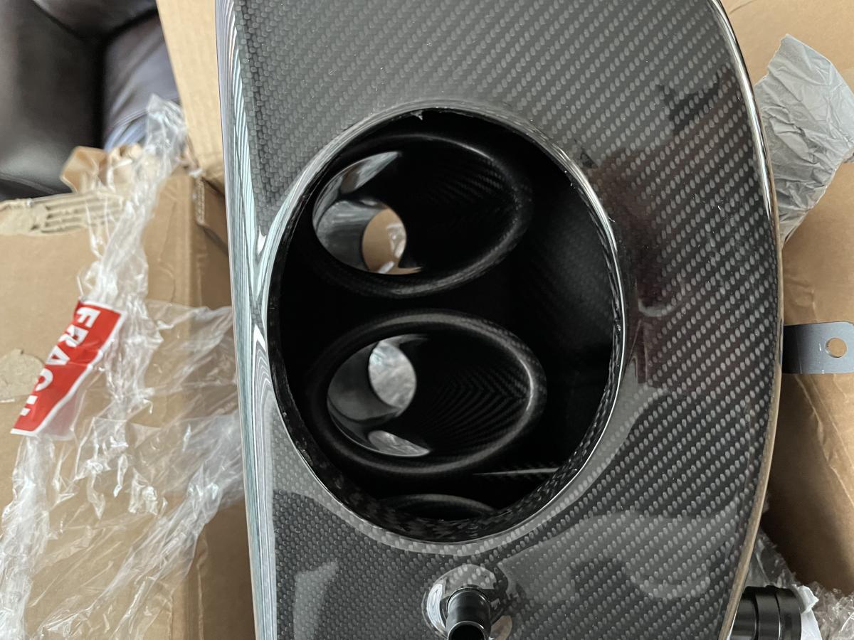

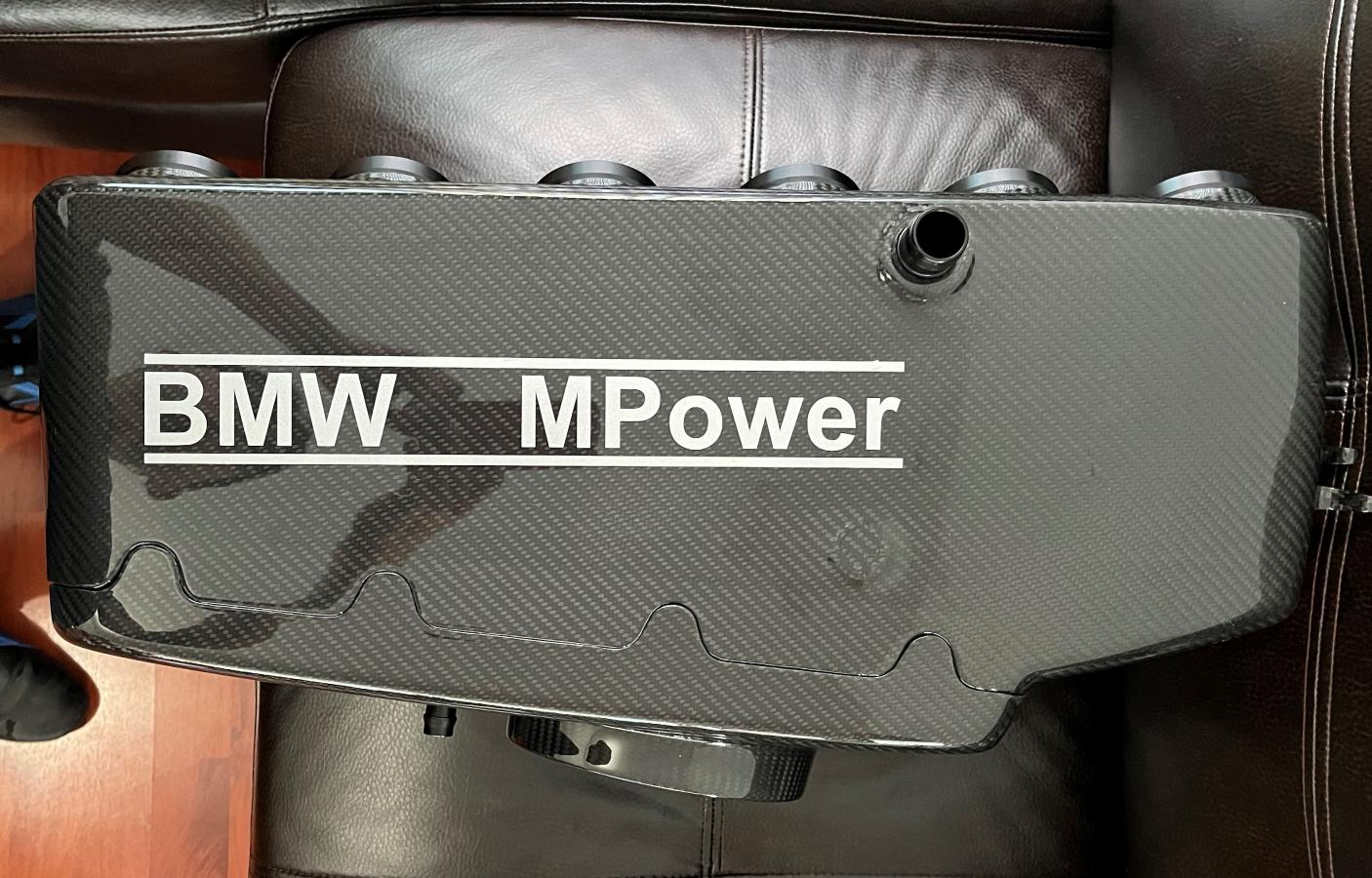

                      Unboxed and sticker added. Too bad the car is not with me to install it... It will be next weekend

                        I realized I could just use 3/4" ID hose! So I'm going that route. All the CSL hoses I could find don't ship until mid next week.
                        BUT DHL said it would deliver today and...sadly it's not here yet. I did have to pay them $50 for customs last night, so maybe customs payment slowed down the delivery process. Or maybe because today was Veteran's Day.
                        Even got rivnuts and a tool for them same-day shipped over Amazon.
