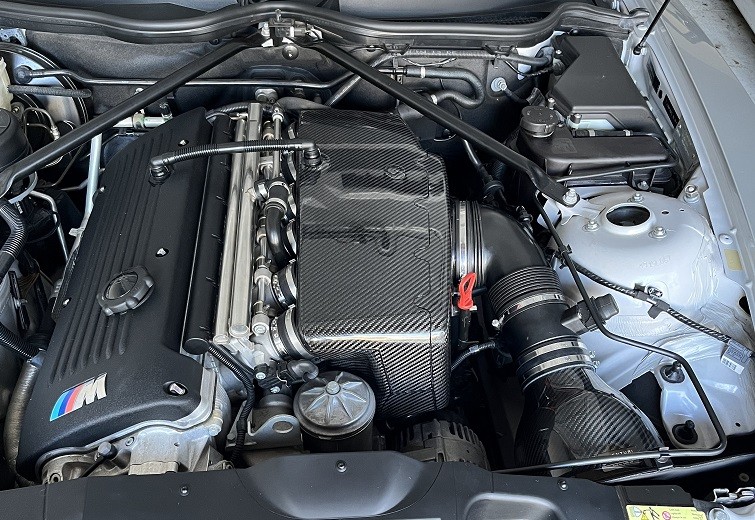

                  Here it is the final product...
                  After driving the car for 2 years on Alpha N, now that it is running on a MAF she is butter smooth, even when my car had been dialed in and the tune was pretty good, however, the MAF setup does show its benefits. throttle transients are perfect and seamless, whereas the Alpha-N could be jerky at times. also, I don't notice any drawbacks in power, the MAF map is just as good for power according to my butt dyno.

                        Got the manifold installed this afternoon! Been helping a friend with installing an Accusump on his E89 since.
                        Final issue is the lower larger hose, the one on the outer right on the bottom, which had its ring clip broken off. So it fell off a few times while driving, before I duct taped it in place. I ordered a similar looking BMW hose from Amazon ($16) with hopes of stealing that hose end. Otherwise, gotta shell out $76 for the actual oem hose
                        Overall install: The tips above helps a ton! WAY easier.
                        We had some struggles with air leaks at first. Between that, plus that smaller hose from earlier not seating correctly, plus the K&N to manifold not quite sealing at first. The smaller hose I got was longer than original, and has a one way valve, which is cool. This also made install trickier though due to length.
                        Video from inside the car below.
                        Will temper expectations here: the recoding sounds very similar to each other, but in real life, the tonal difference and volume from the front of the car is way more apparent. The phone blends together the exhaust (Borla) and intake. With OEM manifold, I'd say the intake was half as loud inside the car as the exhaust. With the Karbonius, it seems around as loud. The tone is a bit different as well.
                        I now need to find an Eventuri intake, because having a K&N next to this thing just feels wrong. (If someone in the midwest has one I can swap in for comparisons, let me know! Just don't have the budget to spend another grand on this car right now, with winter here)
                        EDIT: Forgot to mention. Weighing both OEM vs CF box, the CF box was 5 lbs lighter! Was a nice bonus to lose that from the top of the engine.

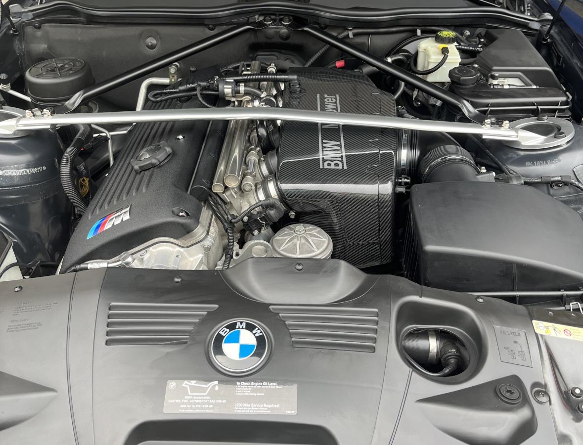

                                I got my Karbonius plenum installed yesterday but didn't get a chance to have a proper drive until today.
                                Notes on the installation:
                                - pretty straightforward, even for someone like me that isn't very experienced.
                                - I used silicone tape around the plenum opening. This gives a grippy surface without leaving a residue.

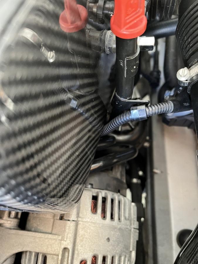

                                - I had some trouble with the location of the dipstick - it was too close to the plenum and rubbed when I was putting the plenum. In the end I used rubber washers on the mount to space the dipstick away from the plenum, which worked fine (see one of the images below).
                                - The hose that comes from the elbow (only Z4s have this) joins up with the electrical conduit that is mounted to the side of the dipstick. There is a mount on the standard plenum for these but not the Karbonius plenum. I zip-tied them up but it's not ideal (see photo below).
                                - I tried to install the stock air filter housing but it was contacting the electrical conduit on the side of the dipstick and the dipstick itself. Even if I hadn't of used the spacers, it would have been close. So, I just installed my Eventuri straight away. Bit of a bummer as I wanted to do some tests with the stock air filter housing.
                                Notes on Karbonius plenum performance
                                - After GuggagZ4M said with an Eventuri it was equivalent sound-wise to the full CSL intake, I had some pretty high expectations, and it didn't quite live up to them.
                                - Having said that, I had a long drive today and there is a definite change in tone and increase in volume. Particularly, the CSL 'warble' is much clearer now. Low revs (~3,000rpm) in 3rd and 4th really accentuate the sound and overall, the intake is just more present everywhere all the time.
                                - I did a freeway on-ramp today with concrete barriers and the sound was epic! I stuffed up the recording up of this unfortunately.
                                - I've never been in a car with a CSL intake and I'd be really keen to see how they compare.
                                - Overall, I'm happy with the plenum and knowing what I know now, I would still buy it.
                                I made a video, which includes the car in stock form, with Supersprint V2 headers and cat'd S-pipe, and then with headers, s-pipe, x-pipe, Powerloops and Eventuri and the current spec which is all the previous except the x-pipe (which I took off a while ago) plus the Karbonius plenum. I included the videos of the stock intake with the headers and s-pipe because when I added these it was much harder to hear the intake. So, this is probably the best baseline for the Karbonius plenum. Sorry for the funny framing in some of the videos - no one wants to see my face!​
