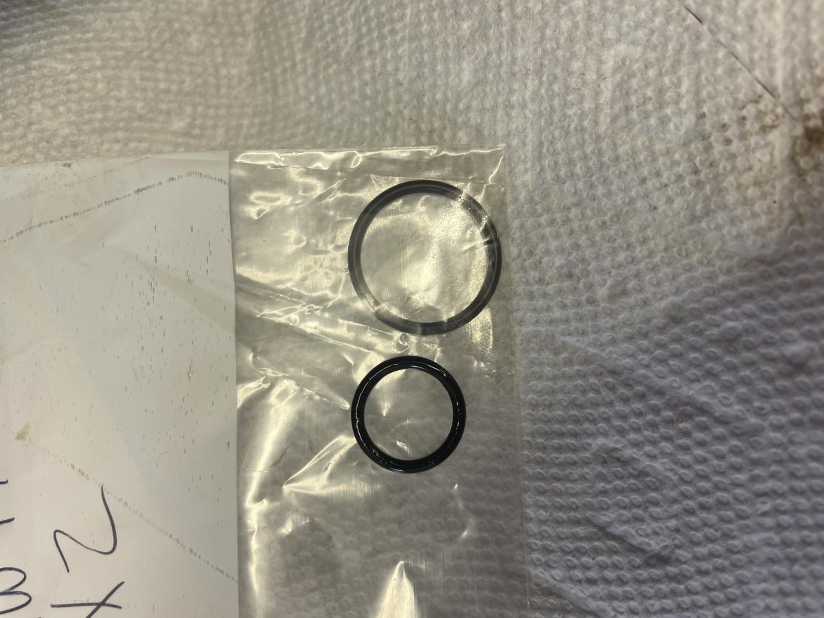

        Here is the comparison of the correct oring and the one I was sent originally for reference. Both came in the same bag with the same part #.

          Wow definitely too much stretch on that one.

                So I just received the box from FCP. They 100% sent me the wrong oring last time. What a waste of my time and potential damage.
                I had the same issue while doing my cooling system refresh. ECS sent two different size Orings for the hard pipes on the water pump, a 16 and 18mm. They are both suppose to be 18’s. 🙄
