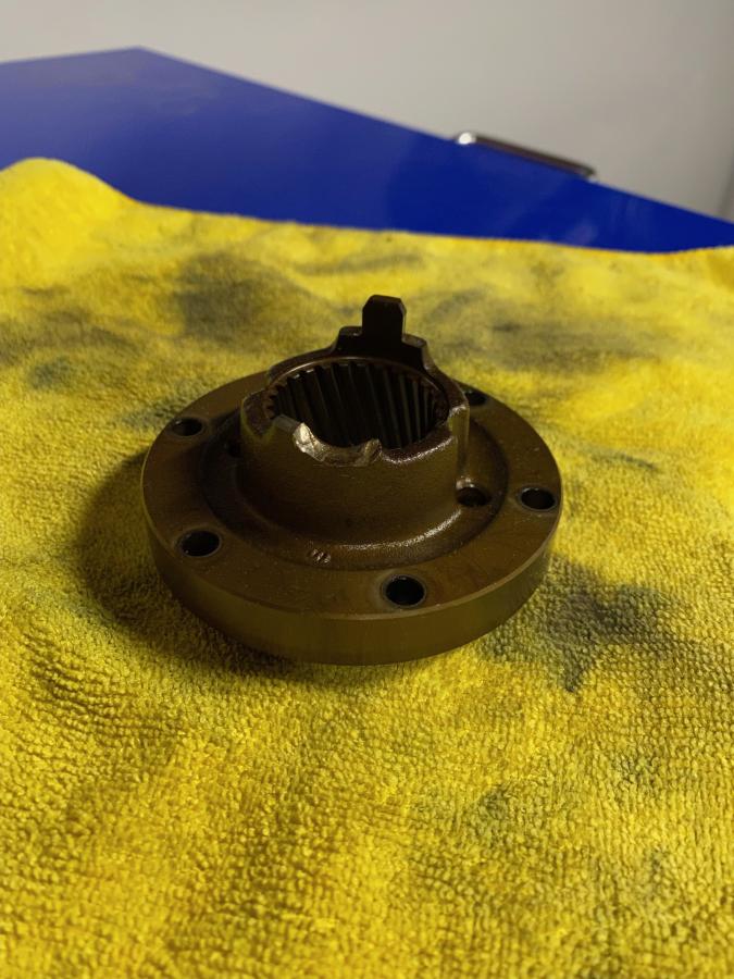

                Just to add a data point, I caught one of my exhaust tabs partially cracked. It was VERY hard to see with visual inspection while everything was still assembled. Just a small darker line where the tab meets the body do the hub.
                Ended up replacing the hub, full beisan kit, cam bolts and chain guides. My old hub makes for a fun desk ornament.

                    I had one like this as well (might be the one example Obioban was referring to). Who knows how long it would have lasted like that. I ended up going with the turbotoy hub. That was actually the second time a vanos hub was replaced on my car. The previous owner had one replaced at about 60k miles.

                              I'll get pics this afternoon. May need to get creative with camera and wetting the surface to see the crack. Hard to spot dry.

                                Photos of my hub. I marked the end of the crack in the closeup. It had worked it's way roughly 60% across. Consider myself pretty lucky
