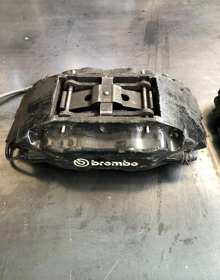

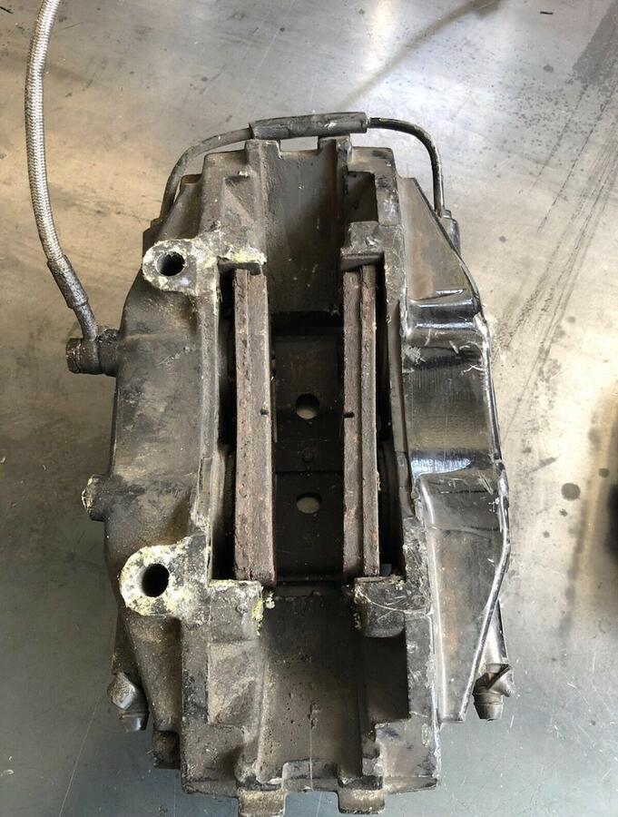

    I found a used pair of calipers locally. Wondering if anyone can tell me if these will fit the E46 M3 and what adapters I might have to get. Thank you.

      Those are GT1/F40/F50 style Brembo calipers. To really know if they'll work correctly you need to measure the pistons and do some math to calculator the brake balance. As for brackets, I'd measure the bolt mount spacing and then see what might work. Most likely you'll have to get something custom made. The Vagbremtechnic Aston brackets are about 185mm, I'm not sure what the spacing is on Stoptech or a real Brembo GT kit is.
      You can get brand new Brembos off an Aston Martin for under $400 a side - which after you buy those and rebuild/repaint I bet you're going to be close to the same cost. And using the Vagbremtechnic brackets it all just bolts up.

          Thank you so much. I think I'll pass on these and then get something like you suggested where the solution is clearer in sourcing the whole thing.

                    Those are GT F40 calipers. They don't look like F50's just due to size. You can buy brackets directly from Brembo or Race Technologies. I'd measure the pistons because they look like rears.
