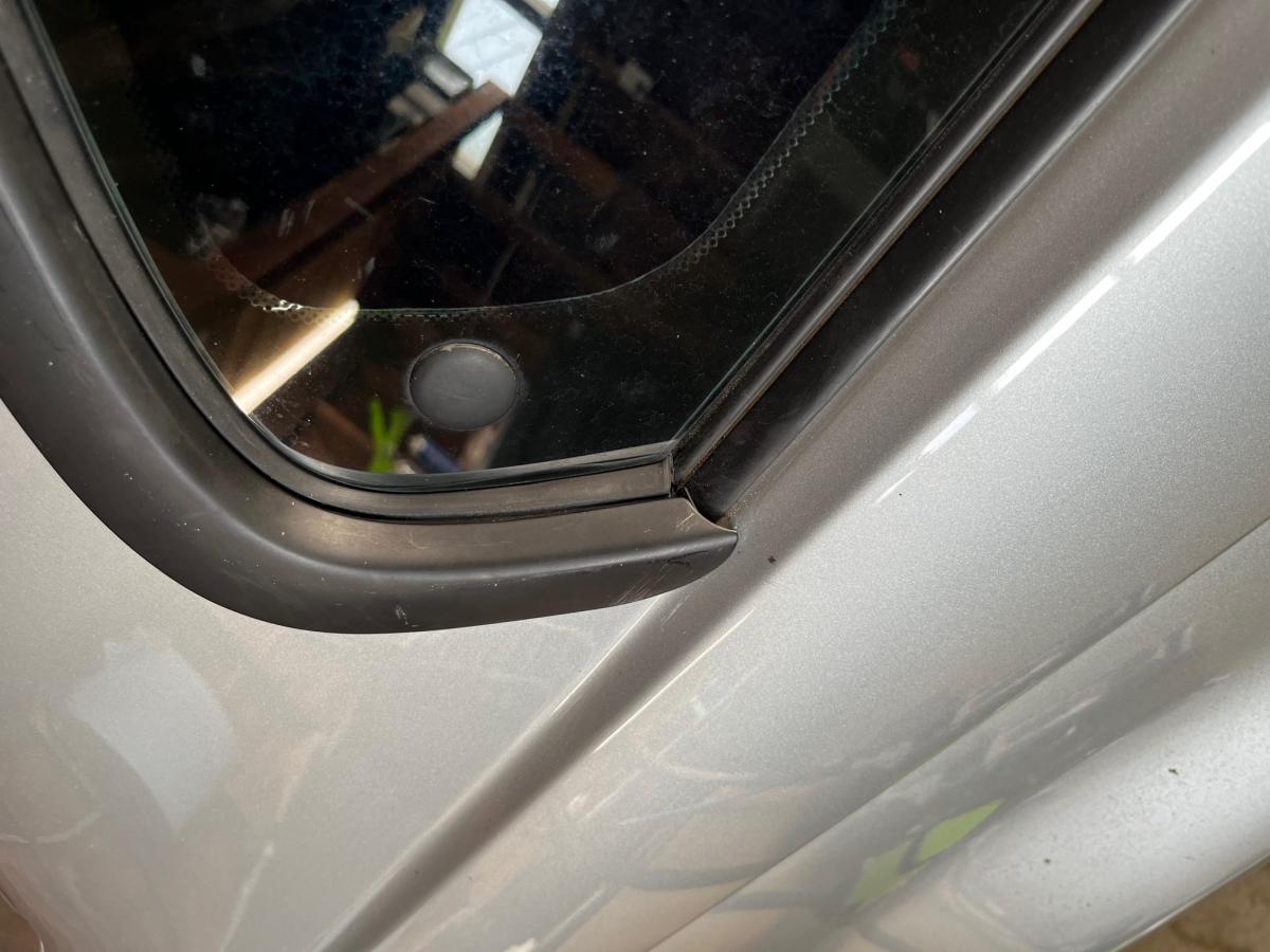

couldn't contain the excitement when I opened the package lol. So good to have an OEM replacement after all these years.
. Mine don't even look that "bacon'd"
- Likes 1
The install isn't horrible. The worst part is probably the small bracket that retains the seal at the rear of the trim piece. You need to remove a rivet that holds the bracket in place. I tried silicone lube and sliding the seal in without removing the bracket but after 15 minutes of fiddling with it I decided to just remove the rivet, install the seal and then rivet the bracket back into place.
Overall the seals feel like OEM quality and the wavy rubber does not show once reinstalled. I do have a bit of gap between the seal and trim but that could be due to my lack of skill or the fact my trim pieces are 20 years old and slightly warped.
- Likes 3
