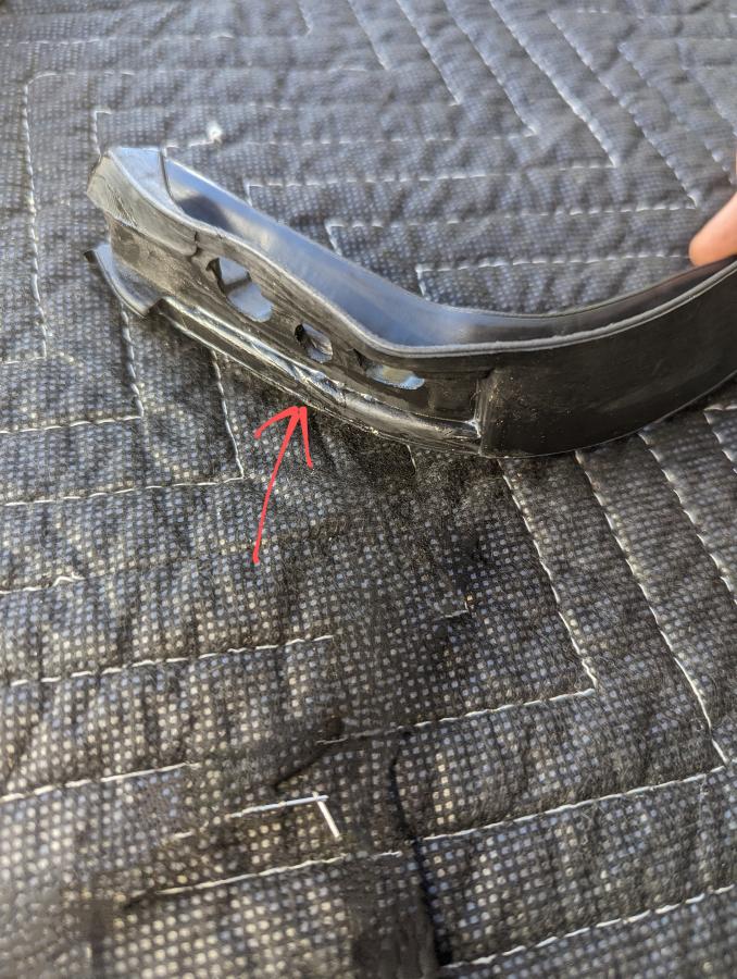

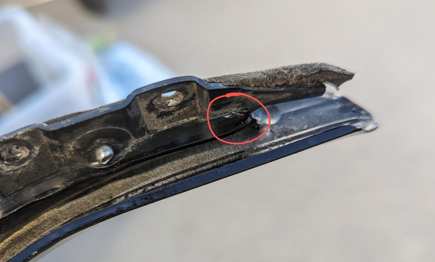

    • Don't try to slide the whole piece in through the aluminum bracket area. It's too tight, even with lubricant, there's an easier way. Instead, take pliers and bend the corner up slightly on the rear end of the bracket. This will allow you to slide the new rubber in basically right where it needs to be. Definitely still use some sort of rubber safe lubricant. I've indicated below where to bend the aluminum, and where to align the rubber to that bent area prior to pushing it in to make it the easiest. You'll only need to slide it about an inch into its final place.
    • Click image for larger version  Name:	PXL_20231020_200806040~2.jpg Views:	0 Size:	96.1 KB ID:	243690Click image for larger version  Name:	PXL_20231020_201203041~2.jpg Views:	0 Size:	135.3 KB ID:	243691
    • I also found that my windows were very tight on this new rubber when closing. You'll want to slide the black finisher as far backwards as it will go while tightening the screws. Start with the screws in the most rearward section first. I was able to alleviate more compression on the rubber by removing the inner B-Pillar and loosening the two nuts that hold the rear window bracket on. The B-Pillar can be removed without removing the rear "door" cards. The "door" cards bend enough that you can access the plastic clips that hold the B-Pillar. There's play in the window mount, and I was able to slide the windows forward before re-tightening. The new rubber is still tight, but I'm hoping time closed will compress them into shape. I add a bit of grease too to help with friction as they closed.
