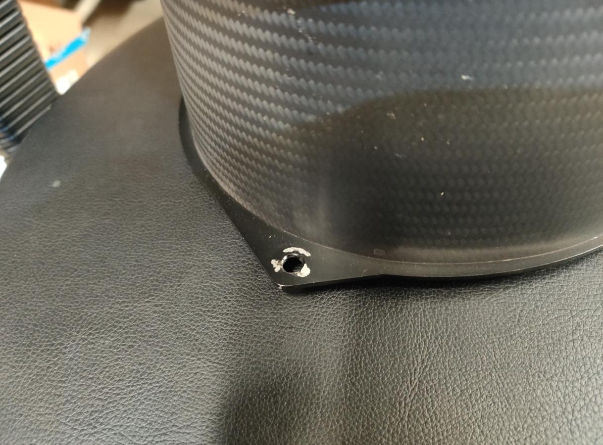

    Just by hand, only took off the tiniest bit like 1mm in the direction I needed.
      #47
      I’ll do that if Karb confirms that warranty won’t be voided. Can’t use a drill bit and step up in size until there’s enough clearance to thread screw on?
      Edit: Did you use a hand rat tail file to elongate the hole, or did you use the drill attachment to open it up evenly?
      I highly doubt they'd deny a warranty claim for that. Just don't crack the tab with a ton a pressure if you choose to do the rat tail method. Go slow and use light pressure and you'll be fine.
      Take a look at my build journal for their trunk and how much massaging I had to do. I think anything aftermarket that is hand made and not stamped out/cast/formed/milled/etc. by a large batch and highly repeatable manufacturing process, you have to expect a degree of "character".

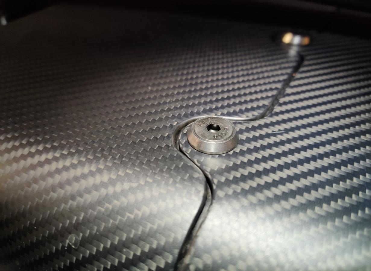

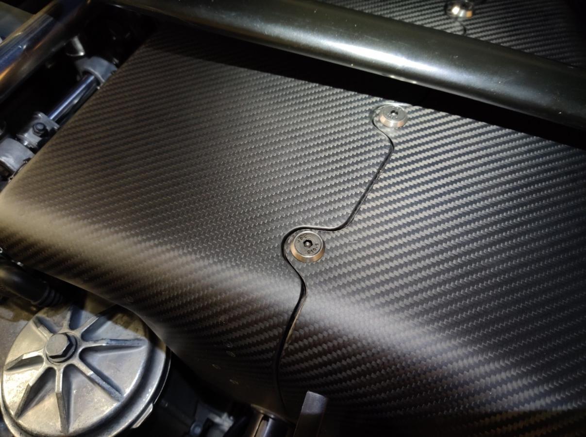

            BTW, hey Tyler - saw your post about the washers (or lack of) on the Karb screws we're currently discussing. I too was surprised by their lack of washer.
            I went a slightly different route than a flat washer. I got some tapered/countersunk washers and screws. My plan is to paint the washer black to match the snorkel's color. But I love these washers and screws. They have a very German feel about them while assembling them.

              Yeah I’m also surprised they didn’t QC check the fitment between the two sections. I’ll give it a go with a file.

                  I’m not really upset anymore now that I know the rear tab itself is not misaligned. If I line up all of the tabs, it’s the front tab that requires elongation (post 42). The front and rear/sides of the two sections line up better this way, too.
                  But yeah, for any potential buyers, just know that you may have to slightly modify the holes.

                    Ha! I didn't see you had done effectively the same thing until you pointed it out above, or I probably would have shamelessly plagiarized your solution! But when I was searching for washers, those countersunk ones popped up and I thought it might be a cool option.

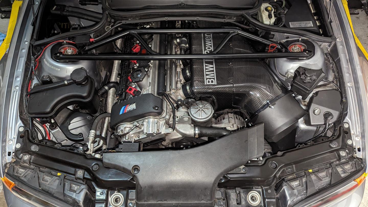

                          I recently installed the Shadowline CSL box from Haimus and the box fits great. Quality is top notch and Antony was very responsive whenever I had a question.

                            Something looks off to me about that CF weave. Not to mention I think it's going the wrong direction.
