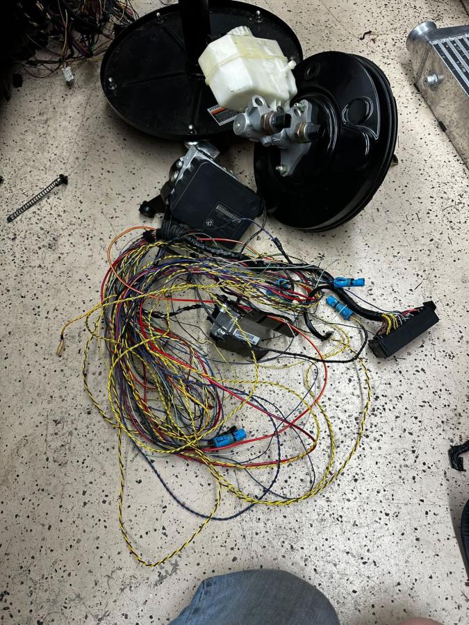

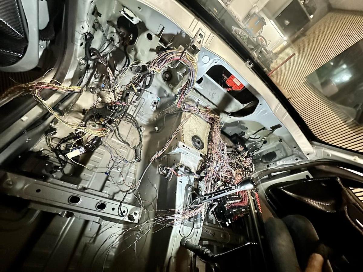

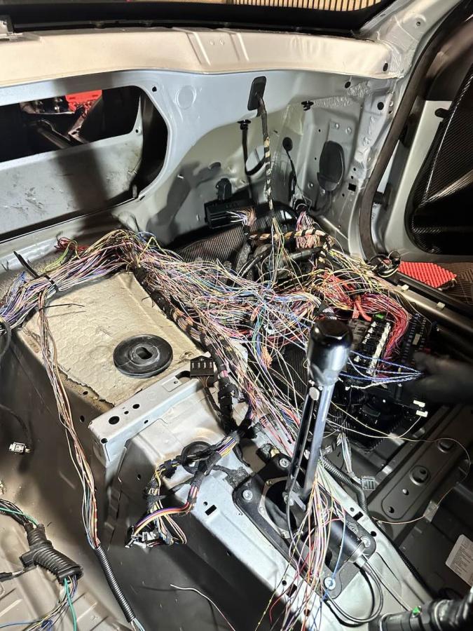

                        I just swapped my friends `02 e46m3 Time Attack race car from an MK20 to an MK60. It wasn't hard, but you need a lot of random things to make the job way easier, and lots of patience. This is how I did it.
                        First, I did some research on the MK60, how it works, what each wire does, and where it goes. I saved all my work here: https://github.com/liam821/e46mk60/b...s_side_plug.md
                        Next up, the wiring. I had a complete '03 e46 325i non-M sedan main body harness and carefully removed the whole MK60 harness/plugs from it - so wheel speed sensor wiring with plugs, etc. This makes it so much easier because half the wires are already done. Just lay them out in the chassis to each wheel, route them through the chassis gromits, and plug in and go.
                        Click image for larger version  Name:	677492EB-8EE3-4F24-99B3-993677C6540F.jpg Views:	0 Size:	166.0 KB ID:	363606
                        With that in hand, next you need to disassemble the whole interior - thankfully his car is a full track car so there wasn't much of that left. We still had to pull the dash, hvac, steering column, dash crash bar, etc. You need complete access to all the wiring. Next, we pulled out ALL the mk20 wiring from his, which means undoing all the wiring looms, zip ties, and Tesa tape that holds all the wiring together. Then, one by one, each MK60 wire was carefully routed to the correct location and spliced in or pinned into each connector. I used a BMW WDS manual for all the pin terminations and locations (see github link above)
                        We had access to another M3 chassis, which was completely stripped bare, and was able to grab the OEM front brake lines from it. For the rear, we kept his stock lines, which run all the way up to the back of the engine bay, and will ran new lines from the pump to those and used OEM connectors to join them. Or he'll drop his tank and grab the rear brake lines from that other car. Future him problems.
                        After that, it was just a matter of programming the actual ABS pump via NCSexpert, and you're off to the races.
                        We also took the opportunity to thin out the rest of his harness while we were in there. So we removed all the hvac, stereo, dome-lights, etc all that stuff...,
                        If you're not comfortable tracing/splicing wires, don't do this mod. I HIGHLY recommend option 1) sell your M3 and buy a newer one or 2) swap the whole body harness.
                        Sorry for the bad pictures; I wasn't really documenting with my camera very well since it's not my car.

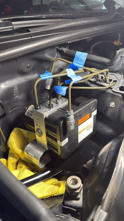

                          I should update on my MK20-MK60E1 Continental swap as I've had a chance to finally test the race car.
                          I had the harness rewired by Tulay's Wire Works (https://tulayswirewerks.com/) to work with the new race mapped Continental MK60E1 unit and sensors from Doug @ RHT Motorsport (https://www.rhtmotorsport.com/). I put in a brand new MK60 booster, master cylinder and reservoir. RHT sent over the MK60E1 unit, 4 new E46 MK60 wheel speed sensors and a MK60E1 yaw sensor which I mounted to the MK20 bracket in the original place under the seat, just cut and drill to fit. To get the smaller MK60E1 unit to fit, you will have to get a little creative to mount it in the original place as the MK20. You'll also need some M10 and M12 joiners, and some short bendable hard lines to reroute two lines.
                          The full aero race car was on Falken RT660's for an initial shake down, the front is the AP CP 9668 kit and the rear is AP CP 9451 kit running Ferodo 3.12 pads. The brake system worked so good, that I now have to adjust all my brake zones and brake pressures as I'm overbraking everywhere. The car is rock solid even if I try to get deep into the ABS. Pedal feedback and modulation is phenomenal. I tested with Motul 700 fluid but will be switching to Endless, so I expect that will make things even better.
                          A few pictures from the swap:

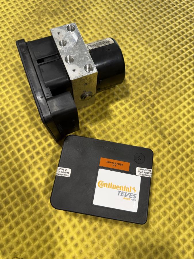

                          I snagged a MK60E1 unit from ebay UK for fairly cheap, and Doug @ RHT sent over the unit to swap to the valve body:
                          Click image for larger version  Name:	IMG_8480.jpg Views:	0 Size:	105.1 KB ID:	363608

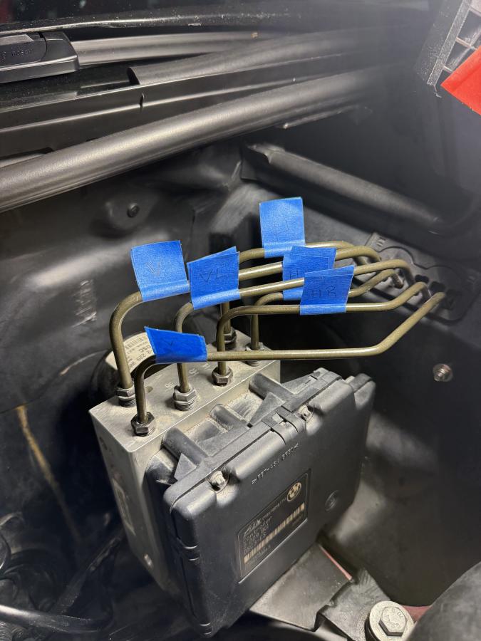

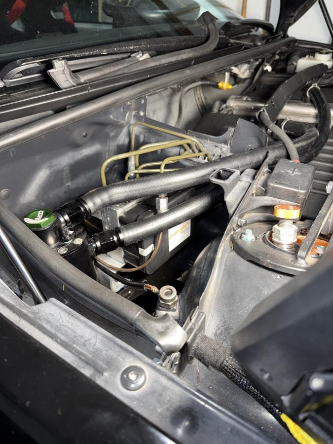

                          Here's what the MK20 unit looks like for reference:
                          Click image for larger version  Name:	IMG_8485.jpg Views:	0 Size:	74.2 KB ID:	363611

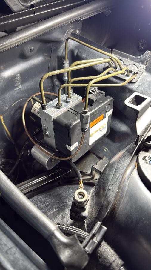

                          I bent some aluminum I had laying around to create a U shaped mount to raise the MK60E1 unit to fit the lines:
                          Click image for larger version  Name:	4695F109-3612-4180-9233-CB22C2F307C2.jpg Views:	0 Size:	68.4 KB ID:	363609
                          Use BMW M10 and M12 unions for the two lines, along with some joiner lines:
                          Click image for larger version  Name:	779FA14B-63BA-41C2-9632-44494FA6CAE4.jpg Views:	0 Size:	77.4 KB ID:	363610
                          And the finished unit:
                          Click image for larger version  Name:	IMG_8494.jpg Views:	0 Size:	99.8 KB ID:	363612
