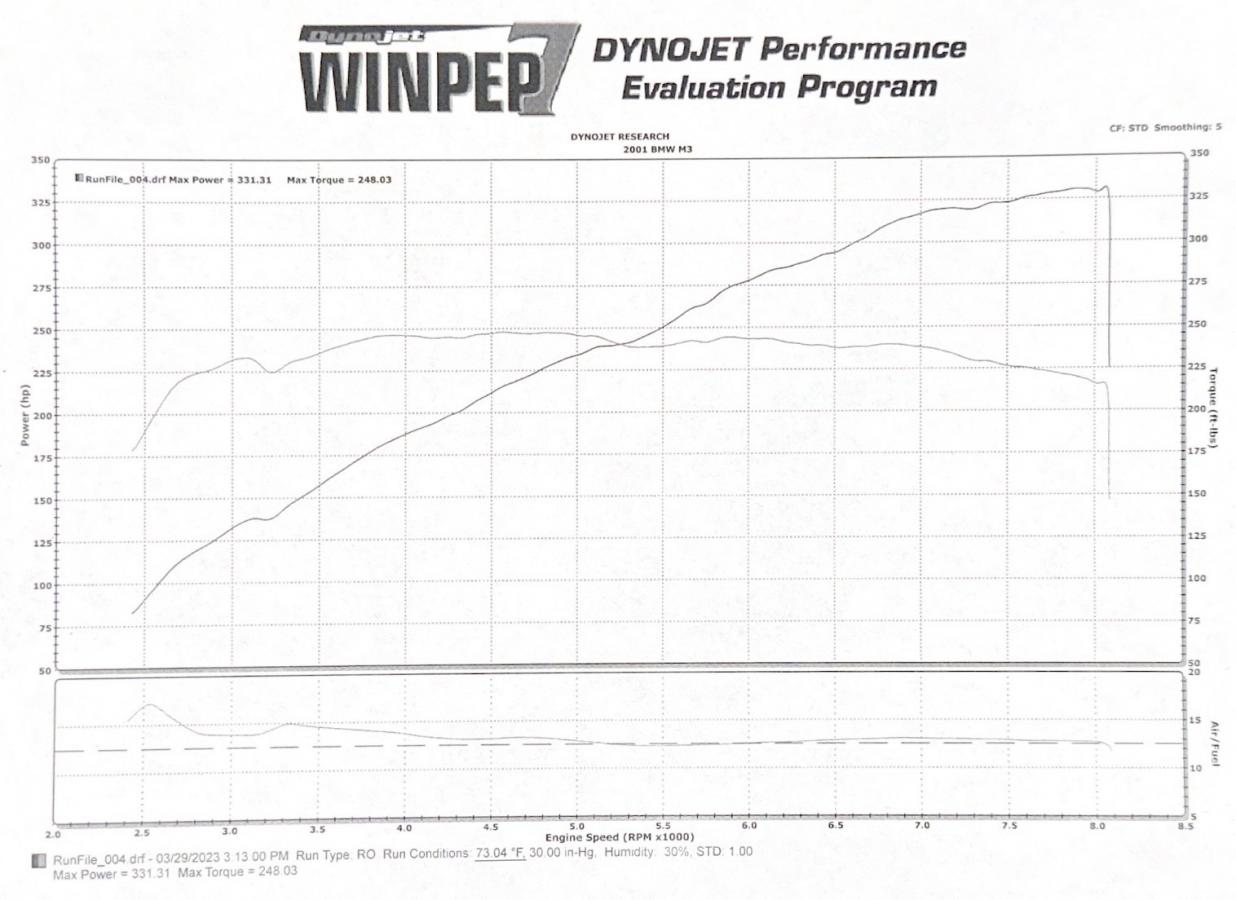

    2001 M3 w/ 107k miles
    Supersprint V1 headers
    Supersprint V1 catted section 1
    Supersprint 63.5mm dual resonated section 2
    Supersprint Sport muffler
    Karbonius CSL Race airbox
    OE CSL air filter
    TMS IAT relocation w/ US IAT installed on stock lower intake duct
    HTE Performance AlphaN tune
    SPAL fan (both OE fans deleted)
    Bosch 62431 386cc injectors
    265/35R18 tires (idk if that matters much)
    If anyone has suggestions on how to address the dips, esp the one at 5250ish, please lmk.
    Click image for larger version  Name:	32FC7A31-49BB-4337-8BBC-F658570C9024.jpg Views:	0 Size:	98.2 KB ID:	211964

      I think that dip may be due to your cat. Torque should naturally dip at 5252 because it's the crossover point between horsepower and torque. Overall though your torque band is almost flat and horsepower doesn't seem to flatline up top so I would say overall it's making great power. Do you have the SAE corrected dyno charts by chance?

        the dip at 3250 seems like it is too lean based on the AFR. im not sure the 5250 is something to worry about

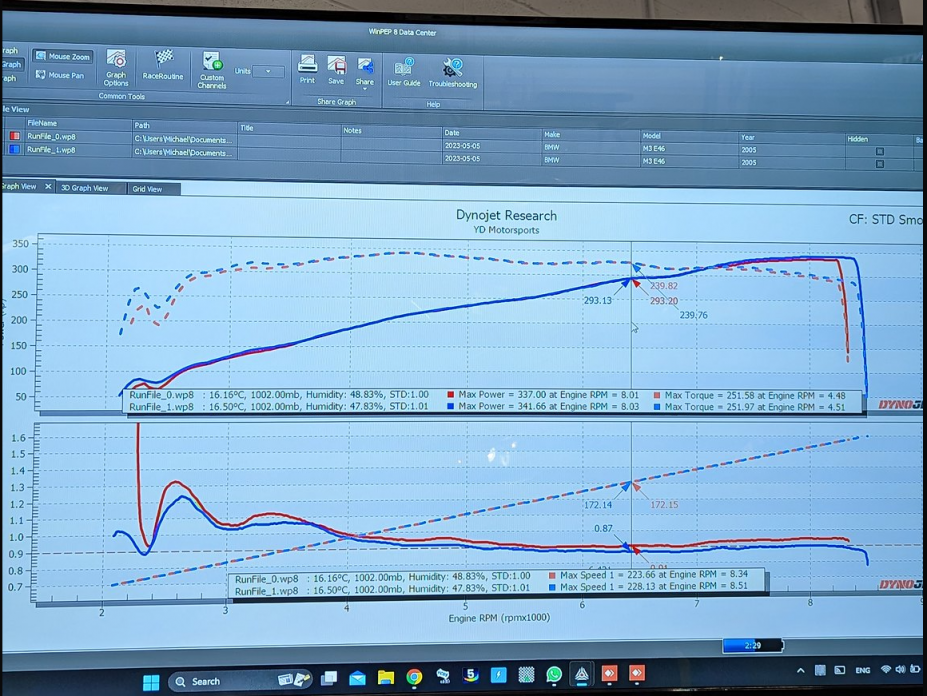

                  Basically round 3 on the dyno, and 3rd time with HassanEido HTE.
                  Mods since last dyno session:
                  • Spal 2049, aux delete
                  • Schrick 280/272
                  One the same rim and tire setup as in the sig. Previous setup without the above was 329.6whp/250.8wtq also done on DynoJet as was this. Unfortunately the place I went to last has gone out of business. For comparison sake, all the dyno tuning has been done on different dynojet. Doesnt mean much but its something.
                  Baseline runs:
                  Final numbers below, 347.6whp/257.5wtq. 11 revisions, cant thank Hassan enough always does amazing work.

                  Sounds decent.

                        That's a nice gain despite the dyno difference.

                          So 7-10 hp and 6 ft*lb of torque for 280/272 cams? That is an interesting data point and makes cam upgrade a pretty tough sell
                            repoman89 I think you misunderstood the final numbers. 329 vs 348 and 251 vs 257. Also different dyno, different days etc etc etc. Even with no tune, car on part throttle was a different beast. When doing cams, it just underlines other probable weak areas of the top side of the engine. In my case cyl 6 exhaust followers and maybe aging vanos components (?).
                            The power is most definitely felt. Pistons and rods would bump that up another 10-15 maybe but thats crazy low return for the investment required money and time wise. Either way its nice to look forward to. Now Im more concerned with the over all health, just doesnt sound good. Although I have no power loss, and zero codes.
                            EDIT: I see you took the baseline numbers, those runs were with cams just no tune.
