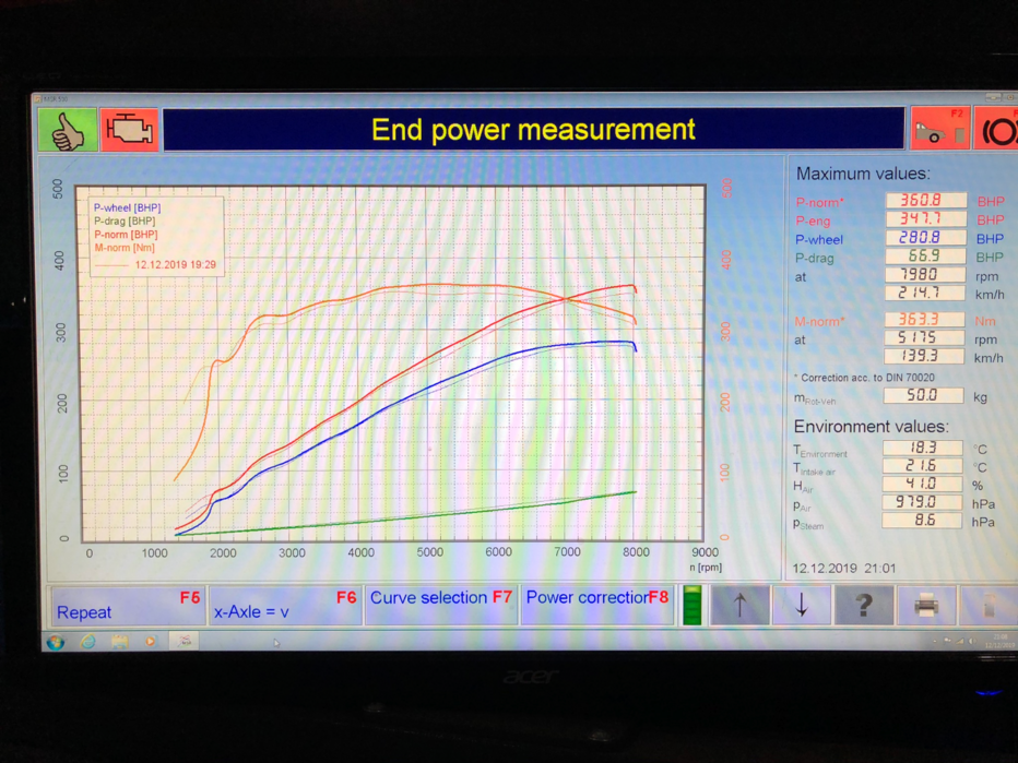

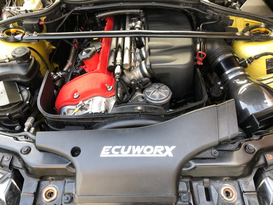

          - Euro 2004 E46 M3
          - Milltek Center Section
          - RM Motors Decat
          - Stock Rear Box
          - Eventuri with air temp bung
          - AEM ECU

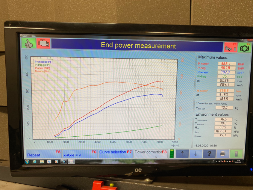

          Click image for larger version  Name:	Eventuri-Stock-Elbow.png Views:	0 Size:	951.2 KB ID:	35295
          Click image for larger version  Name:	Tuned-Pre-Cams.png Views:	0 Size:	918.8 KB ID:	35286

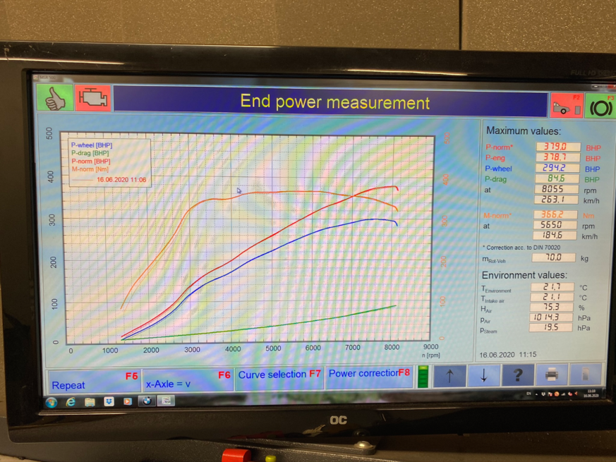

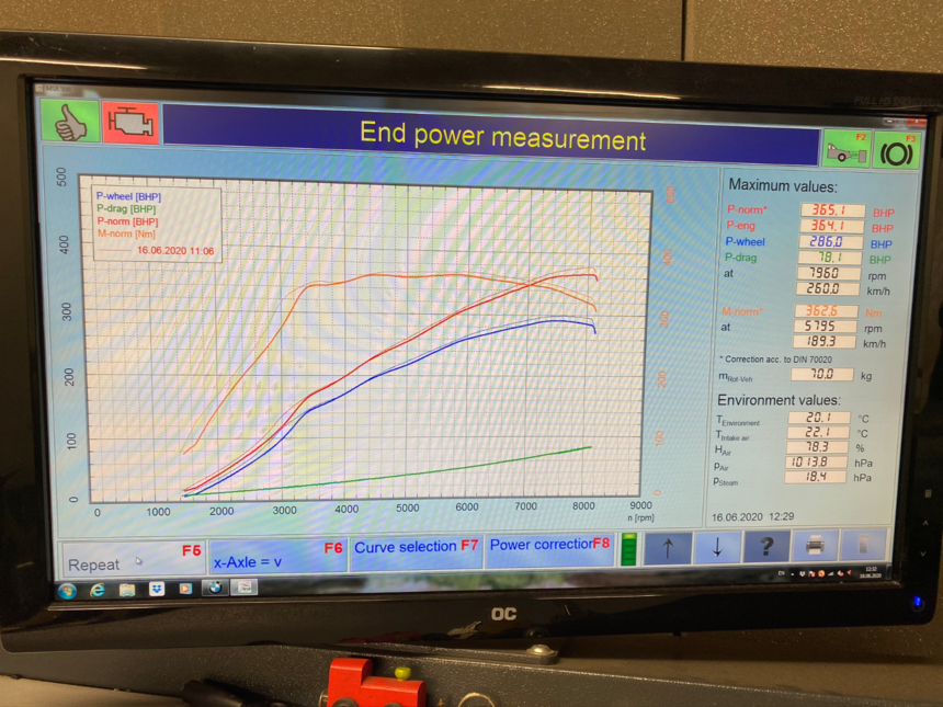

          I then added the following:
          - CAT 272/280 Cams with BMW DLC coated followers
          - Siemens Deka 60lb Injectors
          - Radium Fuel Rail
          - No tune changes other than injector scaling
          Click image for larger version  Name:	First-Run-No-Tune-Cams.png Views:	0 Size:	898.6 KB ID:	35289
          Then with tuning
          Click image for larger version  Name:	Tuned-Cams.png Views:	0 Size:	916.5 KB ID:	35288

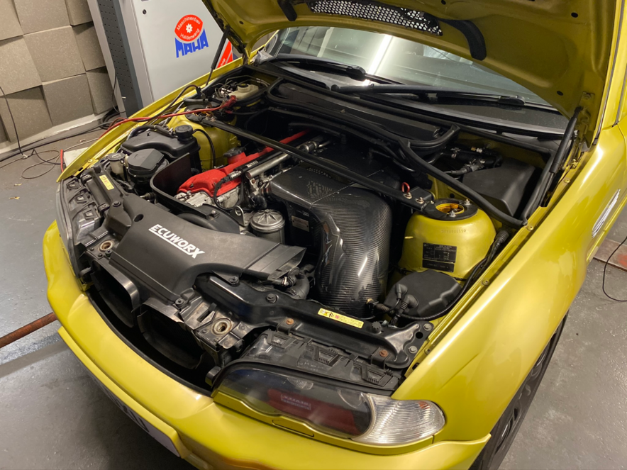

          Then I fitted the Evolve Carbon Intake
          Click image for larger version  Name:	airbox_fitted.png Views:	0 Size:	969.6 KB ID:	35290
          Then ran the car again, with no tune changes!
          A loss almost everywhere!
          Click image for larger version  Name:	loss-with-airbox.png Views:	0 Size:	919.5 KB ID:	35291
          Then with more tweaking:
          Click image for larger version  Name:	airbox-final.png Views:	0 Size:	193.2 KB ID:	35294
          So, not quite the result I was expecting with the airbox, however I did pick up more midrange, and chunk up top along with more torque from 3.5K onwards.
          Overall, it seems that the stock plenum is VERY well designed and adding CSL style air boxes don't always mean more power!

                                Stan,
                                Read the Dyno with cams and box etc.
                                Do the math and you will see how much the dyno calculation will never make sense to you.
                                Rear wheel 294rwhp. Crank says 378 BHP (crank HP). So, 378-22%= 294rwhp.
                                Hope this will make more sense to you ?
