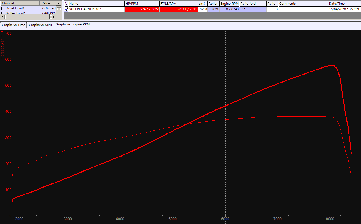

                          Lets not start another dyno vs. dyno numbers debate - too many variables to compare from one to another. Numbers differ, dynos differ, they all have their positives and negatives. I personally prefer a braked dyno that can control ramp time to simulate actual road acceleration vs. a large inertial roller as per DJ which can't be controlled (on most DJ, anyway) - then you end up with acceleration times of the power run that differ from real world conditions. That load/acceleration difference can lead to inaccuracies in the tune when the car hits the road or track, especially for turbo/boosted setups. As for the coast down debate - it's exactly that, negative losses on coast down from ending RPM which is added to the curve to calculate for flywheel. How the dyno uses those measured losses can differ, but either way it's the most accurate way to determine transmission loss vs. a fixed correction factor.
                          Anyway, here's one from my own Dyno, on my own track car.
                          -Supercharged @ 10psi boost
                          -Schrick 288/280
                          -Euro Headers
                          -2.5" Dual Section 1, 2 - decat
                          -SS LWR rear silencer
                          -Shite local fuel
                          -AEM Infinity Standalone
                          575HP / 379lb/ft TQ
                                -Schrick 288/280
                                -Euro Headers
                                -Shite local fuel
                                575HP / 379lb/ft TQ

                                Nope, we’re def not going there! ...and nice Paul! Looks like a strong runner!
