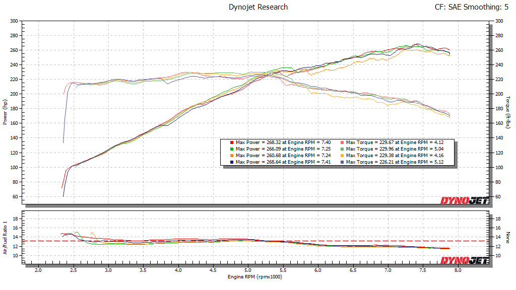

    My car is completely stock right now, so took it in for a baseline dyno run.
    Here's the setup:
    • 126270 mi
    • 100% stock US spec pre-facelift M3
    • Converted MSS54 running stock 2501 HP software
    • All engine maintenance done
      • Rod bearings replaced ~13k mi ago
      • VANOS done ~13k mi ago, passes VANOS test with no issues
      • Engine retimed ~2k mi ago
      • Valve adjustment done ~2k mi ago
    • No mechanical fan, just aux
    • Dynoed at Sonoma racetrack so altitude is ~sea level
    • 70ºF ambient temp
    • Dyno said 50% humidity, weather app said 90%, so unfortunately no clear answer for that
    • All O2s are original, got new ones in a box ready to go in when my V1s arrive, but potentially left some power on the table because of this
    • Running Shell V-Power 91 octane

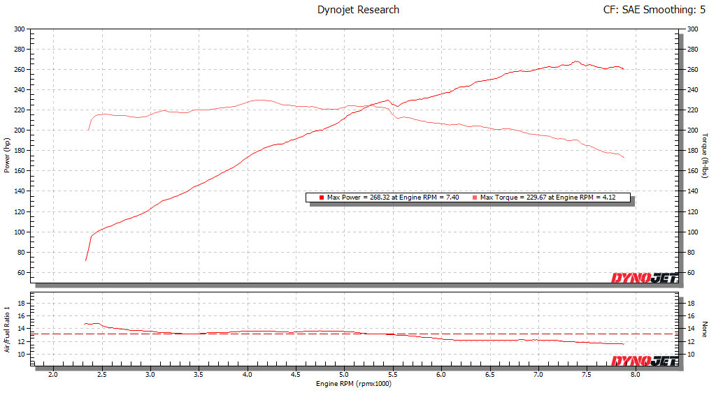

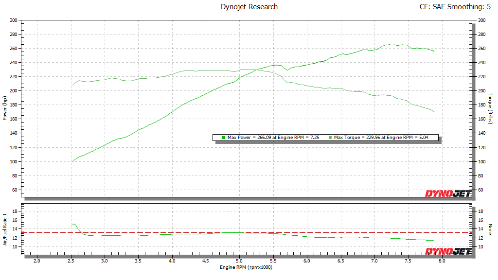

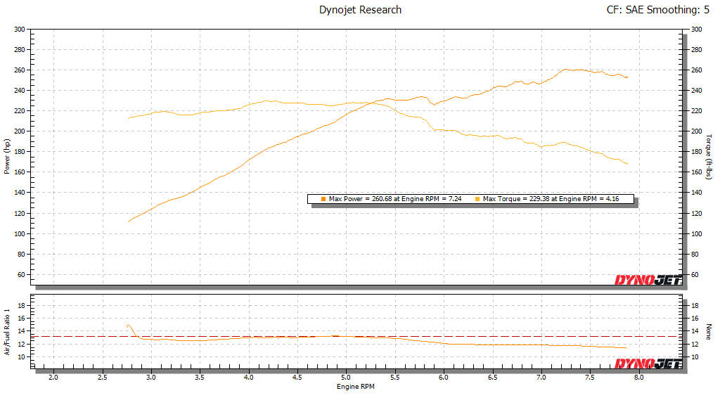

    Click image for larger version  Name:	All Runs.png Views:	0 Size:	59.7 KB ID:	118155
    269 max WHP, 230 max WTQ
    First three runs were done back to back with one fan flowing air into the radiator. Fourth run was done after letting the car cool down for ~5 min and pointing another fan at the driver's side fog light area. I've attached all the individual runs to this post in case anyone wants to take a look at them.
    Results were pretty much exactly what I was expecting. I think I told the dyno operator I was expecting to see 270 WHP. I'll be back when I get my CSL airbox back on and then back again when the V1s go on to get a full dyno tune.

      What fuel?
        If it was near any sort of climate control, I would suspect that 50% is closer to being accurate.
          What fuel?
          91, forgot to mention that. I'll update the post.
          Shop door was wide open before the dyno runs, but yeah I'm inclined to believe it was closer to 50%.
            Nice, about what I would expect on a DJ from a stock M3...seen them anywhere from 260-280-ish stock. Should see some nice improvements from the V1's and a tune! Thanx for contributing to the database!

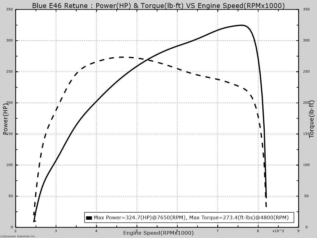

ID:	121383 Here is the dyno at TTFS. Baseline was 305 ish whp, but the line is not on this chart.
                            Power mods: Supersprint V1, Hi flow cats, oem sec 2, race muffler, Rogue power pullies.

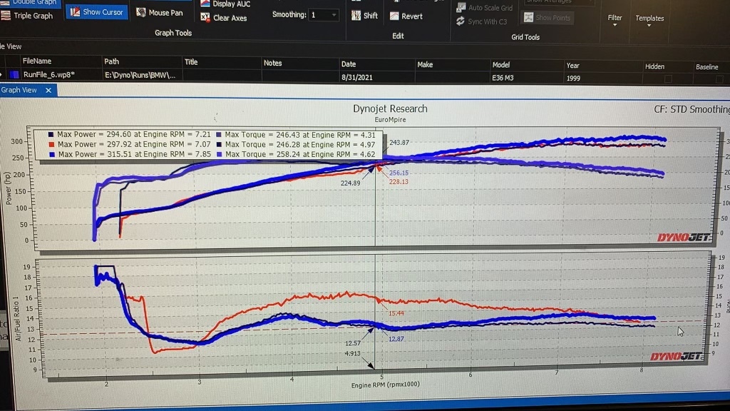

                              S54 E36 M3 with stock US headers, bimmerworld y-pipe, Stromung muffler and Karbonius intake on an HTE Alpha N tune.
                                Pretty strong numbers for stock US headers...thanx for adding to the database!
