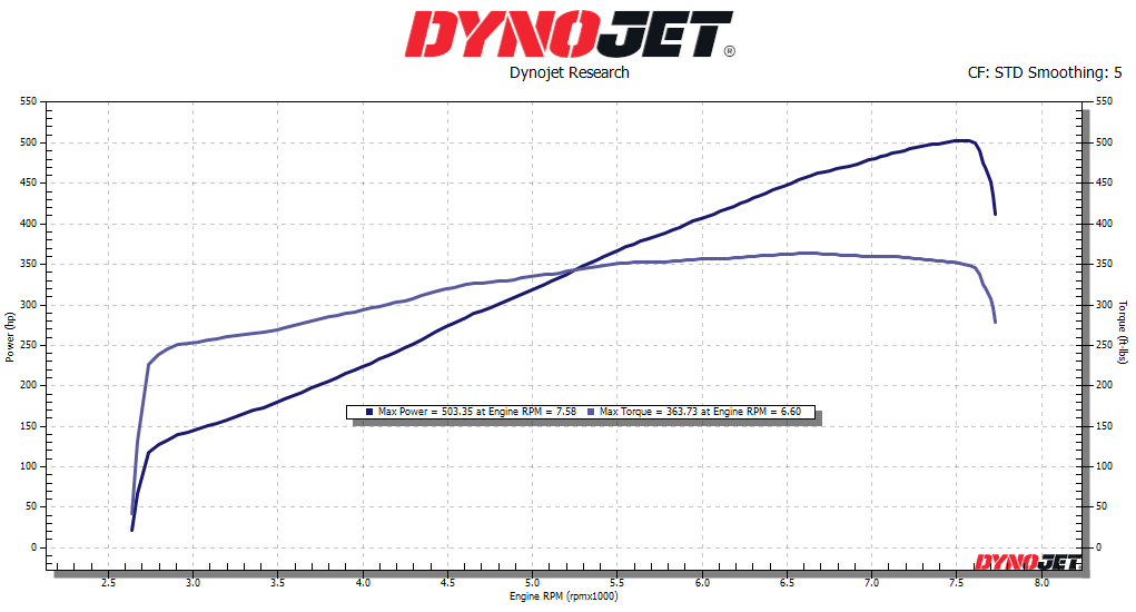

          Recent dyno from custom multi-map tuning with E50 and AA SC.
          Would be interested in seeing what Hassan and Nick could do with the same setup...

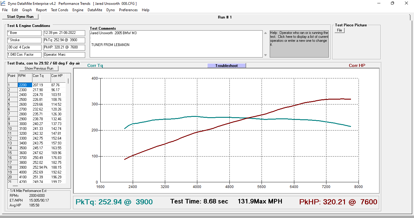

                      Finally got on the dyno today with Hassan,
                      There’s not much in terms of performance shops and dynos around me, the shop I was at has a custom in floor dyno, whatever that means.
                      Mods:
                      Turner v2 CSL Airbox
                      SGT headers
                      SGT section 1 with 100 cell cats welded in
                      Stock section 2
                      Active Auto Gen 6 Section 3
                      Base pull with a base map from Hassan was:
                      292whp and 230wtq
                      Final pull was:
                      320whp and 252wtq
                      AFR 12.5-13 a little richer in the midrange
                      Was pouring rain here today, so the car just wanted to spin the wheels, but it pulls very nice. Big difference over the base tune too. Very happy with the driveability.
                      Now goin in for rod bearings and vanos bullet proofing in a couple days while I’m on vacation
                      Click image for larger version  Name:	FFEC2F92-7B44-4AC7-A9F8-50B4BD63E759.png Views:	0 Size:	35.5 KB ID:	173104

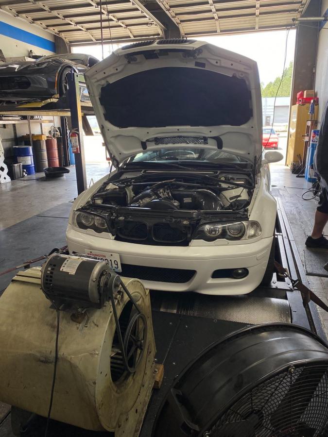

                        Got my car on the dyno with Hassan on Tuesday as well.
                        Mods:
                        Evolve CSL Airbox
                        280/272 Shrick Cams
                        SSV1 Headers
                        SS 63.5 Catless Sect 1
                        SS 63.5 Dual Res Sect 2
                        Dixis Muffler
                        Turner Pulleys
                        Car has 83K miles on it and has the big 3 done.
                        Base pull w/CSL tune: 292 WHP
                        Max Power: 310 WHP
                        Drives a LOT smoother now than it ever did with the CSL base tune.
                        Click image for larger version  Name:	E46m3Dyno.png Views:	21 Size:	492.4 KB ID:	173381
                        Click image for larger version  Name:	E46M3OnDyno.jpg Views:	0 Size:	100.9 KB ID:	173378

                          Something is not right.
                            My thoughts as well, I'm planning on checking the timing this next week to see if something is off.
                              Car should be dyno'ing 350-360whp with those mods and torque in the 260s lb/ft, something definitely wrong and especially on such a low mileage.
                                What's the elevation and ambient temp during these pulls?
