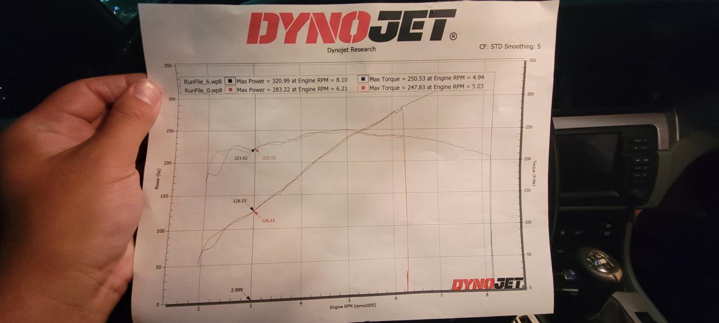

    So in preparation for installing my new setup (SSv1s+63.5mm matching section 1 and 2+CSL Airbox), I finished tuning my current "basic" setup by jumping on the dyno at EAS. Since a lot of E46 M3s run on this dyno I thought it'd be a great opportunity to baseline this setup, compare to other M3s and see what the more advanced setup offers over the cheaper Euro headers and Eventuri intake.
    Engine Mods:
    Eventuri intake + upgraded intake elbow
    Euro OEM headers
    Bosch 550cc injectors
    Walbro 485 fuel pump
    Modded OEM section 1 (added AR20 resonator)
    Supersprint section 2 resonated
    Dixis Spirit titanium section 3
    HTE E85 dyno tune
    Engine mileage: 232k miles
    Unfortunately it was breaking up a bit up top so we ended with 321 whp/250 wtq and Hassan suggested changing spark plugs and coils (since they've been beaten on for about 25k miles) and we would end up with about 330 whp. A stock E46 M3 dynos around 270-280 whp on this dyno so getting another 50-60whp over USDM stock with intake, Euro headers and E85 tune is really amazing for not a lot of dough. The midrange and top end vs a stock setup/tune M3 is night and day, while the low end feels stout and accessible.
    I'm hoping to break 360 with the SSv1s + section 1 + section 2 twin tube and CSL airbox. Once I install all of that I'll head back to EAS in the next few weeks and do a full Alpha N retune. It is honestly mindblowing to me how much more power you can pull out of a 3.2L N/A setup with such simple modifications, especially one with 232k miles. Once I finish with Setup #2 I'll get some 280/272 cams and do one final retune.
    Thanks for reading. 🤙 Big shoutout to Hassan at HTE for being a wealth of knowledge and support. If you need your M3 tuned, he is superb.

      Looks like a very healthy high mileage M3, and thanx for contributing to the dyno thread!👍

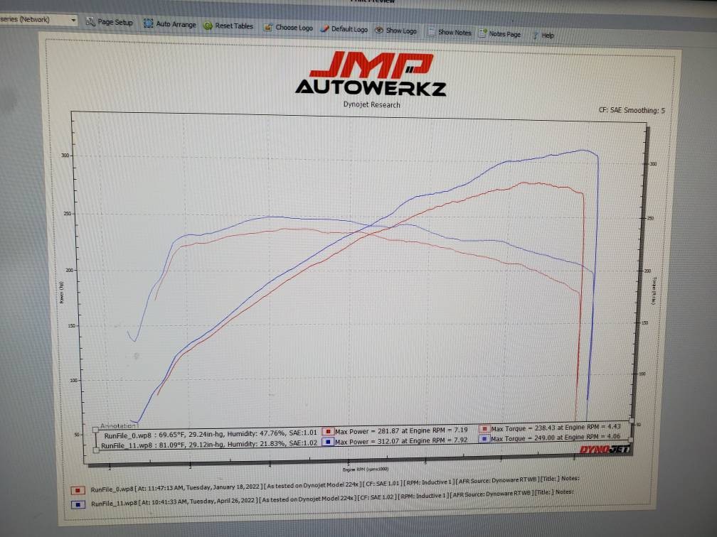

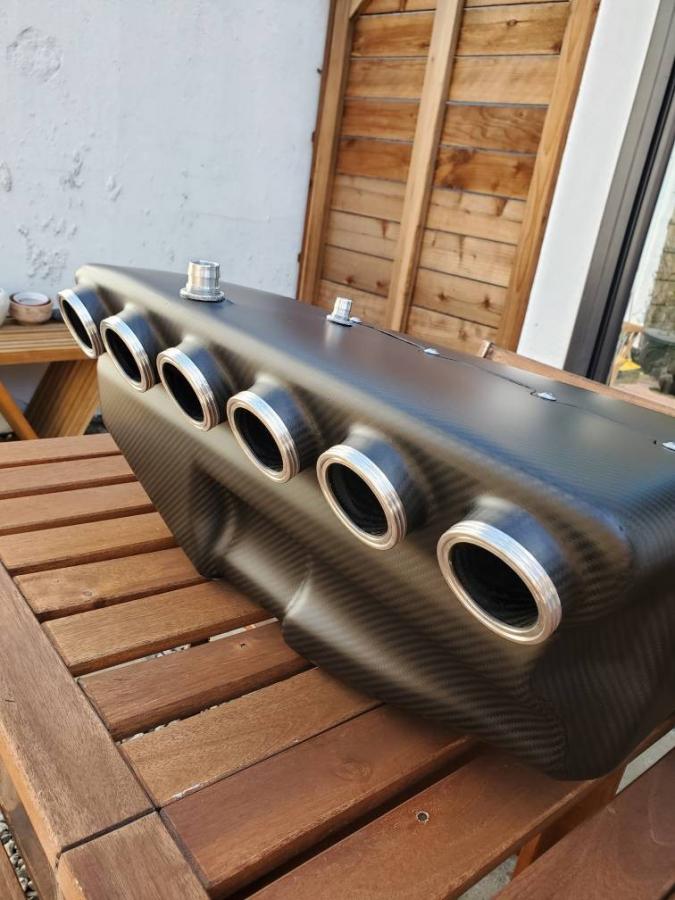

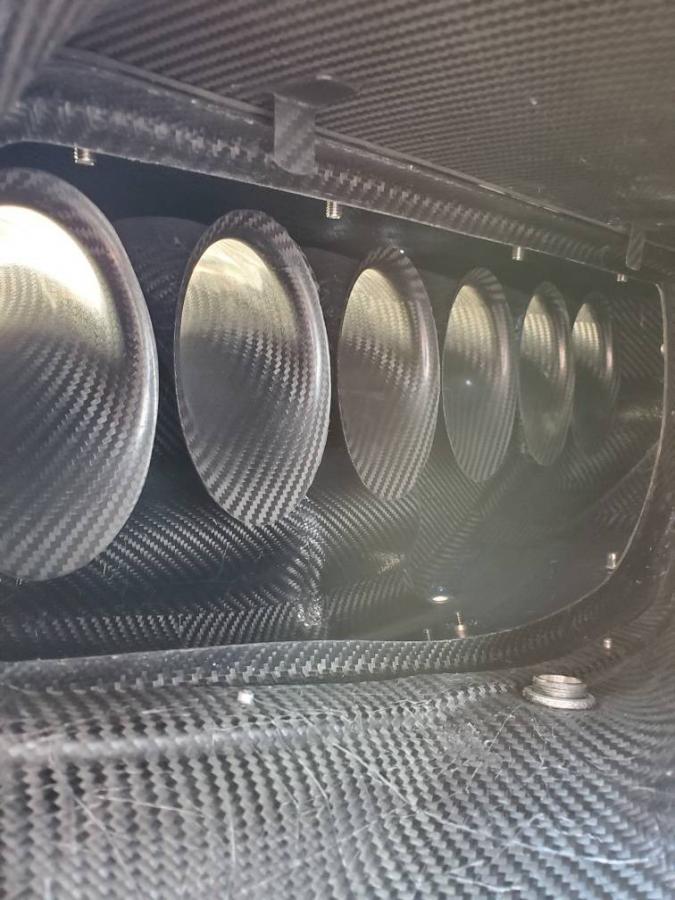

                  Reposting from the airbox thread, just got this thing dyno tuned:
                  Dyno baseline, stock airbox, stock tune, stock cams, CPI stepped headers, resonators but no cats, RE El Diablo section 3 - 281 whp, 238 wtq
                  Haimus box installed, alpha N remote tune from Epic, everything else the same - 312 whp, 249 wtq
                  Probably not the healthiest stock motor, 175k miles on it, but I’m satisfied for now.

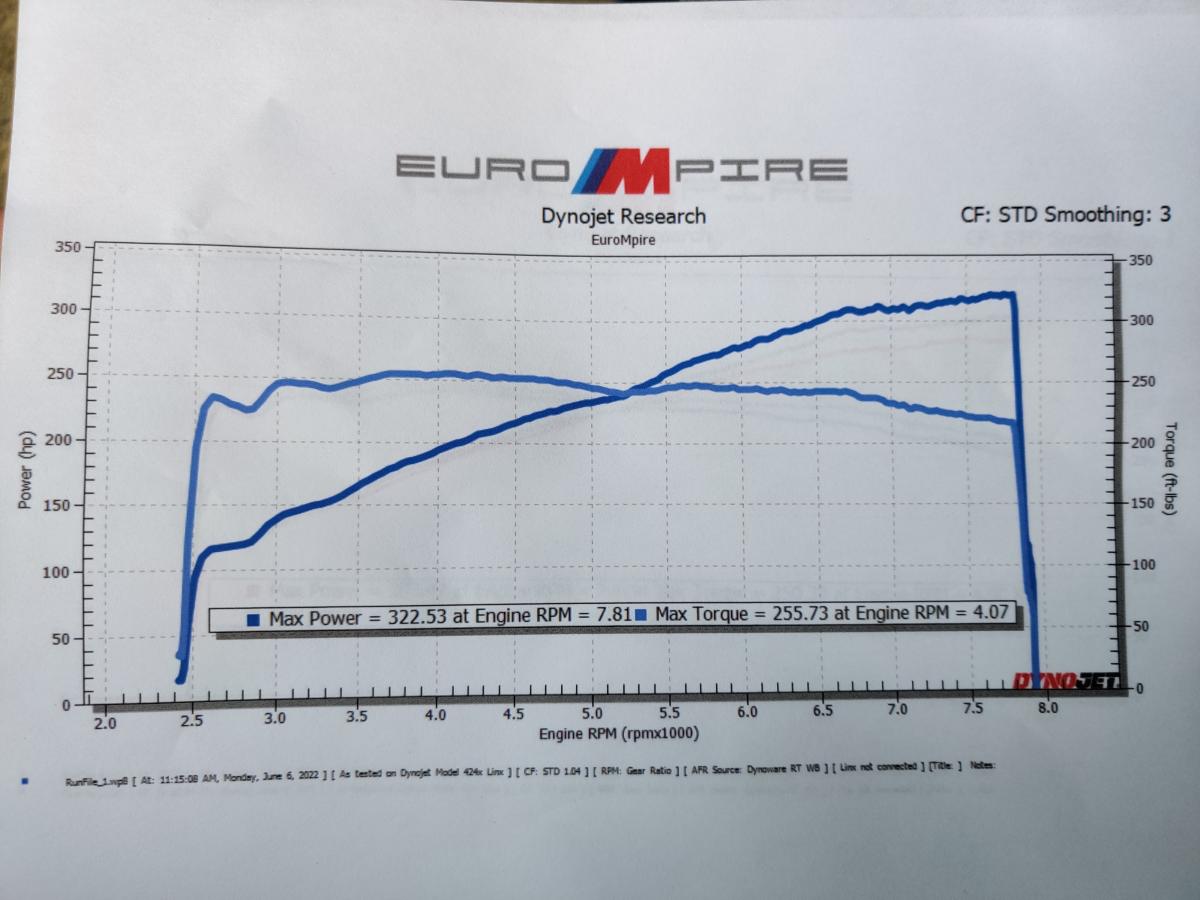

                    Just had Hassan tune my car remotely on EuroMpire's Dynojet.
                    Mods:
                    • Agency Power headers
                    • Fabspeed Section 1 with HJC cats
                    • SuperSprint Section 2 resonated - oversized dual pipes
                    • SuperSprint Section 3 - Race (too loud but fun)
                    • TMS Street pulleys
                    • Karbonious matte intake (I'm told it's worth 10hp over gloss)
                    • BMC OEM CSL filter
                    Results: 322.53rwhp / 255.73rwtq
                    EDIT #2: Baseline pull with full CSL code: 303.47rwhp / 250.38 rwtq
                    Granted, I have stock cams and I don't have a 'CSL' emblem on the boot lid...
                    Drivability so far is perfect. My god that intake sounds effing glorious. No idea why I waited so long to do this mod.
                    I'm super happy with these numbers for just a couple of bolt-ons. It does have me kicking myself for not going SSV1 headers and section 1, but something to look forward to. I may go cams and those at some point down the road, but extremely happy for now. Considering I just dumped somewhere around 100lbs off the car, it feels pretty missile-like. I'm diggin it!
                    -Casa
                    EDIT: Dyno graph below. I tried to upload the below pic to this post originally. I typed this post on my laptop (hate typing on my phone) and then thought I was adding this pic to the edited post from my phone...

                      Dyno graph for above post.

                        Bruh that ain't a real dyno, du just drew that with a sharpie.

                            Good gains. Well done.

                                Awesome numbers and gains. HTE really dials the car in on the dyno, night and day vs base map lol.
