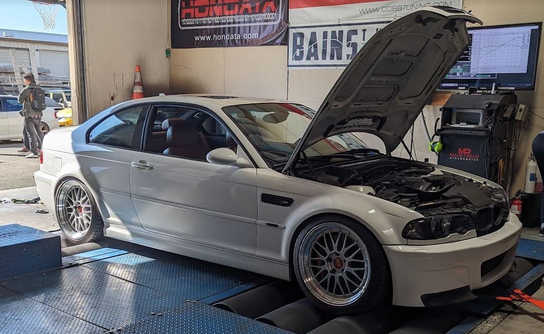

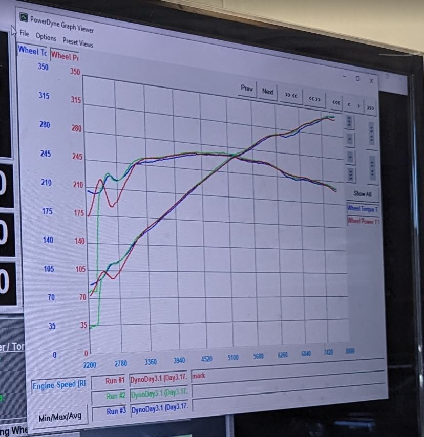

    2004 E46 M3 - 169k miles
    Karbonius CSL airbox w/ carbon snorkel (Stock CSL IAT in original location)
    Euro Headers and Section 1
    Supersprint Race Section 3
    Kassel Performance MSS54HP Full CSL hardware/firmware conversion
    Kassel Performance ECU tune
    Kassel Performance MAP sensor kit
    91 octane
    Recent Maintenance:
    Rebuilt VANOS w/ Beisan exhaust hub
    Rod bearings replaced with ACL bearings
    New o2 sensors and spark plugs
    345whp, 271wtq - Mustang Dyno
    Click image for larger version  Name:	dyno_stance.jpg Views:	0 Size:	208.1 KB ID:	258584
    Click image for larger version  Name:	dynoplot2.jpg Views:	0 Size:	125.9 KB ID:	258585

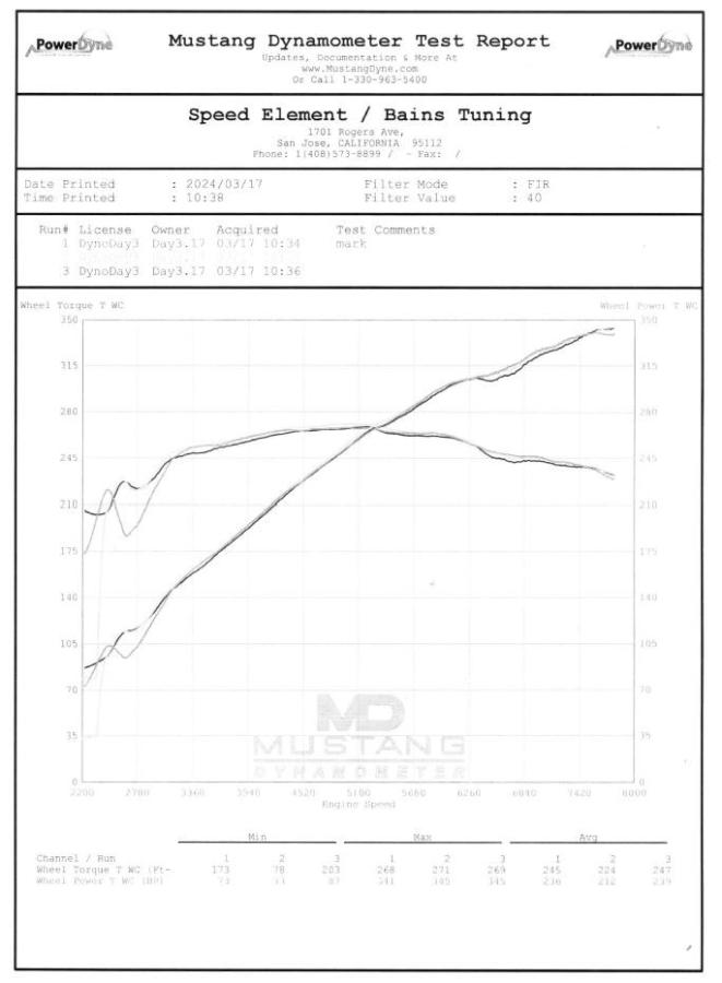

      Nice. I'll be running close to the same setup except a full SS 63.5MM headers-to-exhaust (Dinan Section 3). Excited to see how it performs before cams.
        Looking for feedback on this run:
        • Trace looks lumpy 4500-5500 vs other smooth traces here, but car seems to run fine.
        • Power tapers off at 7000RPM
        I always felt Kassel 'phoned it in' during the remote dyno tuning. I was renting dyno time and Kassel took a loooong time between runs to get back to the tuner because they were busy with other customers...which got.. expensive. Does this all look normal to you?

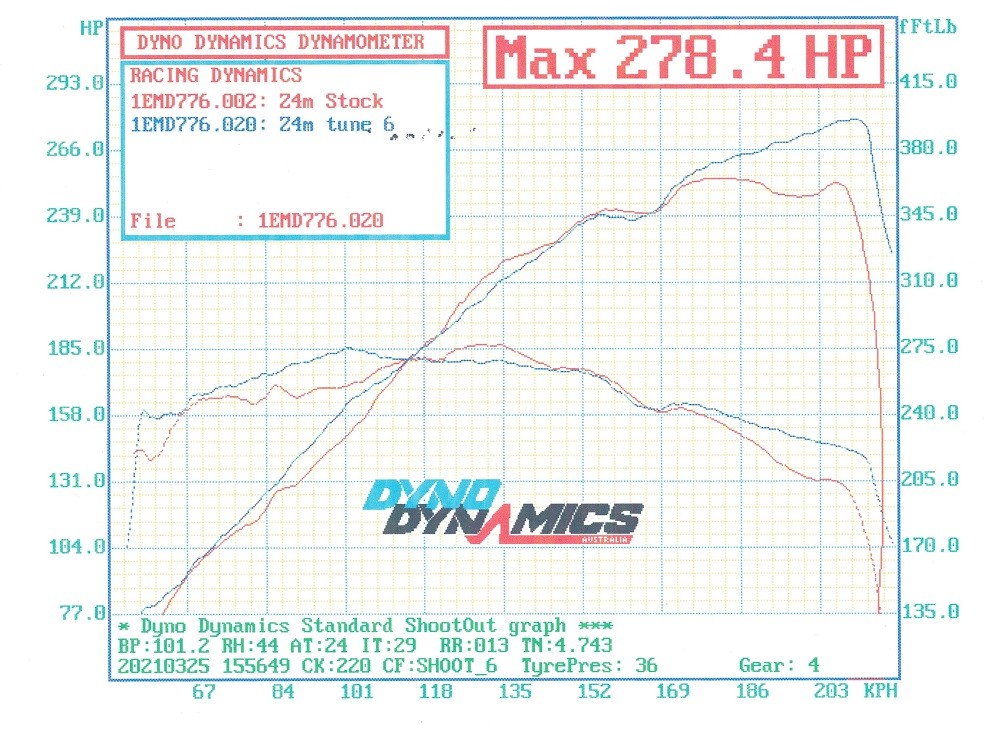

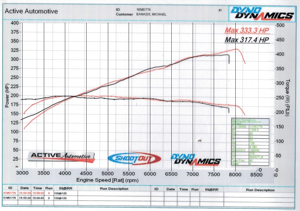

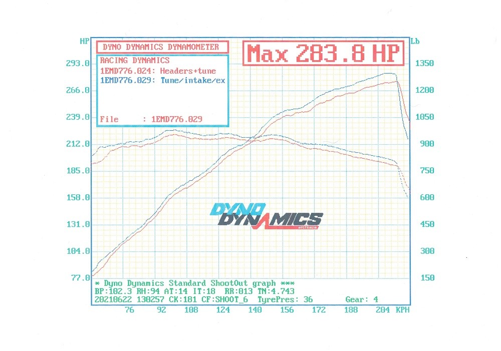

          Car: Australian (right hand drive, Euro-spec) E86 Z4M Coupe, 28,000km for 'stage 1' and 40,000km by the time I got to ‘stage 3’.
          Chart 1: stock versus ‘stage 1’ of Supersprint V1 stepped headers and cat’d s-pipe and a tune by Severn which included data logging on the street and multiple revisions (this is the sixth iteration of the tune). Note that the V1 headers do not clear the steering shaft for RHD cars, so the workshop modified them to fit. Not sure how much worse they are after modification, but they did still make more power high in the rev range than the already very nice Euro-spec headers, even without a tune.
          More description here:
          ​https://www.zpost.com/forums/showthread.php?t=1816109
          Click image for larger version  Name:	2021 Mar - stock vs headers and tune 6_SML.jpg Views:	0 Size:	204.2 KB ID:	267499
          Chart 2: re-baseline dyno of stage 1 vs ‘stage 2’, which was the addition of SS x-pipe, Powerloop mufflers and an Eventuri intake. No re-tune for stage 2.
          More description here:​
          https://www.zpost.com/forums/showthread.php?t=1868864
          Click image for larger version  Name:	2021 Jun - Header tune 6 vs full exhaust intake and T6_SML.jpg Views:	0 Size:	145.5 KB ID:	267500
          Chart 3: re-baseline of stage 2 but with the SS x-pipe removed (the rasp and drone were too much for me), the addition of the Karbonius OE style plenum and heavier wheels (BBS RG-Rs, which are about 1kg heavier each than the Advans I had on for the previous dyno runs) versus Karbonius CSL ‘race’ intake and Severn alpha-n tune based on quite a lot of data logging on the street and fine-tuning on the dyno (exhaust mods the same as stage 2).
          I changed dynos for these runs simply because it was closer to where I live. Also, I had to superimpose the revs x-axis from a different chart, so it looks a bit funny.
          ​https://www.zpost.com/forums/showthread.php?t=2100583
          Click image for larger version  Name:	CSL intake vs SS exhaust Eventuri and Karb plenum - Apr 2024.jpg Views:	0 Size:	189.1 KB ID:	267501

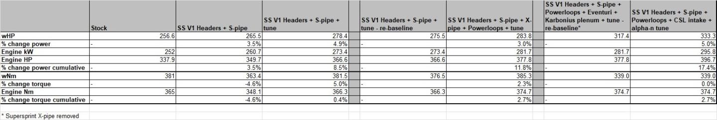

          Adding it all up results in about 17% power gain versus stock – see the summary table below. I have to say I’m tempted to do a cam upgrade but the cost is really high and I haven’t found any dyno charts showing the change just from 280/272 camshafts (happy to be corrected if someone can point me in the right direction). I have seen a dyno for 288/280 cams, but the gains were only from around 6,800rpm and I would really want power and torque increases lower than that or I would never notice.​ I'd love to see a dyno chart showing the change from 280/272 cams alone if anyone has one to share.
          Click image for larger version  Name:	Power gains table.jpg Views:	0 Size:	73.3 KB ID:	267502
            Is the last graph values at the crank?
              No - they're all measured at the wheels, without correction to calculate crank hp.

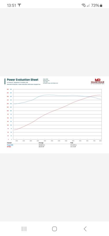

                      Click image for larger version  Name:	Dyno10.jpg Views:	0 Size:	21.2 KB ID:	270218
                      HTE tune,
                      Streamline/Haimus carbon airbox
                      Bosch 550cc injectors
                      Catcam 280/272 cams
                      Custom Performance Stepped headers, OEM euro cats & section 2, Eisenmann Sport section 3
                      4.1 diff
                      Aprox 312 at the wheels, roughly 370-ish at the crank.
                      Hassan did a phenomenal job live tuning it on the dyno, lambda is very good and car runs very nicely. Allegedly the mustang dynos in Europe are very strict when it comes to reported power.
                      Regards

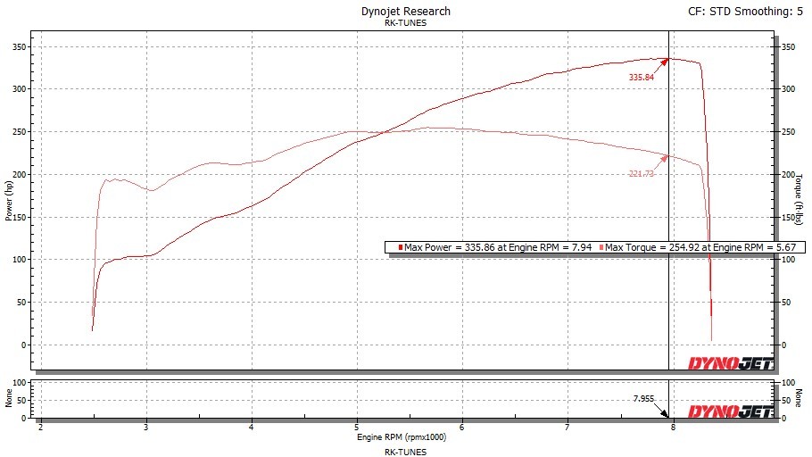

                        336whp / 255lb-ft on my ~80K mile engine.
                        Mods:
                        - CSL Airbox (Haimus)
                        - 280/272 Cat Cams
                        - Euro/CSL Style Headers
                        - Dinan High Flow TBs
                        - Eisenmann Muffler
                        - TMS Pullies
                        - Mishimoto Electric Fan
                        - RK Tunes / Alpha-N
                        - 93 Octane (various)
                          Mods:
                          - 280/272 Cat Cams
                          - Eisenmann Muffler
                          - TMS Pullies
                          More out of curiosity than anything, isn't this setup capable of much more? Is the limiting factor the tune? Or exhaust too restricting? Is this capable of 350+?
                            Its probably the exhaust setup.. Its very Frankenstein-like. I'm also pretty sure I have an exhaust leak somewhere.

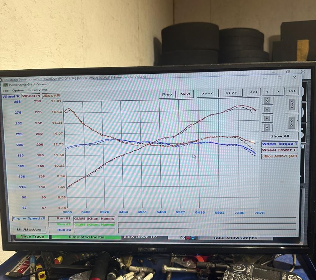

                              282 whp/215 tq on a mustang dyno
                              149k miles on the motor
                              -turner CSL box
                              ​​​​​​-SG catless headers
                              -SG catted section 1
                              -SG unresonated section 2
                              -SG SCZA muffler
                              -JB racing clutch and lightweight flywheel
                              -HTE tune
                              What does everyone think? Had to dump a lot of fuel into it as we were running super lean at first. Hassan was able to restore drivability, thing is a riot around the streets now.
                                -turner CSL box
                                -SG SCZA muffler
                                -HTE tune
                                it must be the dyno. i would expect those mods to make closer to 320.
