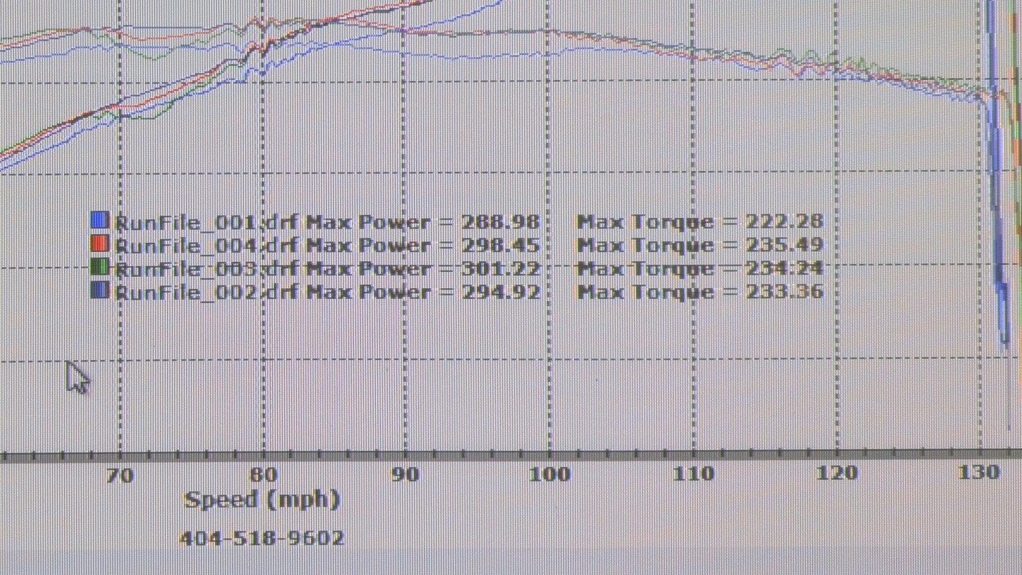

                      Went to the dyno few weeks ago to get a baseline before catless euro headers setup gets installed.
                      This is in my s54 M3 wagon.
                      Engine was completely torn apart on the engine stand for a fresh rebuild. Piston tops were cleaned, I even soaked and cleaned both camshafts rockers. Everything to get them that can brand new which was nice.
                      - ACL rod bearings
                      - new genuine BMW head gasket
                      - all new intake and exhaust valve stem seals
                      - all new gaskets and seals top to bottom
                      - complete Vanos refresh with beisan parts and all new lower timing chain guides, oil chain guides, o rings etc.
                      - valve adjustment
                      Mods are just
                      - Geoff steel V1 CSL air box with genuine snorkel and flap
                      - CSL stock tune
                      - SMG CSL tune
                      - stock US catted manifolds, stock section 1, 2 and CSL section 3
                      Final numbers were
                      301 whp
                      234 tq
                      Hoping for more with catless headers and an HTE tune
