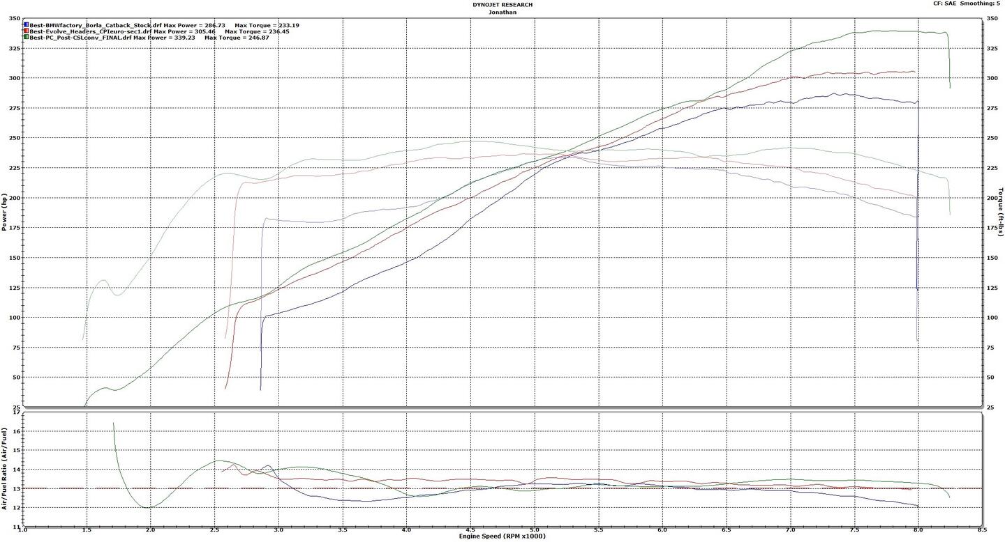

                      Finally getting around to posting my results to this thread. My build thread LINK
                      Here is a summary of the mods:
                      2005 ZCP w/ 155k miles at the time of the build.
                      Karbonius CSL Airbox (OEM trumpets) w/ OEM Snorkel and operational flap
                      Lang Stage 2.5 head w/ Supertech valves and springs
                      Schrick 280/288 cams, 12.5mm lift w/ DLC rockers
                      Port exhaust side of head
                      SS V1 stepped headers
                      SS catted section 1
                      SS resonated twin pipe section 2
                      SS race mufflers
                      Kassel Performance CSL ECU conversion
                      Kassel Performance MAP sensor
                      TMS underpower pulles, water pump and power steering
                      SPAL electric fan conversion
                      Turbo Toys V3 exhaust hub
                      Custom tune by Paul Claudes
                      91 octane pump gas
                      TLDR version; 340 rwhp / 247 rwtq on a Dynojet w/ 91 octane pump gas. More power on the table once I get 93 octane gas.
                      -- Dyno Curves --
                      Blue: Mostly stock, aFe Stage 2 intake, Borla V2 midpipes and mufflers
                      Red: aFe Stage 2 intake, AP V2 headers, CPI Euro section 1 w/ resonators, OEM section 2, Borla mufflers
                      Green: Final tune results from CSL airbox conversion, custom head build, and full SS exhaust (full list above)

                        ^^^^ Nice results man, and thanx for providing the detailed info!

                          Stash,
                          I think he is a bit down on power, 340 on 91 with ported head and same cams as yours is bit low..
                          I have a local tuner who did 339 on fresh std S54 engine put on Haltech Standalone which it
                          does not matter for power vs std DME.
                          DynoJet variation do exist but its minimal. Anyway, there is gain before and after which is most important.
                          From around 2500k rpms up to about ~6600rpm there is avarage around ~5-9rwhphp gain thru the curve
                          at 6300rpm there is 0 gain. It seems very little considering the long list of parts.
                          Regards,
                          Anri

                                Ehh, possibly, but even DJ’s can vary slightly from one to another, & it was tuned on piss water 91 octane...sooo, kinda hard to pass judgement. I’m sure it runs strong, and maybe it will surprise us when he re-tunes on 93. In the meantime, maybe he can go back & recheck cam timing to make sure there’s no issues there.
