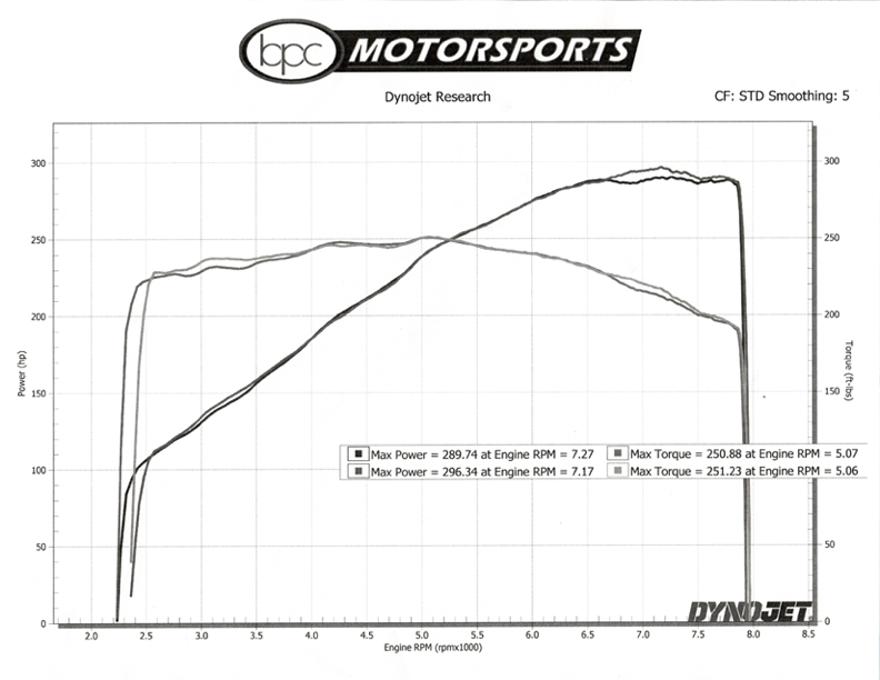

    I think I previously posted these files on M3forum but don't see my dyno graphs on this forum.
    Stock motor on 12-11-2014. Mileage: 155,530.​
Name:	2014-12-11 E46 M3 Stock Dyno.jpg
