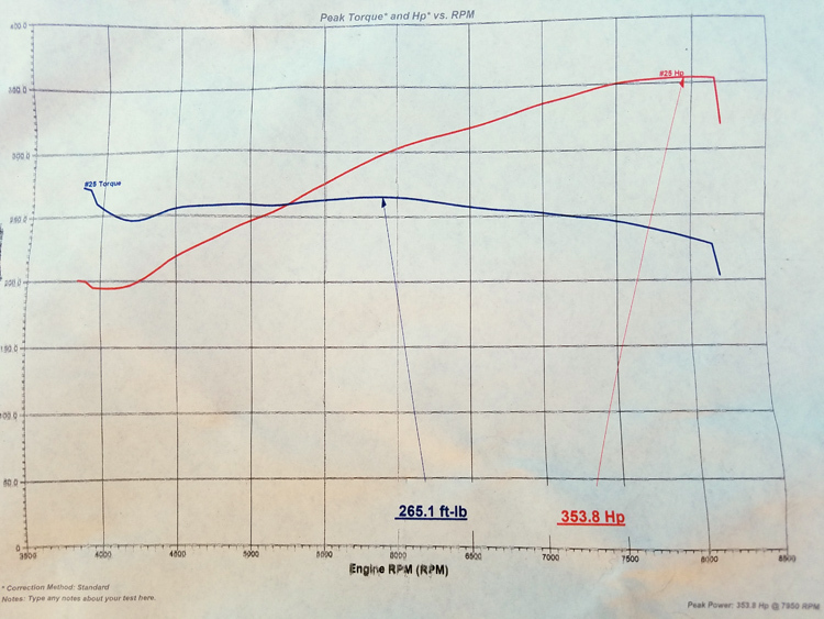

        I know its not an E46M3 but please allow me to share what I achieved
        with the S54 Love.
        - Intake and Exhaust camshafts.
        - CSL Box
        - "Budget" headers they are not really equal length....(measured them)
        - Crappy California 91 Octane gas.
        My concentration on the power was to dial the Mid-Range torque were we
        need the "kick"
        The camshaft timing brought the pick hp around 7650-ish so that it comes
        little earlier and keeps it flat to about 8150rpm and rev limiter is 8200+/- rpm.
        There is another 5rwhp with little tweak but no need to push the ticket on
        91 Cali gas..
        Chilled passes like 3-4mins between runs
        353.8 rwhp
        265.1 rwtq
        Hot passes one after each other.
        348.5 rwhp.
        259.1 rwtq
        Regards,
        Anri

          Hey Anri, very nice results for a budget build! Is this on a DJ? Sooo, no cams? Which airbox is that?
            Land and Sea

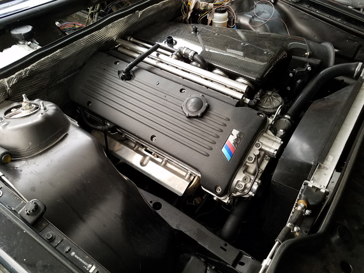

              Stan,
              - Karbonius box
              - Intake and exhaust performance camshafts
              - DynaMite is the Dyno I used which shows exact as the Dyno-Jet I use all of the time.
              I have done/tuned at least 15+ set ups at this specific DynaMite and next day at Jery's Dyno-Jet
              to check and the difference is 2-3hp which is subject to weather temps, air density from the night before
              and next day morning etc.I have over $2k in renting dyno time, tuning and comparing Dynos
              with same car, my preferred dyno is Dyno-Jet and why I tune on the DynaMite and next
              day I am Dyno-Jet.
              - Headers are modified
              - I forgot to mention I have 52m ITB's which ehhh...
              HP ECU converted to 1 Bar MAP/TPS which is what is used on CSL-S54 and very common on
              other engines.
              Stan brother, I worked hard to get this number....
              I have another S54 engine on the Stand and I told my other customer I just need little money
              and I am confident a hair under 360rwhp on 91 Cali gas Dyno-Jet number.
              See, not everything is HP, my target is to push the TQ hi as well...the ingredients must be proper
              otherwise the results are not there.
              Regards,
              Anri

                Who did your tune?
                2005 BMW M3 ZCP Black/Black - HTE Tuning | Kassel CSL DME | 288/280 Schrick Cams+DLC Followers | Lang Head | Dinan TBs | Bosch 550cc | Radium Fuel System | Karbonious CSL Airbox+OE Snorkel | SS V1 Stepped+Catted Sec 1+Resonated Twin Pipe+Race | 3.91, 3 stage clutch | FCM 400/600 | Vorshlag Camber Plates, RSM | Rogue ASP | AKG FCABs, SFBs | TMS Front Sway, Camber Arms, Monoball RTABs, Pullies | Mason Race Strut + X-Brace | AS 30% SSK | SPAL | Redish Plates | Turbo Toys V2 Hub | WPC Rod Bearings
                  Who did your tune?
                  Hi,
                  I work with a local tuner and we did the tune together.
                  Regards,
                  Anri

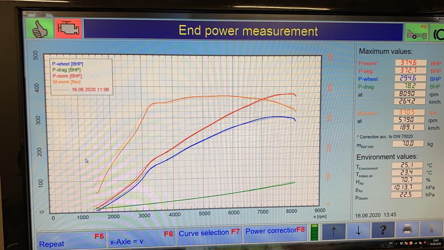

                        I saw a preview for this video on instagram. Im no dyno expert by any means so please forgive me in advance. Does Kassels dyno measure in wheel horsepower or crank?
                        My E46 M3 Finally Hits The Dyno!! (Fastest Stock S54?) - YouTube
                        Click image for larger version  Name:	dyno.jpg Views:	0 Size:	109.6 KB ID:	73097
                          Kassel has a Mustang dyno that normally reads about 3-5% lower than most Dynojets...assuming that nothing was changed for that particular run.
                          I’m waiting to hear from someone, but I’m calling BS on this until I can confirm-lol
                            everyone knows a stock S54 with tune is not making anywhere near 350rwhp legit
                              The owner is posting it on Instagram as WHP gains. That’s what made me wonder.

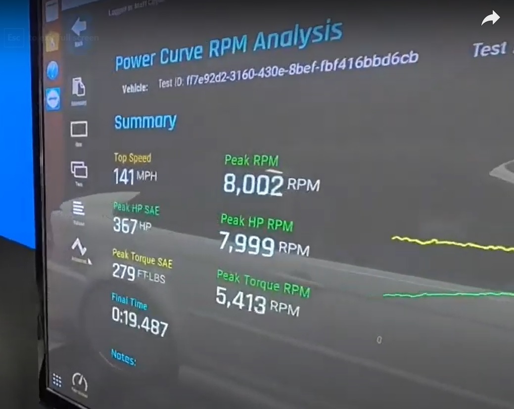

                                Its not the first time recently that I've seen some strong numbers from Kassel. Here is a clip where some figures are reported and being discussed on an S54 with stock cams (I set the clip to start around 6:25). I'd be interested in some analysis from those that are well versed in reporting numbers. At first pass, you think "really, 275 - 280 ft lbs?"
