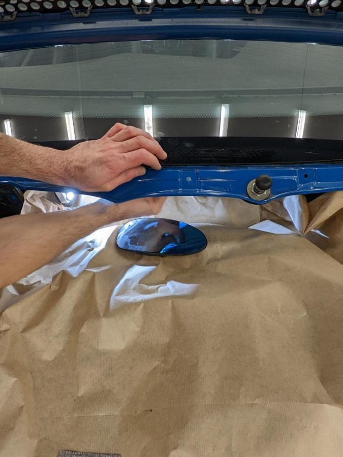

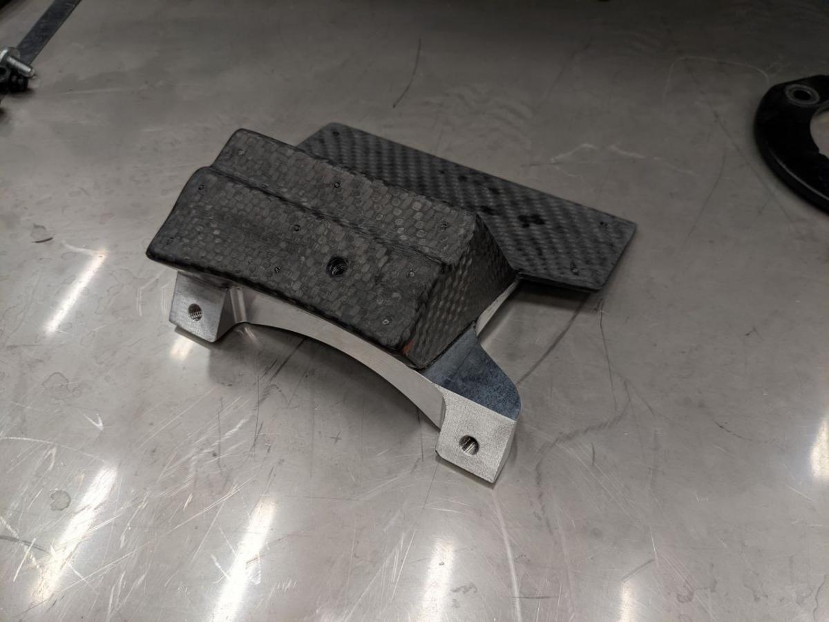

    I think this few pics from my phone will help a little
    first pic - bonding preparation process:
    Click image for larger version  Name:	IMG_20221212_005935_672.jpg Views:	0 Size:	68.9 KB ID:	195835
    center mount, which is bonded

    so this mount bonded to the chassis right under the windscreen (or above the a/c fan, if its easer)
      Thanks for those pics! Makes everything much clearer in my mind.
      What needs to come off to work on the engine? Does the entire brace come off or can just the carbon section come off?
      I haven't considered moving away from the stock brace because I take it off a lot. Those one piece braces seem like more a hassle. I guess you could take it off with the car on the ground, put the stock end pieces back on and then lift the car, but still.
        i know what you write about, and of course, there are some difference between unscrewing 4 nuts of the straight brace and leaving turret mounts on their places and to unscrewing 6 nuts of the top mounts. in our case with present design for removal the strut brace you need to unscrew 6 nuts of the top mounts and to unscrew 2 bolts of the center bracket.
        (removing of the cabin filter case goes in both options anyway).
        during developing i was faced with the choice, to get maximum usability during works under the hood, or, to move little bit far from OEM, but get more rigid design.
        i preferred to get last one, cause i'm targeting with this kit more for the street cars, rather than race cars, which more time stays in workshop disassembled .
        so, even if you doing works, which needs to remove the strut brace one time per month for example, to spend 5 minutes more, but have +20% of rigidity - for me the choice is obvious.​

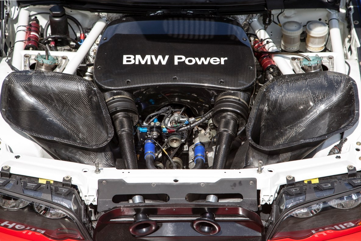

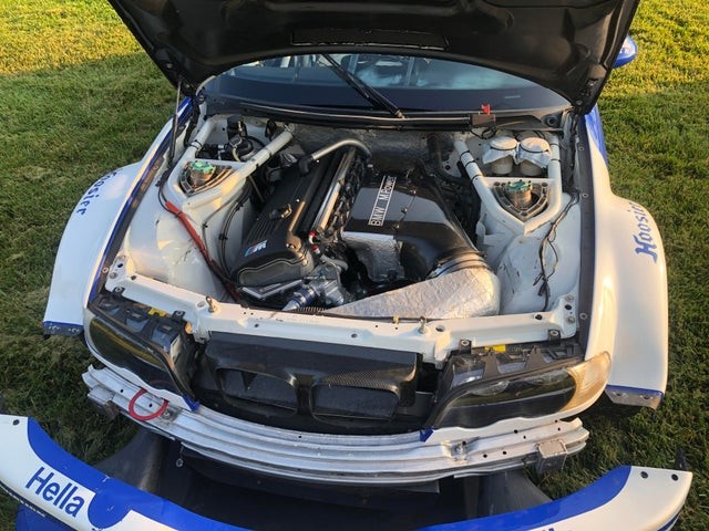

                                FWIW, this brace is effectively doing something very similar to these two cars.
