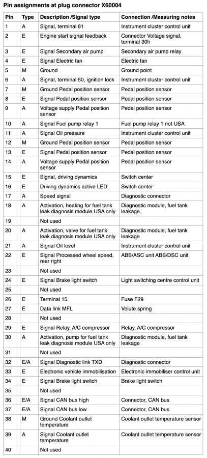

                  Okay, I’ve gotten everything wire up according to the instructions from the above post/links, except for the wire going to the DME. I have two different choices: Pin#37 or Pin#27. The written instructions say Pin#37 but that position is already occupied. But the Pin#27 slot is empty. So I’ve put the blue/black wire into slot 27. But before it hook up the battery cable and fry something expensive I would like to have confirmation that Pin#27 is the correct choice. Or are my directions wrong.

                    Here's the pinout for the X60004 connector on a late SMG car:

                    Looks like you want pin 27. Pretty sure "Volute spring" is referring to the steering wheel clock spring.
                      Thank you. I feel much better about continuing the battery now.
