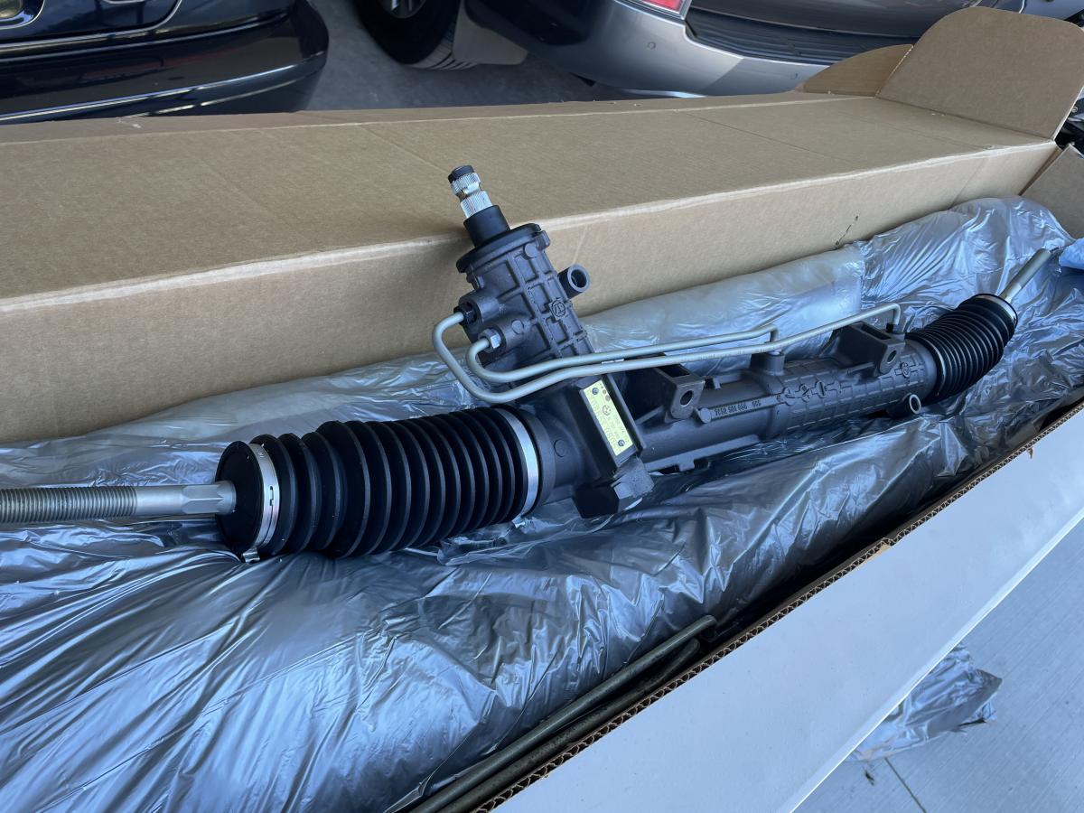

                                Decided to try out a rebuilder out of Michigan--shlpped them the rack that I cleaned up (exterior), new seals, internal bearings, new hydro pipes, boots, (inner) tie rods (I supplied) and going in next week....
