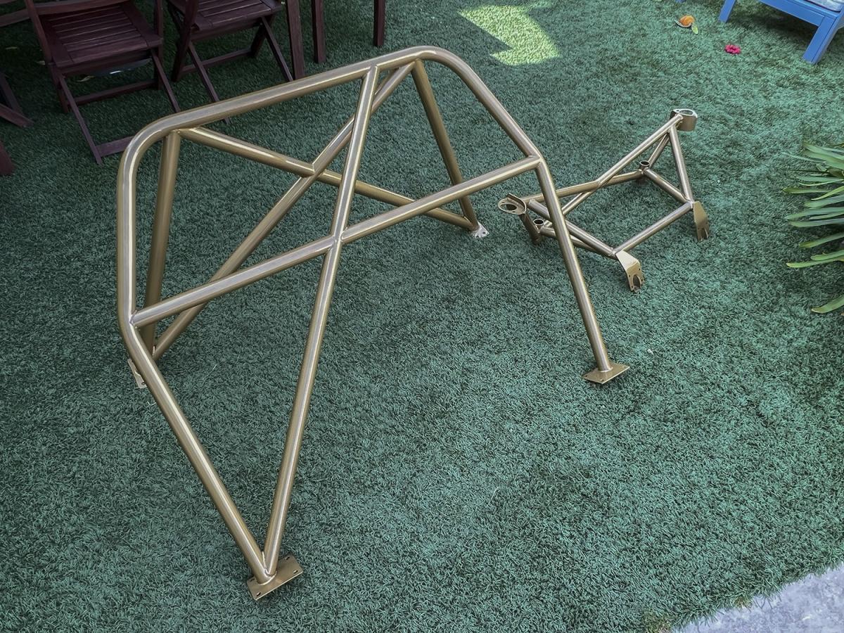

                        I also decided to go with a set of Brey Krause direct to floor seat mounts. If not having the ability to slide the seat becomes a problem, I will rethink that. But I think it should be fine. No one else will drive the car except me pretty much ever. I am considering the seat back braces as well, I feel like more than likely I will do those because it seems contradictory to do fixed seat mounts and not brace the backs as well. If I have any money left and if my wife doesn't murder me, I'll be looking at a steering wheel, boss, and shifter too.
                        I appreciate the conversation about the roll bar, I did after all, ask you to critique my life choices. I will indeed be running the bar, and like I mentioned I will also be putting pads on it. I am comfortable with that personally, and I do understand the arguments against doing the bar for a road car.
                          You'll be fine as long as you understand the potential issues. Everyone does something that has a compromise when modifying their car.
