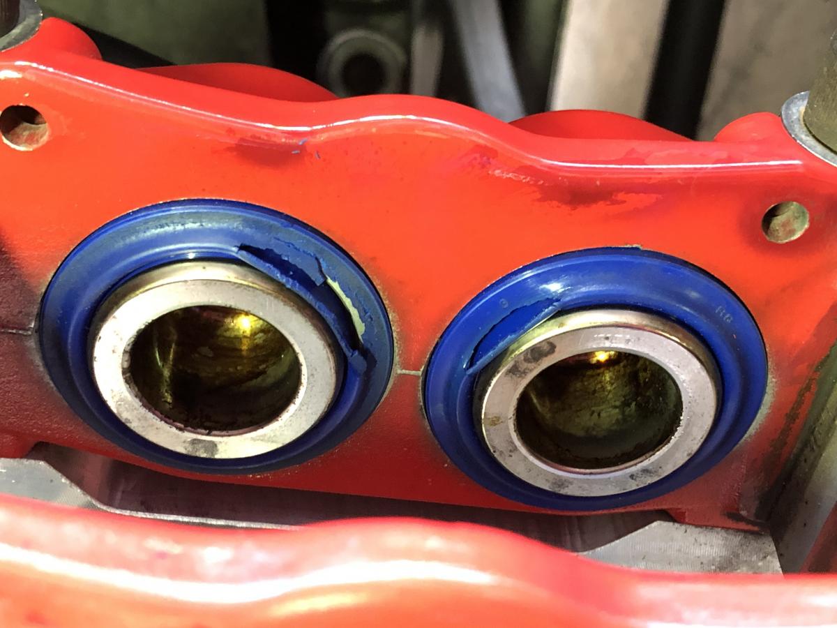

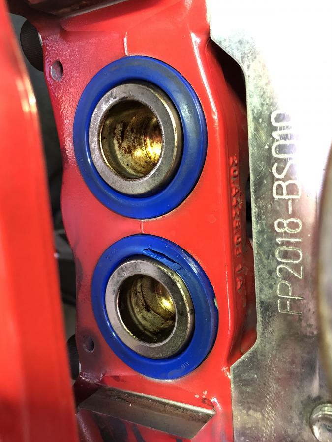

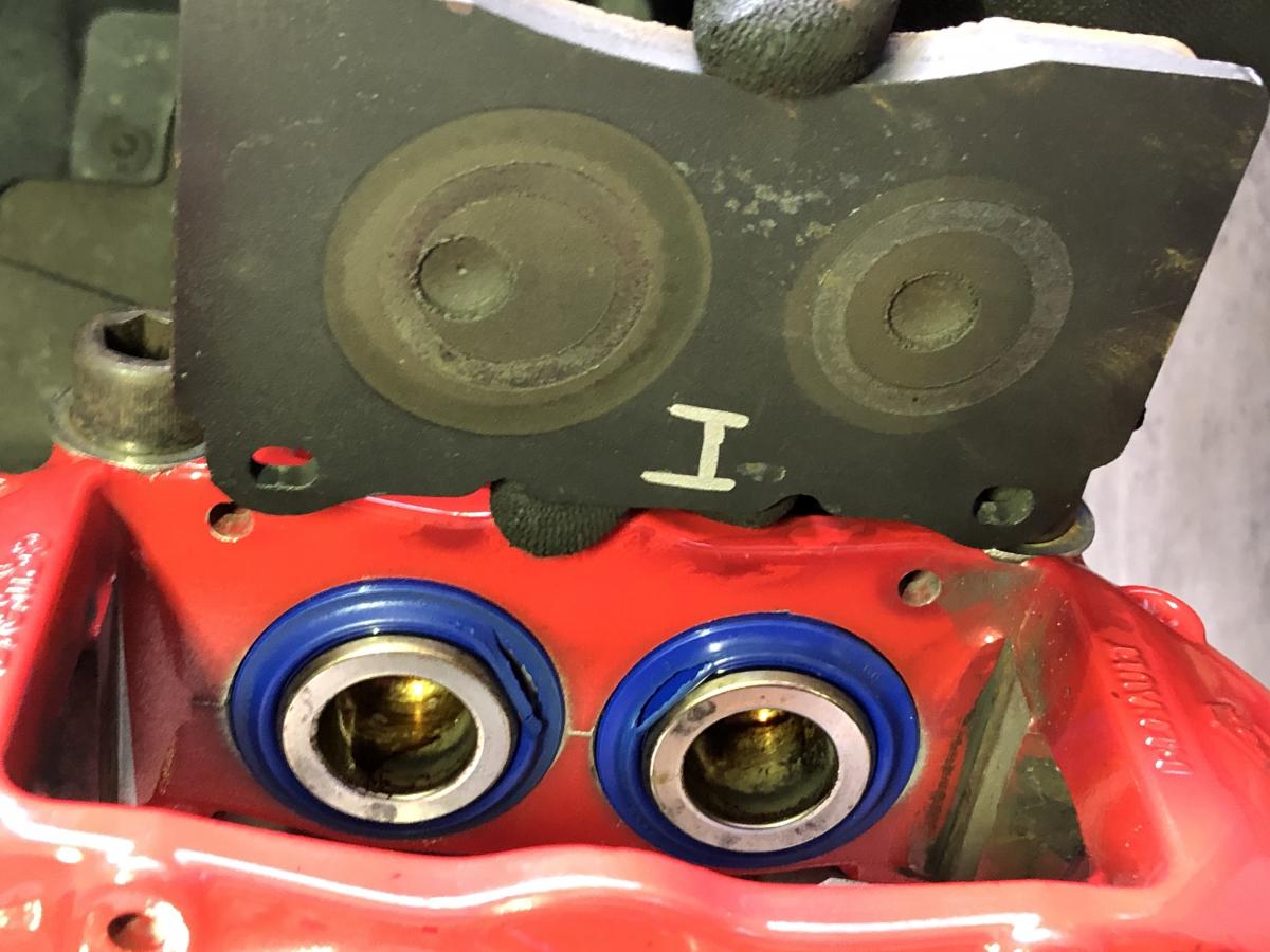

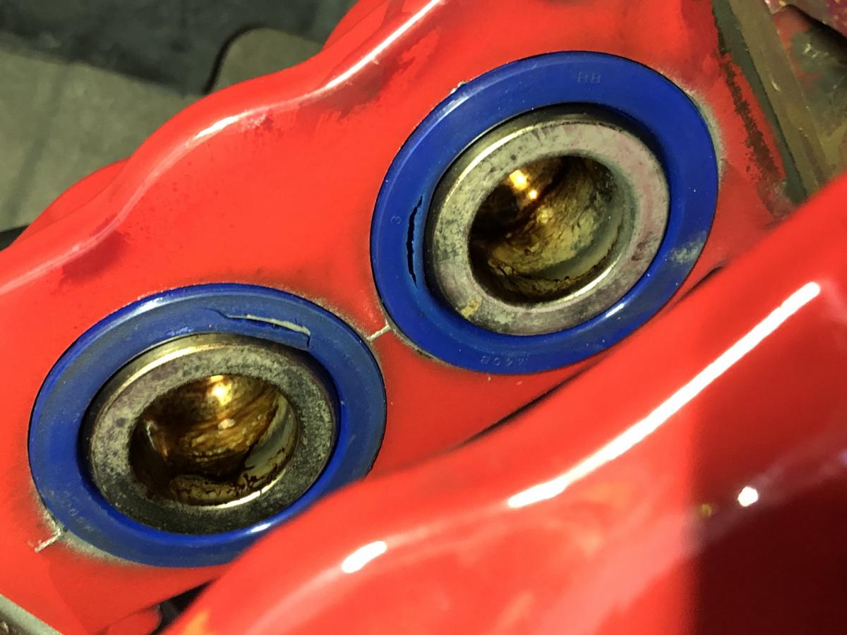

                                Im in the same boat but with Renault Megane Brembos (Freakyparts kit). Melted the stock new dustboots with 16mm GLOC pads and only slightly worn ZCP rotors, since the pistons had to be fully compressed to fit them and was only able to put Ti heatshields on outboard side. I then replaced the inboard boots (which were completely melted vs the outboards) w the RB blue high temps, and put 14.5mm PFC pads and new Girodisc rotors (no heatshields this time). While better, 3 of the 4 RB high temps had developed cracks next track day… I mean it’s def from direct contact to the pad backing plates but still frustrating that even w a ‘thinner’ pad thickness they still touch n cook. I then installed new RB blues boots for the outboards along with the Ti heatshields both sides hoping now they will survive without cracking next track day, but I’ll have to replace the already cracked inboards again. This will get tiresome and expensive if I have to keep replacing dustboots after every track event.
                                mrgizmo04 I was actually thinking the opposite, that as the pads for wear down in thickness with use maybe the dust boots will survive since won’t (shouldn’t) be touching the backing plates directly as much lol.
