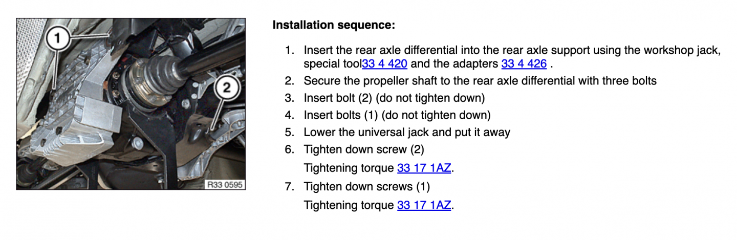

      Yes, here's the repair manual instructions:

        Wish I had know about the Nord-lock when I did mine.
        And, as Heinz points out, the upper diff bolts get torqued last. This is when I discovered I could not get my torque wrench and e-torx socket in between the body and the diff mount....

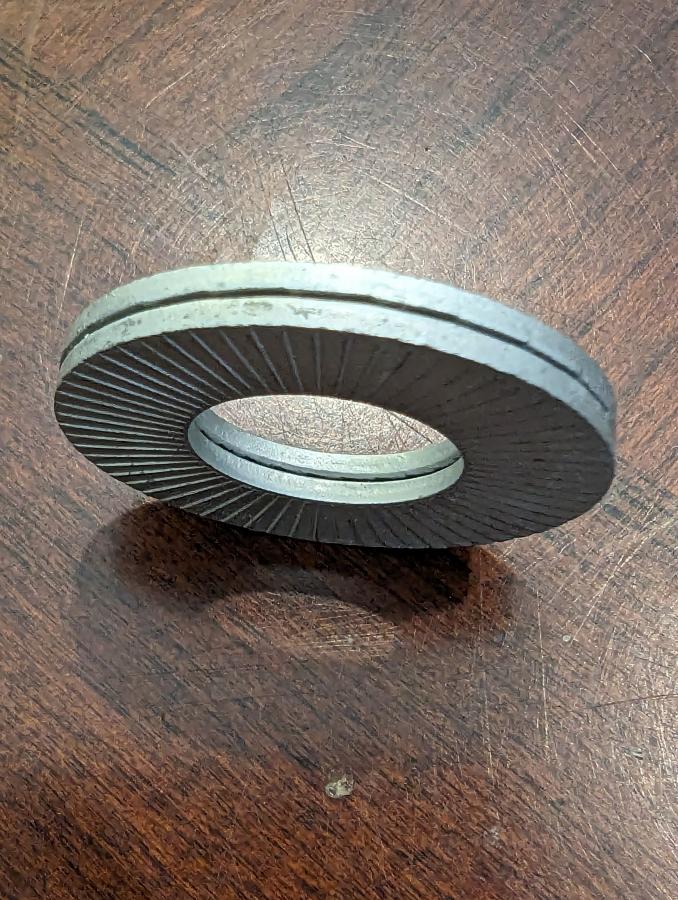

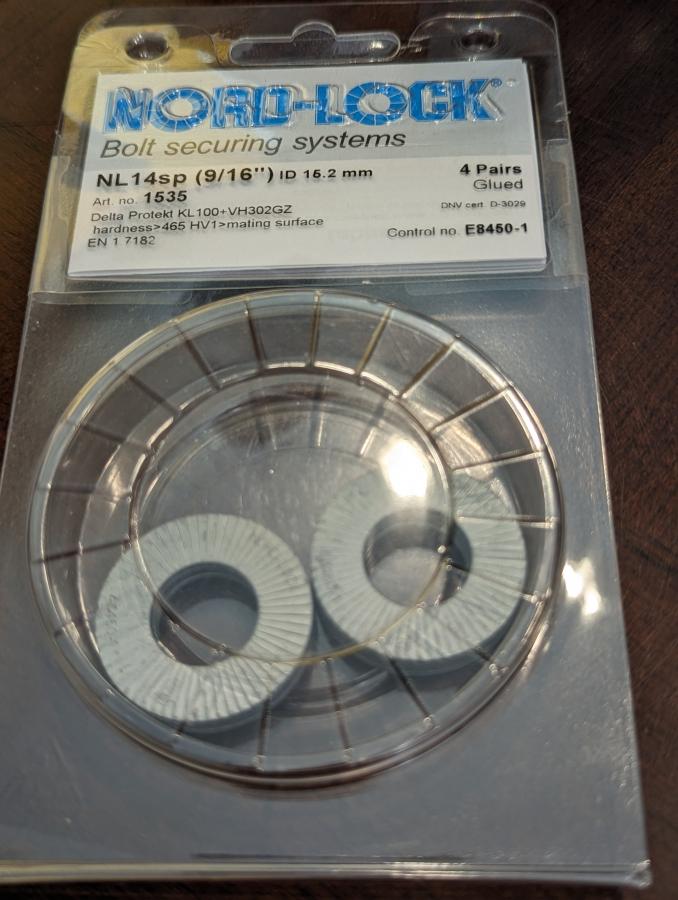

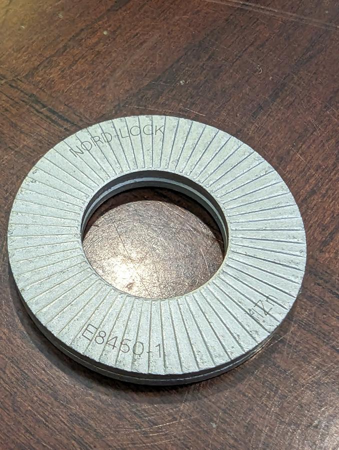

            Received the Nordlock. Photos for reference.

                that is much thicker than i would have imagined

                    I got nordlocks 1534, thickness is same 3.4mm, but I didn't opt for extended outer diameter, you don't really benefit, since head of the bolt is not that large. Just remember to grind off the washer that comes on the stock bolt.
                      They're a two part assembly that come attached together with what looks like hot glue. Once installed they get a bit slimmer, but they're probably still 2x as thick as a regular washer
