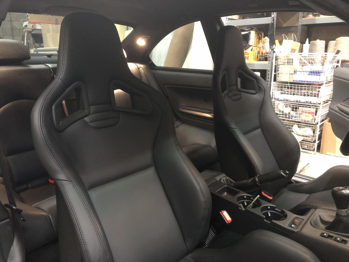

                Echoing what usdmej is saying above - Sportster CS' have superior comfort especially on long drives in my experience.
                For context, my car came with manual seats. I had chronic butt/lower back pain due to too much lumbar support (had a couple 3-4 hour drives).
                When I upgraded to Sportster CS in 2021, I made 4x trips which were reach well over 4.5 hour drives each way (so 8x 4.5-5.5 hour sessions in the Sportster CS). Zero lower back or butt pain. To be honest I wasn't expecting them to be so comfortable on long drives.
                Haven't shared any pictures but just for shits and giggles - got custom ones upholstered from AMX. Highly recommend AMX and hope to use them again for future custom Recaros. First pics were the ones they took before they shipped them from Germany, second one is after I installed them. My E46 M3 is my only car - I use these seats for DD duty:
                  Really great to hear that you like them so much. Curious if you had AMX integrate the heated seat option that work with OEM console controls.
                  Also, which mounts did you end up using?
                    #69
                    Used BK mounts with OEM sliders - I'm shorter so I wanted to sit a bit higher (common reviews say Recaro sliders sit low).
                    I never use heated seats - my car is garaged and SF doesn't get too cold. I had them install OEM seat sensors and omit the heated seats.
                    Also fixed the previous post since the images were broken!

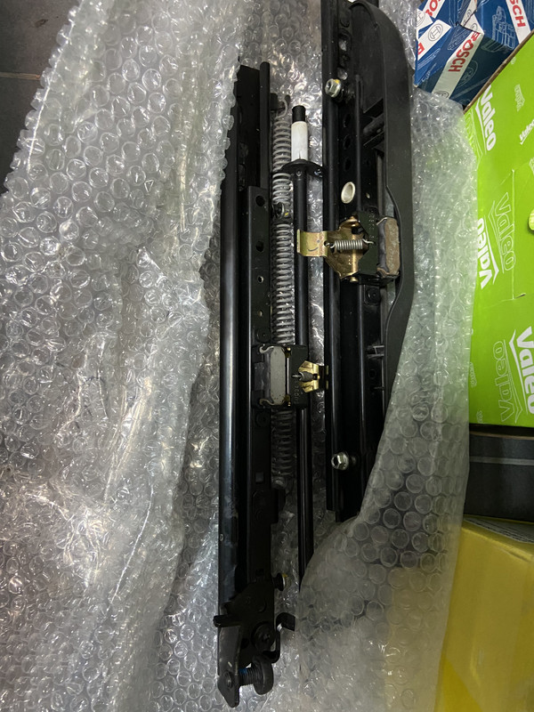

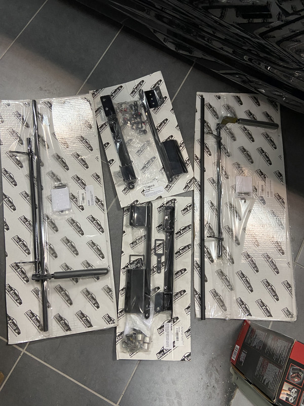

                      #70
                      Thanks usdmej & BBB!!
                      I also bought BK mounts with OEM sliders from manual non M E46 and want to fit them when i have some free time.

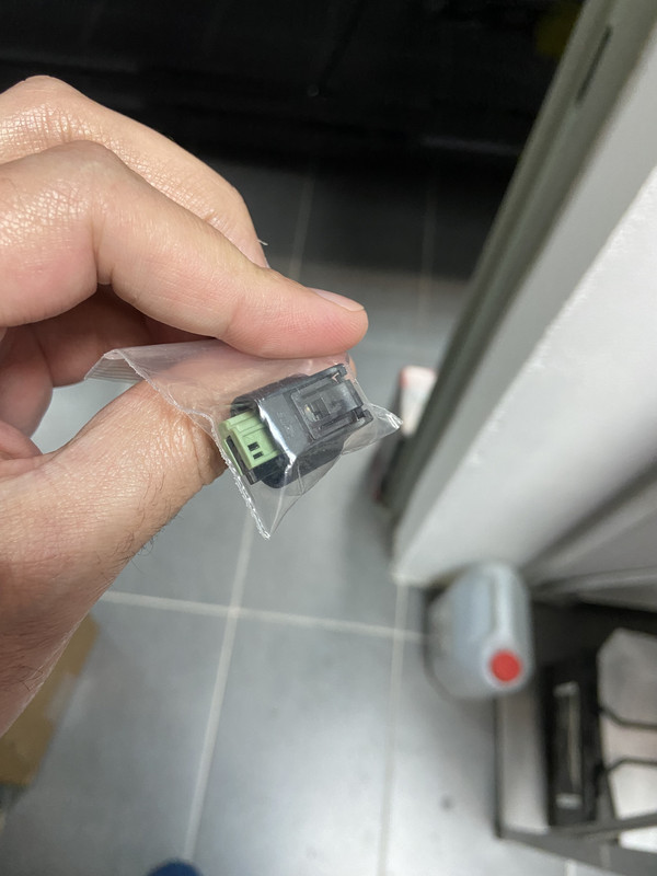

                          Why is that connector? OEM controls for heated seats? Occupancy sensor?
                            #73
                            Nice! Please report back with your thoughts on this setup. I’m planning to use the BK mounts as well.
                            Thanks.
                            I will.
                            Yes it’s occupancy sensor until I code the airbag.
                            I don’t have heated seats.

                              I did find that my kit was missing 8x bolts that were required to bolt the BK mounts to the OEM Sliders. Additionally, since I bought my Sportsters from a custom upholsterer, the main "triple square torx" bolt that attaches at the hinge point for the seat back/seat bottoms for my CSs was not the same size (one of them was not a "riple square torx). So my recommendations are
                              1. Double check the hinge torx/bolts for both seats first (2x/seat so 4x total) before complete assembly. Be sure you have the correct socket head/tool in case you need to detach/reattach (my seat came completely disassembled). Looks like you should be okay, but would be helpful to know if you wanted to eventually add the passenger occupancy seat pad to the seat.
                              2. Mock up 1) the OEM sliders to 2) the BK seat mounts and count your bolts to make sure you have enough. They do provide the correct sized bolt, so you can bring that one to the store to double check the thread size.
                              Other than that, take your time! It may help to have an extra set of hands for one part of the reassembly.
